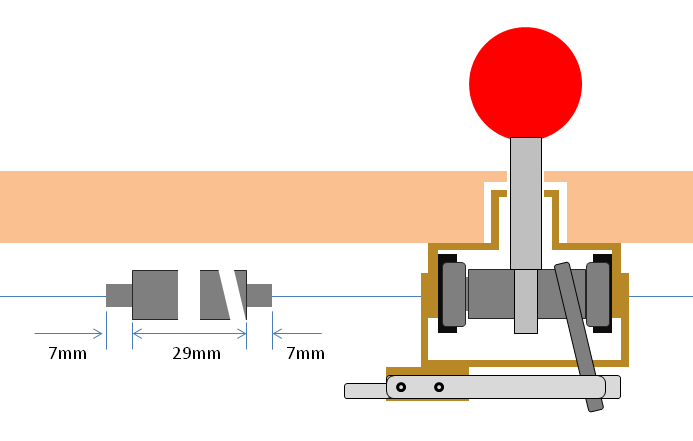

    This part is a joystick crossmember (for the 1980s classic Defender).
    Stainless steel (maybe aluminium if that's all I can get done).
    1/2" square or 1/2" AF hexagon (your choice, I can supply it)
    The spigots are approx 6mm for a sliding fit with a 6x17x7 bearing (I can send you sample)
    The angled hole is to suit a 4mm roll pin (I can send you a sample).
    I might want a variety of main hole diameters eg 5.7mm to 6.4mm (to allow a decent fit of various worn handles)
    alternatively a single hole size and advice on how to open it out.
    I'll want a first off, and then a batch of about 50.
    I might be able to change the roll pin hole to perpendicular if that makes a difference to whether the job gets done.
    Any advice (materials, methods, design, other forums to ask) also appreciated.
