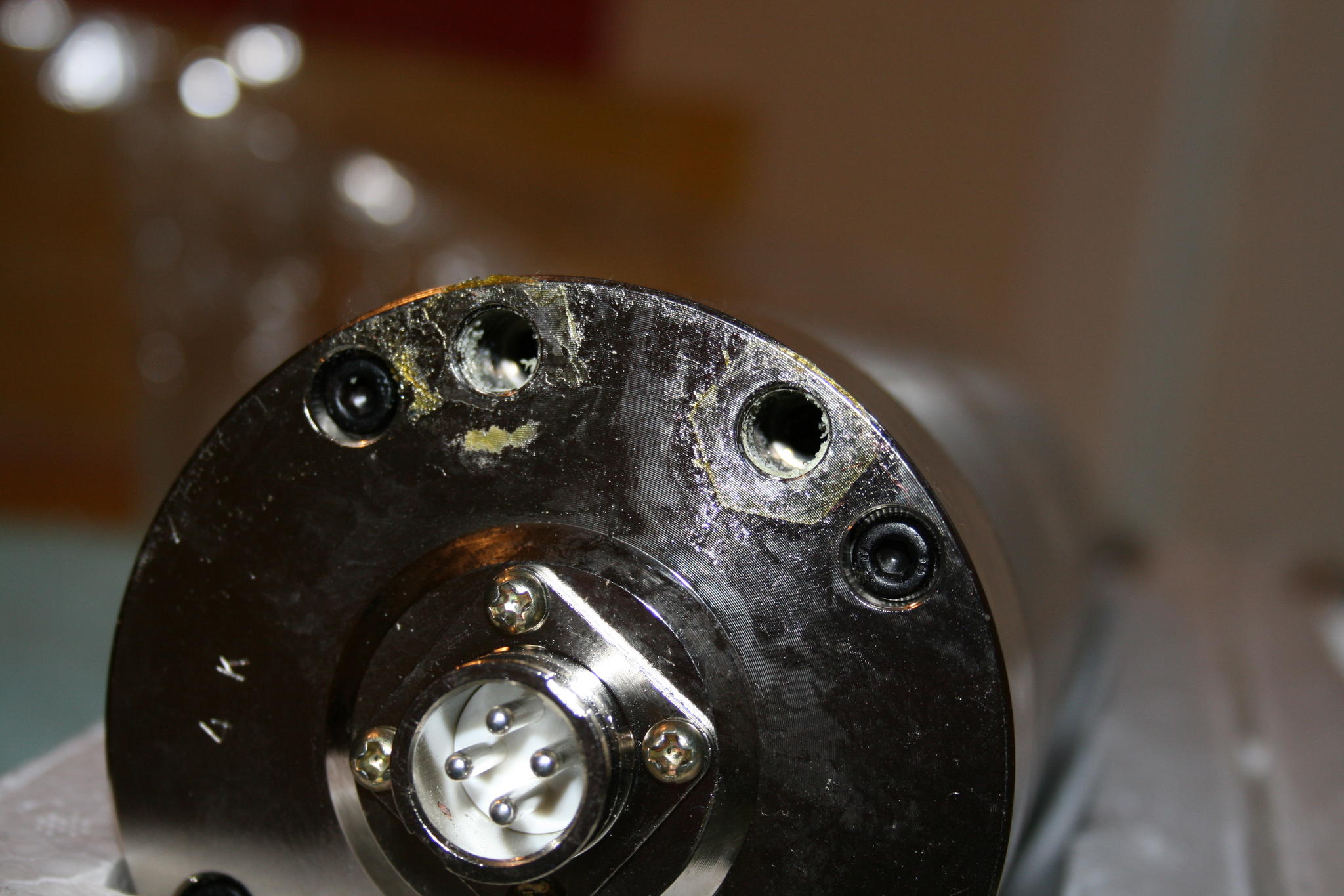

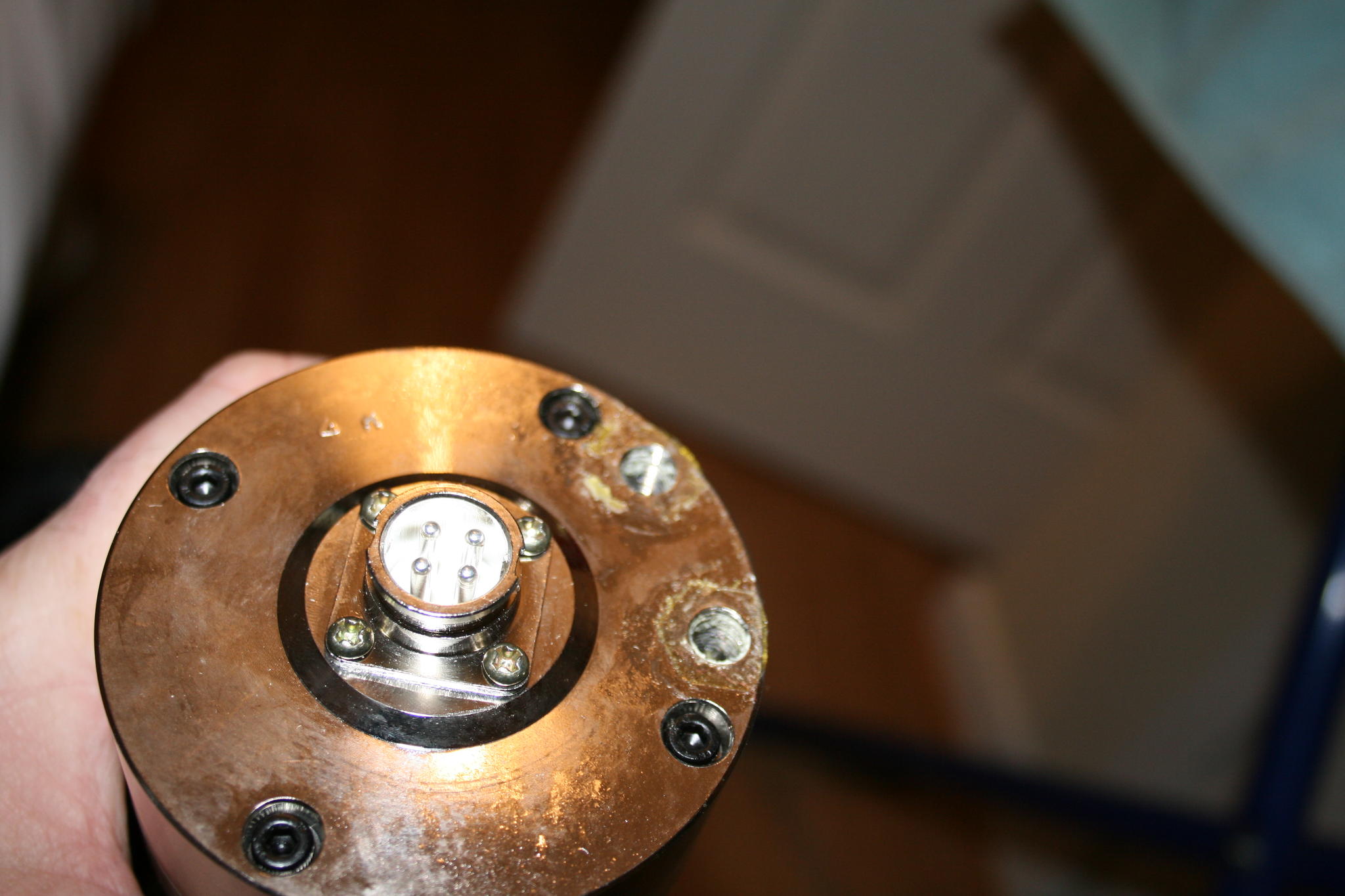

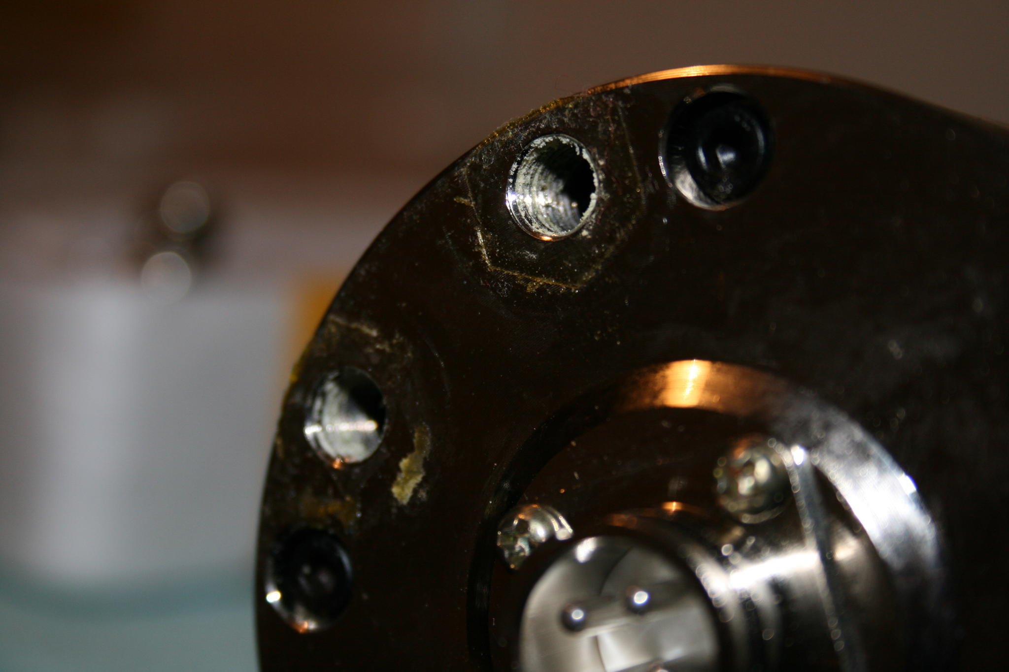

    my Chinese spindle and vfd arrived today from Portsmouth.the coolant ports as can be seen had fittings previously fitted . i don't know if this is standard practice ( as in testing) or it's second hand spindle and passed on as new. if any one has a previous experience of this i would like to know before i go and contact the seller.
    the VFD appears to be new and doesn't have any sings of previous use. Then again what do i know!! i had a read of
    http://www.mycncuk.com/threads/5814-...HINESE+SPINDLE to try and get to grips with the set up procedure . i'm curious to know if the settings listed in a post by Shinobiwan ( post 6) are still applicable . they are 2 years old but would save some unnecessary manual reading.

    Yes this is normal for them to be taken out after testing. They used to leave them in and they often got snapped off in transit, ive had many come like this. If the body was scratched then I'd be suspicous.
    The settings Ant (shinobiwan) posted are still the same I believe.
  10. #116
    cheers Jazz , I didn't fancy getting into a paper trail with the supplier. the body looks fine , no evidence of a mounting bracket. i had a read of the manual and to be honest it would take another good couple of reads to filter out the stuff when compared to Ants post. i'll still need to go over it once i hook up the bob with spindle control. but at least i have enough info to get me testing the vfd with the spindle. thanks again.

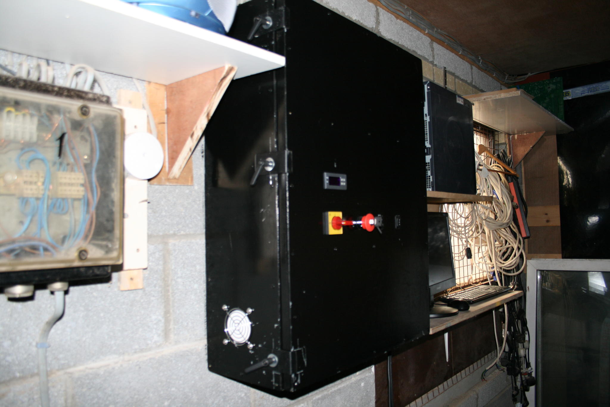

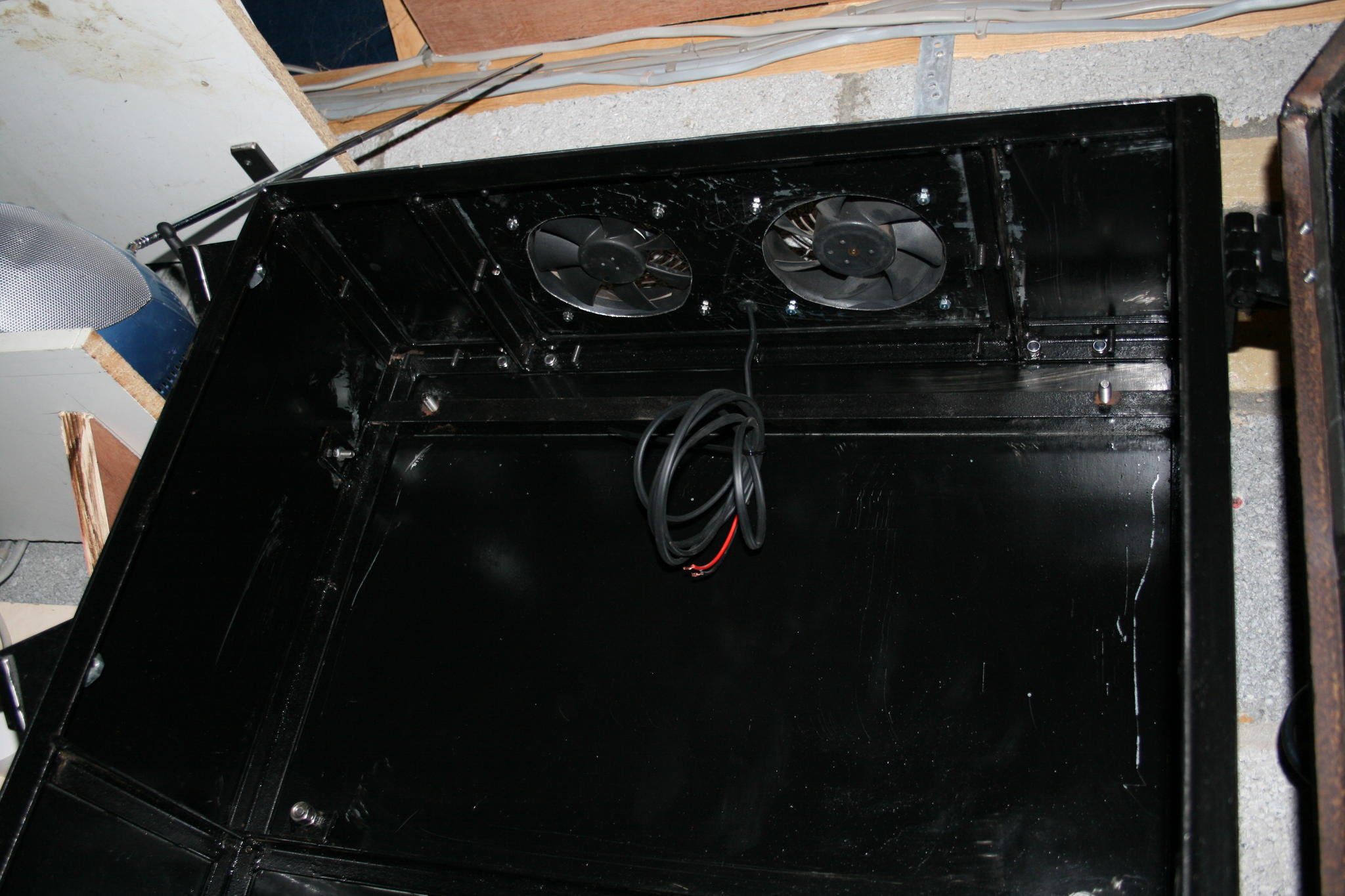

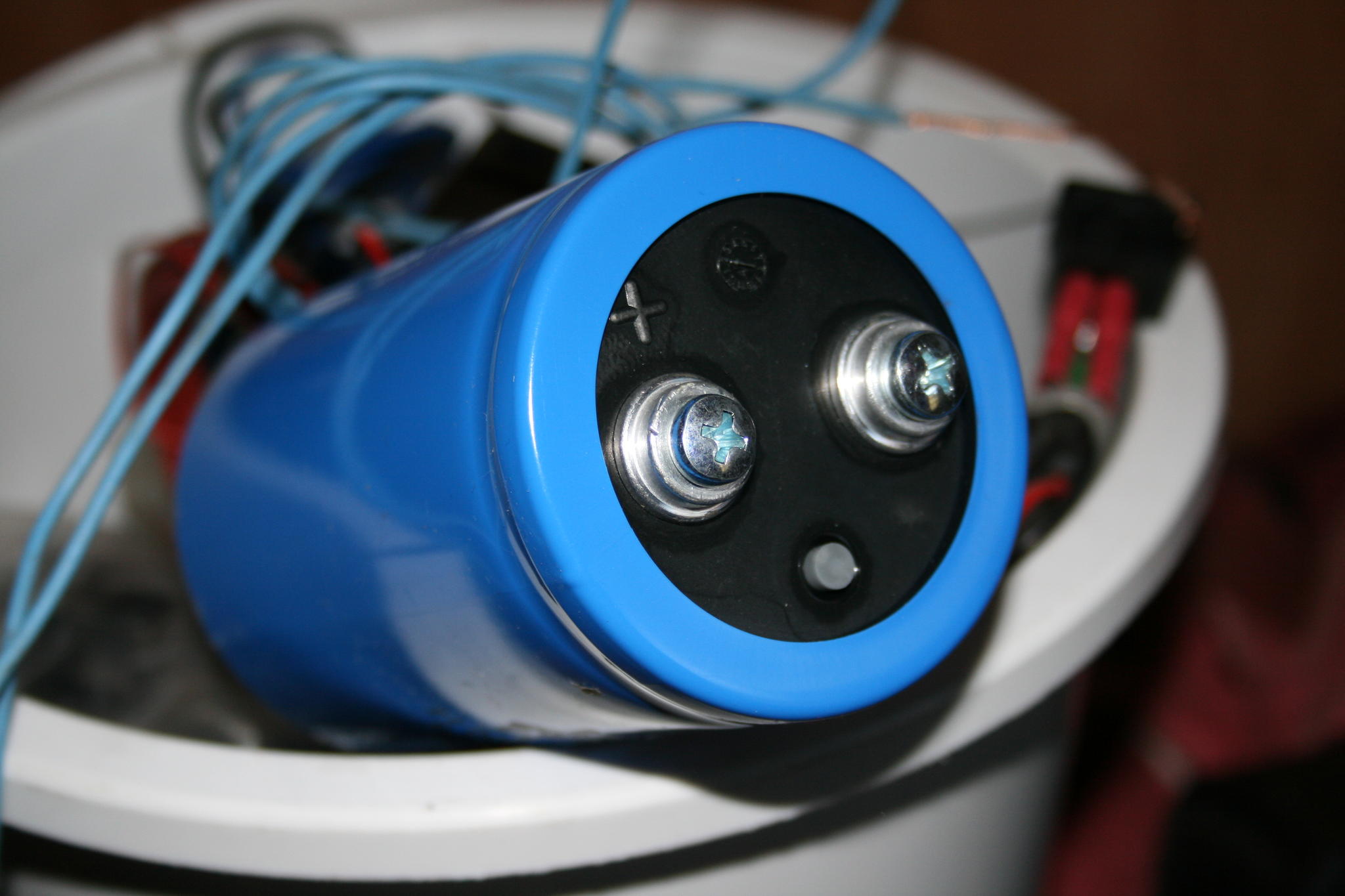

    my capacitor has a button on top . i couldn't find any info about it .maybe someone here might know.......... i fitted some of the switches ,and a temp control ( cheers Eddie). on the door of the panel and put some crude shelves up for the P.C. I had the fans fitted sucking air out on top .with vents to draw air in at the sides. i then came across a post so i think i'll be changing it about.http://www.mycncuk.com/threads/7831-...SURE+ENCLOSUREi got this in the post ( cheers again Eddie) so the power supply is next to be tackled . so if i mount the coil on a plate and the plate is earthed , will that not in turn earth the bolt holding the coil? will that be enough or will i have to earth the bolt also?
