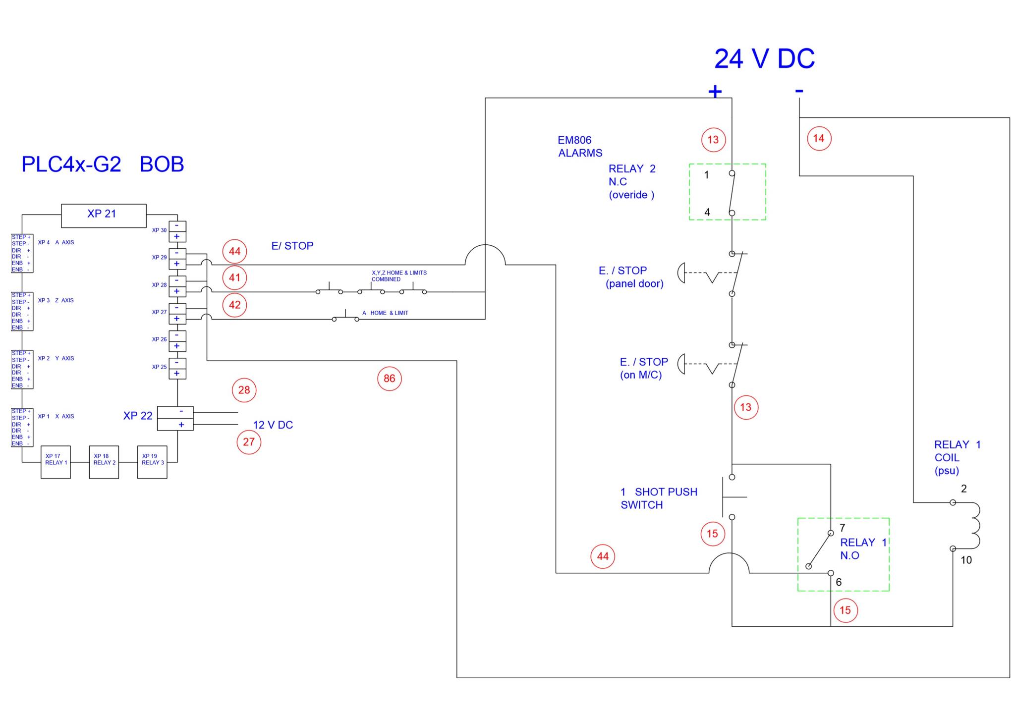

    i have the plug in for motion control loaded and the bob powered up with an e/stop signal (n/c) . i have set the pin no. for e/stop in port and pins set to 10 , port 1 but still can't get Mach 3 to reset. i keep getting '' External Estop Triggered'' the hardwiring for the estop is as follows.
    any help would be welcome

    i have the plug in loaded and the bob powered up . the e/stop pin set to 10 , port 1 but i cannot reset Mach3 . i get the message'' External E/stop triggered. the e/stop is wired normally closed as per dwgany help would be welcome.

    Set pin 10 to active low (green tick) then it will work.

    cheers Jazz, i watched the first video on the Mach 3 website and got mislead , again!!! the green tick( active low) did the trick o.k. i need to give the tutorials another glance again to see if i can get the motors to turn!!!
