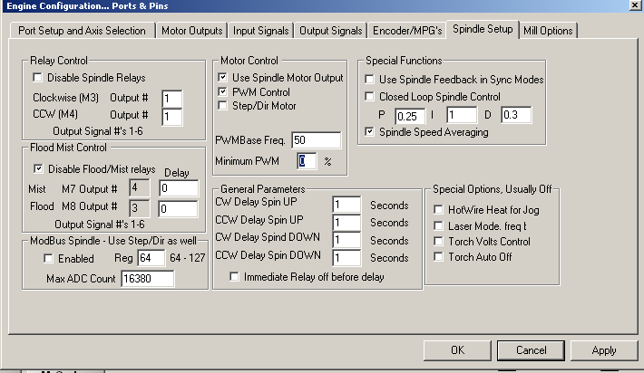

    i'm in a spot of bother with the mach3 spindle control. i have wire the BOBto VFD as follows,i have set up the various ports, pins ,outputs as follows, when i turn on m/c the spindle starts up and i can't turn it off until i do a reset from mach3. i can then go to the output signals tab and turn on active low for output 16 and the spindle will turn on. i can toggle it on and off from this tab. i have tried to set the various related ports and pins, on/off, but i still get no joy. any help would, at this stage be appreciated

    well , i have at least got the spindle running and stopping (the correct way)) from the reset button in mach 3. i emailed Gary @ ZAPP and apparently i need to wire in 10 v from the VFD to the BOB. i'll give it a go.
  10. #228
    Do the relays have NO & NC contacts and you have wired to the NC contact.? This cause spindle to start when Mach is reset because the Enable will activate the outputs and because you have wired to NC the circuit is made straight away.!
  12. #229
    i changed that and now it works correctly but the moment i take mach out of reset the spindle starts and i cannot turn it off . the spindle CW F5 button has no effect and i can only turn it off by putting mach into reset. i cannot adjust the speed also ii appears to run at top speed.
  13. #230
    Quote Originally Posted by PAULRO View Post
    No using Reset is not the correct way to start/Stop spindle.
    I also think Gary as got this wrong. The 0-10V signal is generated by the BOB you don't need the 10V from VFD.
    I'm a little busy at minute but I will look at this for you later.
