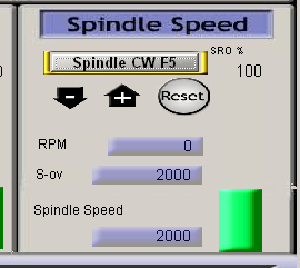

    i 'm having no success with the spinde control from Mach 3 . i think i have all the settings correct . i have looked online for a basic run down of the set up because i'm a complete novice but cannot find a suitable '' VFD to MACH 3 '' for dummies!! if i could at least get my basic understanding of how the various bits communicate and interact i might be in a position to fault find further , so i'm going to list my understanding of how i think it all interacts and hopefully if i am wrong or have left any thing out i can be put straight...........
    1 ... change PD001 from 0 to 1... on VFD
    SPEED CONTROL
    2...connect GND from XP24(PWM on BOB) to ACM GND on VFD
    3... connect FIV from XP24( PWM on BOB) to VI on VFD
    4... connect +10v from XP24 to +10v on VFD.
    the 10 v signal is from VFD to BOB for speed control. (courtesy of Jazz)
    START /STOP
    5... relay on BOB ( COMMON TERMINAL) to DCM on VFD
    6... relay , BOB ( N.O. ) to FOR on VFD
    MACH 3 OUTPUTS
    i had 3 outputs left from 12 on the XP21 ( LPT PORT) pinout
    I used pin 14 for the PWM (output 1) and pin 16 for RELAY 1 ( output 2)

    here is my spindle set up

    output signals set up ,
    ouput 1 = port 1, pin 14 , active high
    output 2=port 1 , pin 16 , active high.
    ( if i toggle the active high to active low on this output, the spindle comes on .
    my motor ouputs tab is a stumbling bolck for me , should i enable the spindle ?
    i have it enabled on this tab , step pin 14, i don't know what DIR PIN to use because i have only 1 output pin ( 17) left and that's a relay .
    is this my problem . thanks in advance
  9. #7
    I've just been chastised on the phone by Clive S for letting my level of response drop to a below an acceptable level. . . . . . . Very sorry.!!
    Give me 20 mins and I'll try to make sense of what's happening or not happening and suggest a few things.
    Tell me whats happening or not happening as of now.? Does the spindle start/stop when you push spindle CW (F5) button.?
