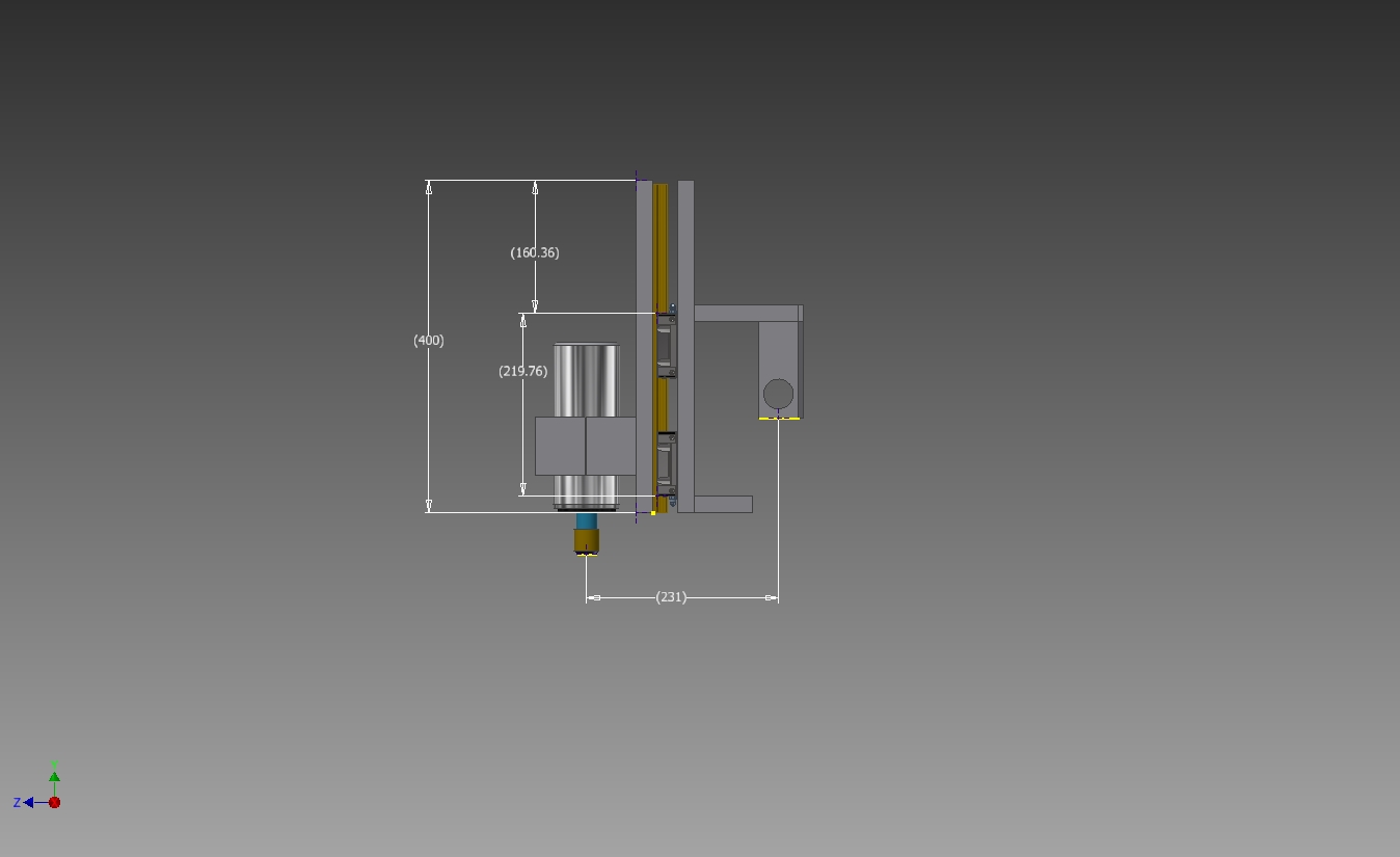

    this is my z axis end view, it has 20 mm rails and a travel of 160 mm. i'm thinking of a z axis ballscrew length of 400+ 30 for for a timing pulley. i'm sure this is enough or should i go more?
    If the backplate is 400mm same as the spindle mounting plate you will likely want the outside faces of the bearing blocks to be 400mm apart so they are flush top and bottom, this will allow the maximum travel.
    So the BK bearing is 25mm thick (excluding the end cap and locknut) the BF is 20mm thick, so that gives a ball screw length of 355mm between shoulders. Then 12mm turned section on the BF end, 69mm on the BK end (E+F = 39+30). Total length = 436mm. You have to allow for the Z ball nut thickness , this will reduce the overall travel, I drew mine out using Sketchup to make sure I was getting the expected travel.
    Also you might as well get the ball screw as long as possible because the price difference for a few mm is going to negligible.

    Cheers Eddy, how long was the delay from Chai ? also did you get the ballscrews machined locally or by chai and if so would you recommend it? i might get it done locally because i have access to a lathe but if it's not too costly to get it done by Chai i might go that route but then i have read that some of the screws turn up slightly bent. i have used suppliers from china in a previous life ( job) and remember some of the parts delivered with poor packaging and very little protection ( not all suppliers ). it's very helpful to have the experience of previous builders who have gone down this route, hence all the questions!!!
  7. #5
    I think it took 18 days from payment to delivery. The machining was fine, exact dimensions, good fit to bearings, far cheaper than anywhere else. Holding the ball screws in a lathe is not as simple as a bit of round bar plus they are very hard on the outer skin.
    The parts looked okay until I fitted them whereupon I noticed some bending. I decided to straighten them myself and it appears to have worked well enough, it's all in my build log.

    Quote Originally Posted by PAULRO View Post
    Why is the rear plate so long.? you only need the rear plate long enough to fit bearings onto and give travel required. If your only wanting 160mm of movement then you would get away with shorter back plate and ballscrew.
    Also one thing to take into account if your trying to get every last bit of travel out of screw is to allow for the bolt heads holding ballnut, you can easily loose 10mm depending on how tight you make it.
    Regards the Z axis screw bearings then with screw being so short you don't really need one at the bottom if you want to keep cost down and it makes setting up that bit easier.
  13. The Following User Says Thank You to JAZZCNC For This Useful Post:
  14. #10
    i had intended to use 20 mm rails on the z axis but after reading the various posts of your good self I am now going to use 15mm rails and guides to suit so i think a redesign is in order.
    the rear plate should be shorter alright i just left it long enough to house the motor with a body of 100mm long and a plate to hold it.
    i suppose the travel of the z axis could be longer but i went with that travel because of all the discussions about the length of the lever created by the extension. i suppose it's another trade off , keeping it to a minimum while having enough scope to machine to a reasonable depth. i'll get cracking at it again tomorrow, my shutters are starting to descend !
