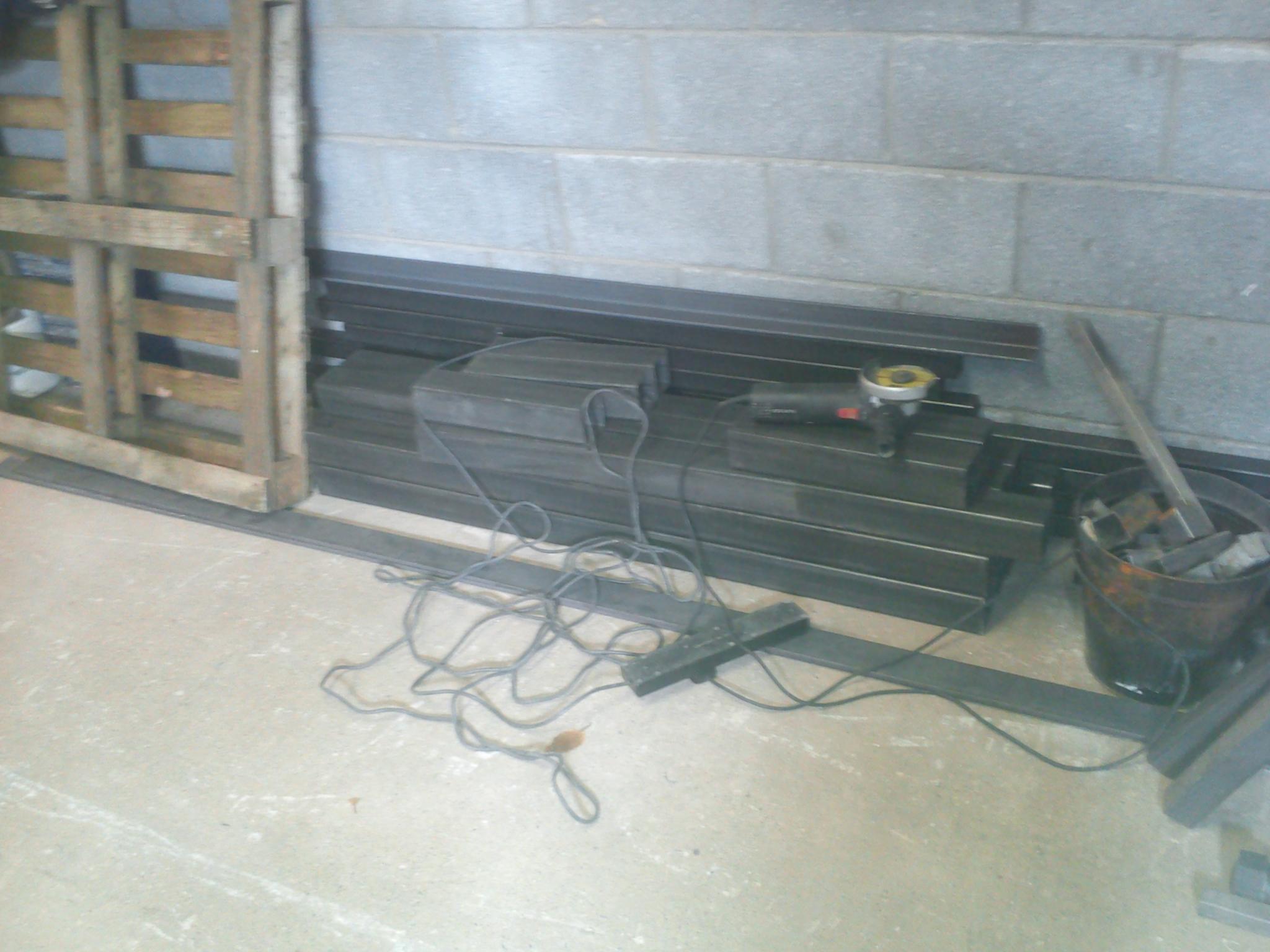

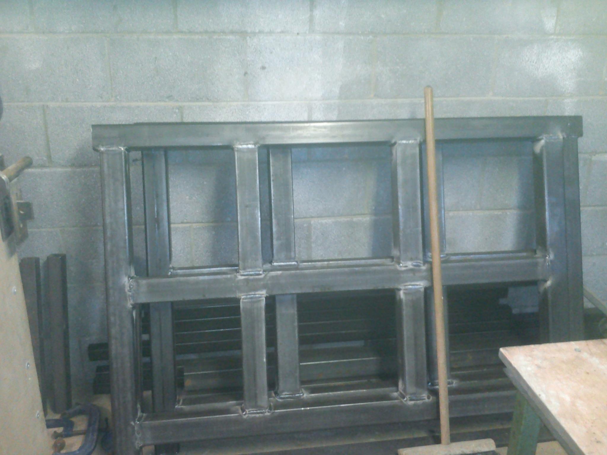

steel has arrived and is cut and both sidewalls are welded.
I have to string the crossbeams and tie both together.

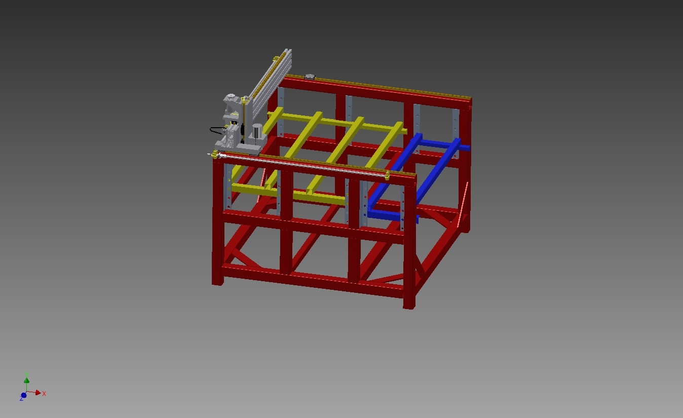

the frame is nearly finished. i have to weld in the table locators on each side and give it a lick of paint. it looks big ( it is ) but i said to myself that i may need upgradeability considering the growth of the DIY cncs over the past number of years and the bigger routers that are coming on stream.
i also welded the electric cabinet frame together, 800 x 600 x 200 deep ( just under 3 lengths of 20 x 20 angle). i have 1mm galvanize to sheet it and some hinges knocking about somewhere.
the frame and cabinet should be finished by next weekend and then i'll get a moat organised for the dreaded epoxy pour!!
