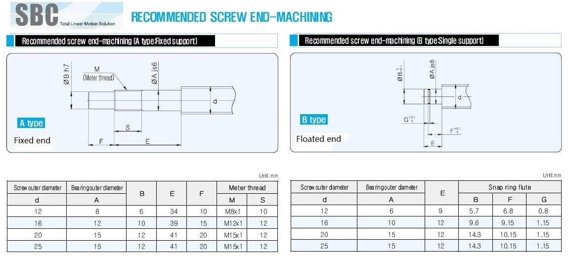

    i have touched base with chai and just need to work out the 16mm ballscrew lengths. i also notice that the bearing shaft diameters for BK and BF are different and am curious to know why this is.

    this is my z axis end view, it has 20 mm rails and a travel of 160 mm. i'm thinking of a z axis ballscrew length of 400+ 30 for for a timing pulley. i'm sure this is enough or should i go more?

    I may be wrong but the BK end will have AC type bearings and the BF end will have a radial bearing they use a larger bearing at the BK end. Not sure if they make the ac bearings in the same sizes as the radial.
    You will need to order the F measurement on the screw to be at least 30mm I think Chai standard is 15mm. ..Clive
    If the backplate is 400mm same as the spindle mounting plate you will likely want the outside faces of the bearing blocks to be 400mm apart so they are flush top and bottom, this will allow the maximum travel.
    So the BK bearing is 25mm thick (excluding the end cap and locknut) the BF is 20mm thick, so that gives a ball screw length of 355mm between shoulders. Then 12mm turned section on the BF end, 69mm on the BK end (E+F = 39+30). Total length = 436mm. You have to allow for the Z ball nut thickness , this will reduce the overall travel, I drew mine out using Sketchup to make sure I was getting the expected travel.
    Also you might as well get the ball screw as long as possible because the price difference for a few mm is going to negligible.
