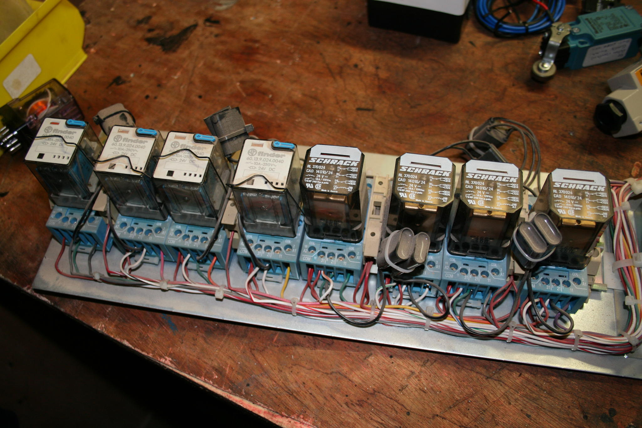

more bits gathered down the years. i hope to use most of these also.
