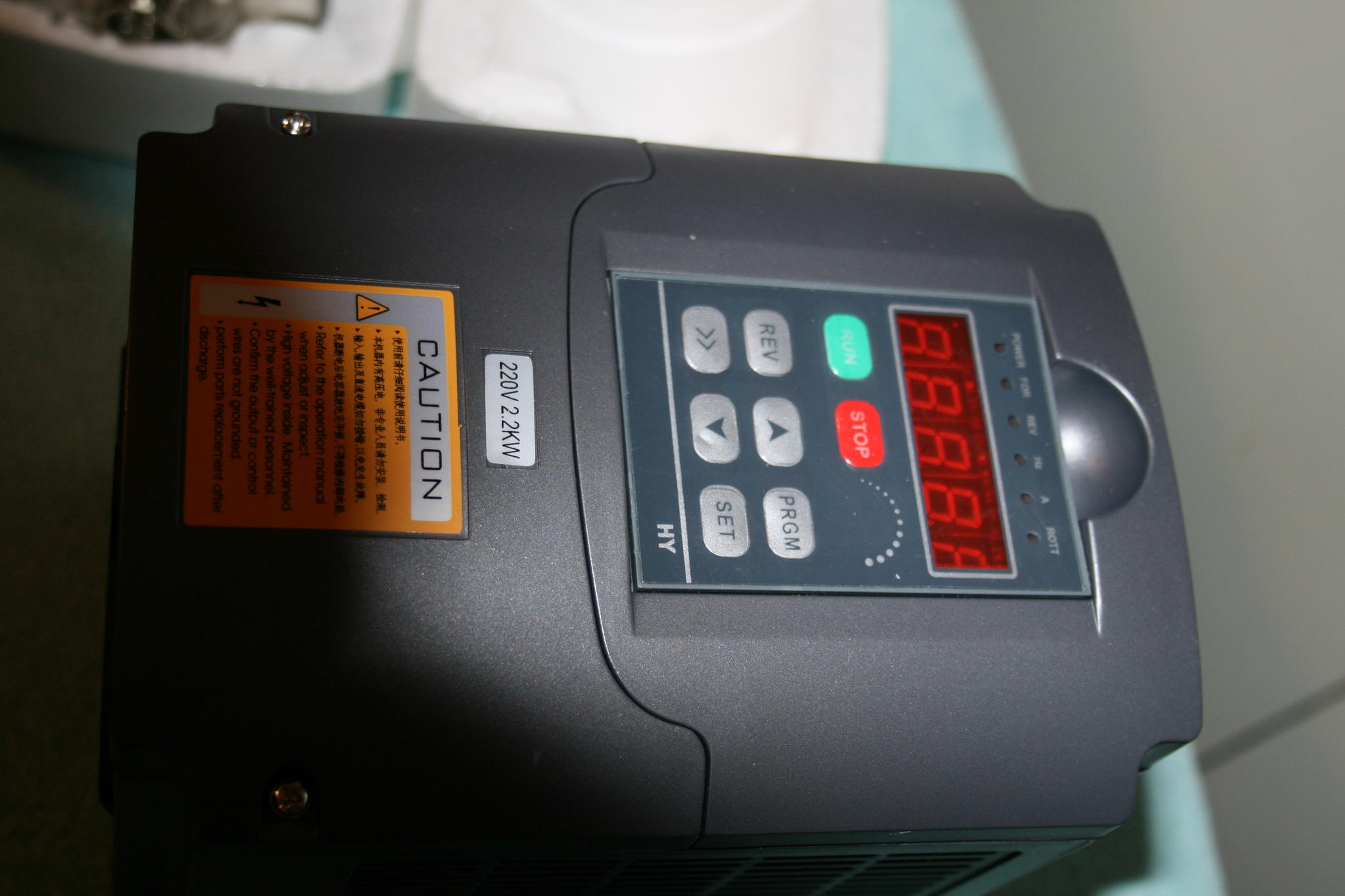

    my Chinese spindle and vfd arrived today from Portsmouth.the coolant ports as can be seen had fittings previously fitted . i don't know if this is standard practice ( as in testing) or it's second hand spindle and passed on as new. if any one has a previous experience of this i would like to know before i go and contact the seller.
    the VFD appears to be new and doesn't have any sings of previous use. Then again what do i know!! i had a read of
    http://www.mycncuk.com/threads/5814-...HINESE+SPINDLE to try and get to grips with the set up procedure . i'm curious to know if the settings listed in a post by Shinobiwan ( post 6) are still applicable . they are 2 years old but would save some unnecessary manual reading.
