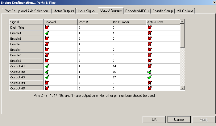

    i toggled the active state of the relays to see if mach3 could change the state of the relay from a non responsive state . i have them set back now to the folowing the run relay 1 is on constantly because of active high setting. if i input M3 the spindle will run at 250-300rpm . M5 stops the spindle again. the only relay to change state is the PWM dependant relay 3

    Paul your not listening properly because if you'd done as I suggested then the spindle wouldn't start at all. And the speed would be controlled from the VFD using what ever speed you set.
    You need to take a few steps back and deal with one problem at a time. Stop changing settings willy nilly because this makes the Job of helping so much harder. All this does is waste yours and my time by chasing false issues. I need you to only change one thing at a time then report what happens.
    First all you need to do is get Relay #1 working. Forget #2 & #3 we don't need them so you can turn them off on the BOB and disable them in Mach3.
    Straight away I see that you have the Wrong Pin number set for Relay #1. It should be Pin 16 not 14.
    Pin 14 is for the PWM Speed control which I believe is working fine just needs setting up for correct speeds which can be done later. NOT NOW.!!
    So to re cap Tell me which terminals your connecting to on the Relay.
    Set Output #1 = pin16 Active LO.
    Turn off the Enable for Outputs #2, #3.
    Next the relay will have 3 terminals which are you connecting to.?

    i have relay 1( OUTPUT 1)
    set to pin 16, active LO. ( ticked) ( all other relays disabled. )
    TERMINALS on relay
    N.O CONTACT =FOR on VFD
    COMMON= DCM on VFD

    RELAY 1 is on . i metered accross the N.O contact and common and have continuity.

    Ok well first makes sure Spindle is OFF. Type M5 in MDI. Check Continuity again.
    If still got continiuty then Change active state (NO Tick) and Check continuity again. It should drop Off. Type M3 and it should give continiuty again.
    If it does you are working correctly.
