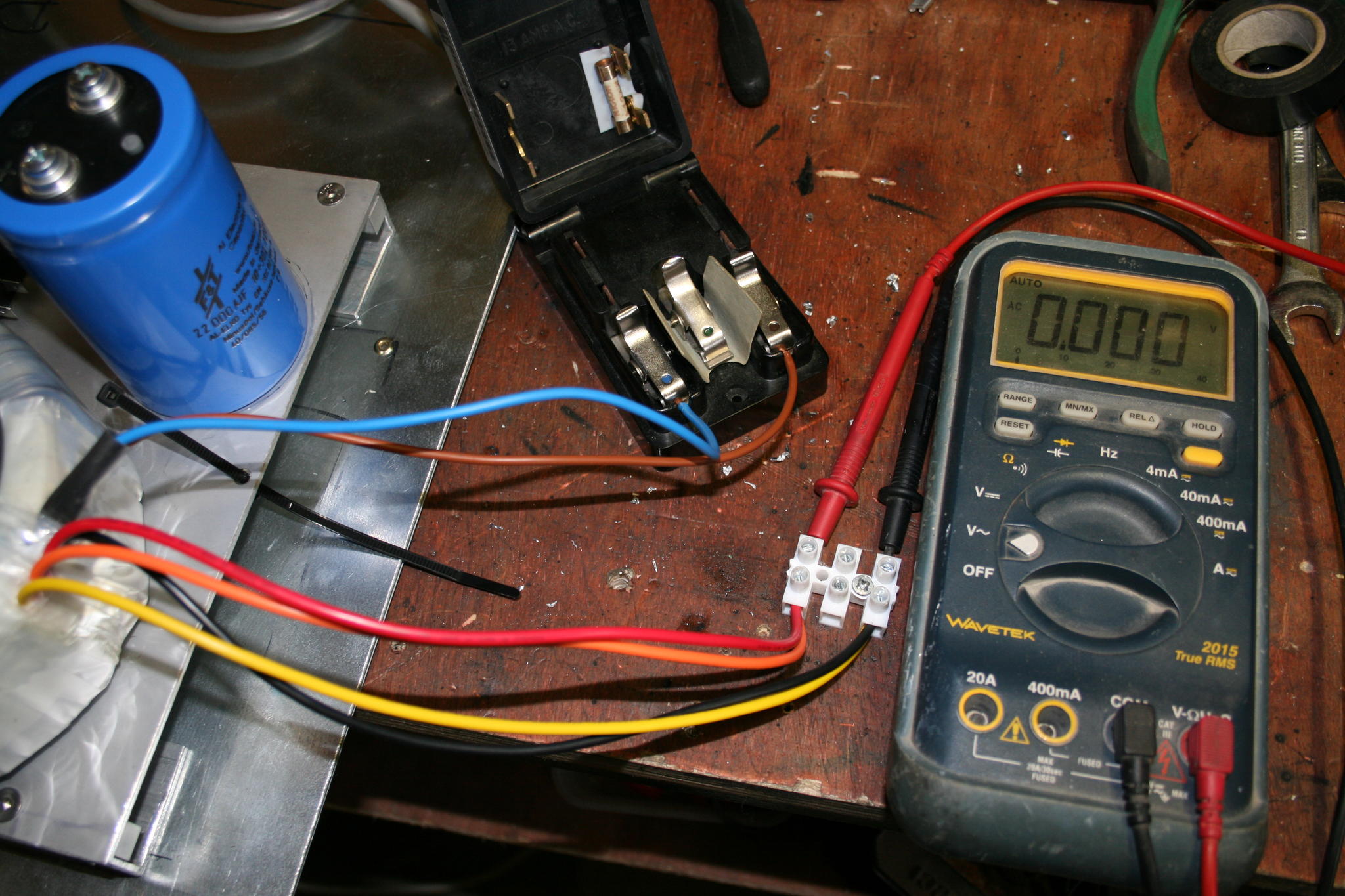

    i decided to test the coil with a power up so i used a safe block , hooked up the brown and blue to 230 vac i then joined black and yellow together and red and orange together on the secondary and put them in a terminal connector . when i engaged the safe block the coil hummed for about a second and then stopped. i checked the fuse in the safe block ( 13 amp ) and it was blown so i tried again and the same thing happened. i metered the connector and obviously got no reading . am i correct in thinking that i should not have blown the fuse and should have 50v ac across the terminals?

    Do you have a link for the coil?
    You need to connect the two sec. coils in series so join red and yellow and measure black and orange 50V It might well blow the fuse on start up with a 625w coil

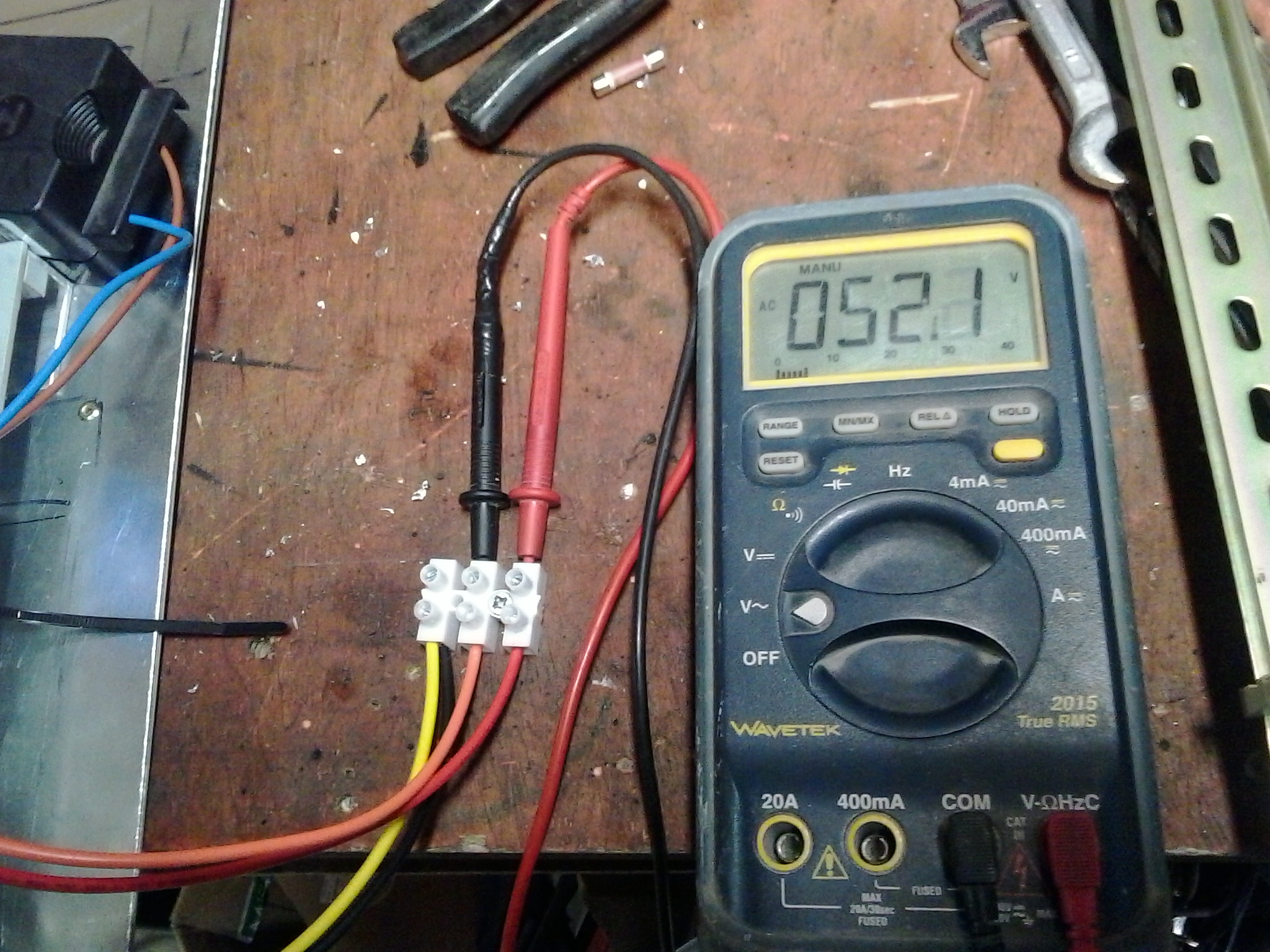

    Ok short black and yellow together and take the output from red and orange then you should see 50V You have connected them in parallel . I think the fuse is blowing because of the surge. ..Clive

    cheers Clive , 52.1 beautiful V ac.
