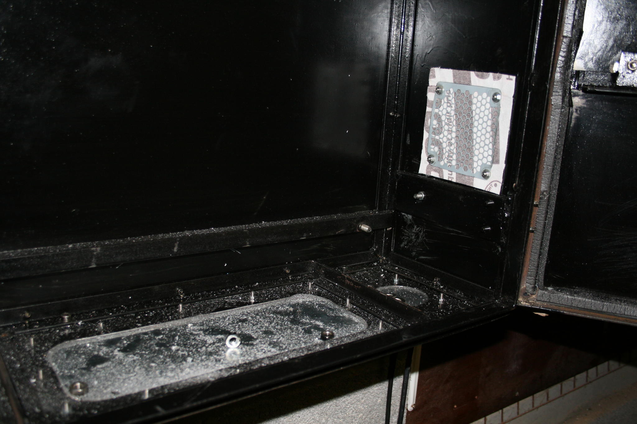

    my electronics won't be with me until monday / tuesday . i had an email stating they're in transit , i put some more bits on the back plate i had an old 5vdc power supply plug in type set a side for the motion control card . i couldn't get a din mounted supply locally and i didn't want to wait for ebay so i'll give this a try. i still have to change the fans around on the box i'll tackle that tomorrow . i hope!!!

  7. #135
    Can I make a few suggestions.!!
    I wouldn't locate the VFD and the PSU next to the BOB and Motion control card and drives. Both these are very noisey devices and they could introduce noise onto the signal wires.
    Ideally you want them furthest away from any signal devices like BOB and Drives.
    Personally i'd have PSU and VFD at top and Drives/BOB/Control at bottom with Connections/24V psu etc in between with separation.
  9. #136
    I had to put a breaker into my main board to support the extra load for this cnc and i forgot to power down my p.c. so the end result was a p.c. with a blown power supply .
    i had a spare one from another m/c but it had different connectors so i spent the morning cutting and pasting.... who needs it ? anyway i changed the panel around and put the noisy bits on top i have to put more fuse holders, terminals etc. in tomorrow.
