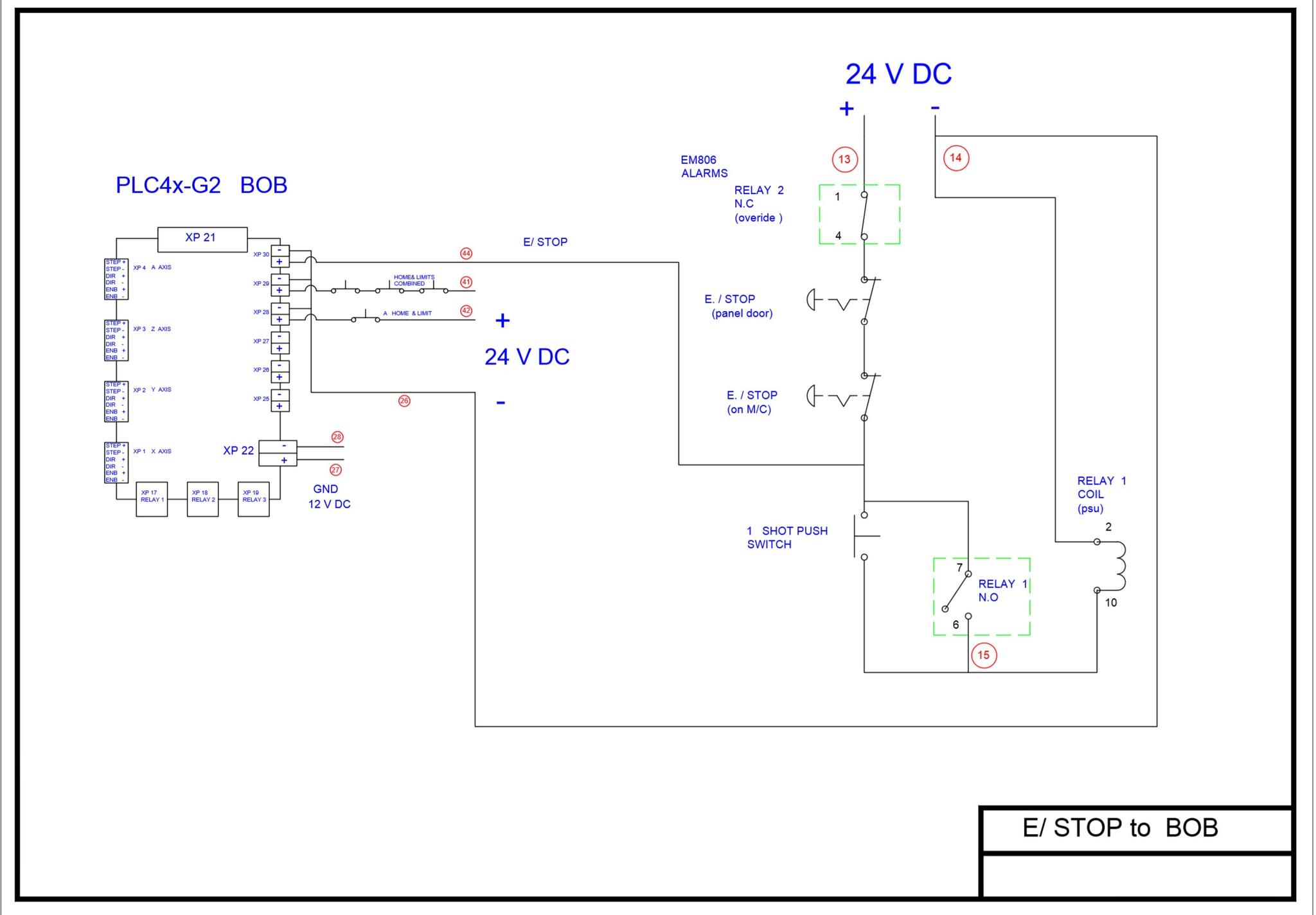

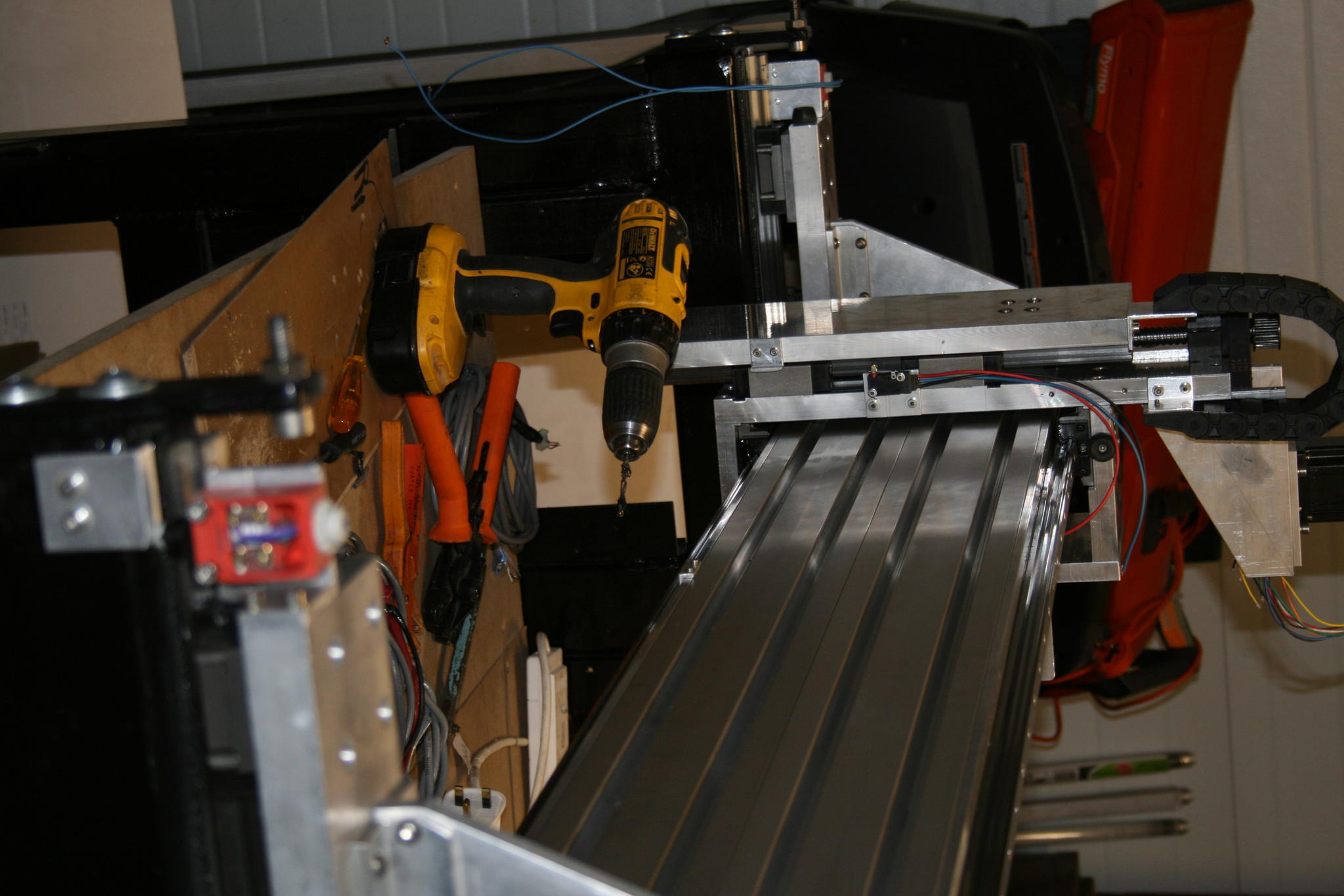

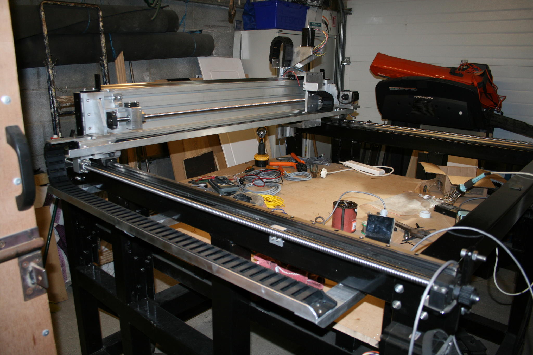

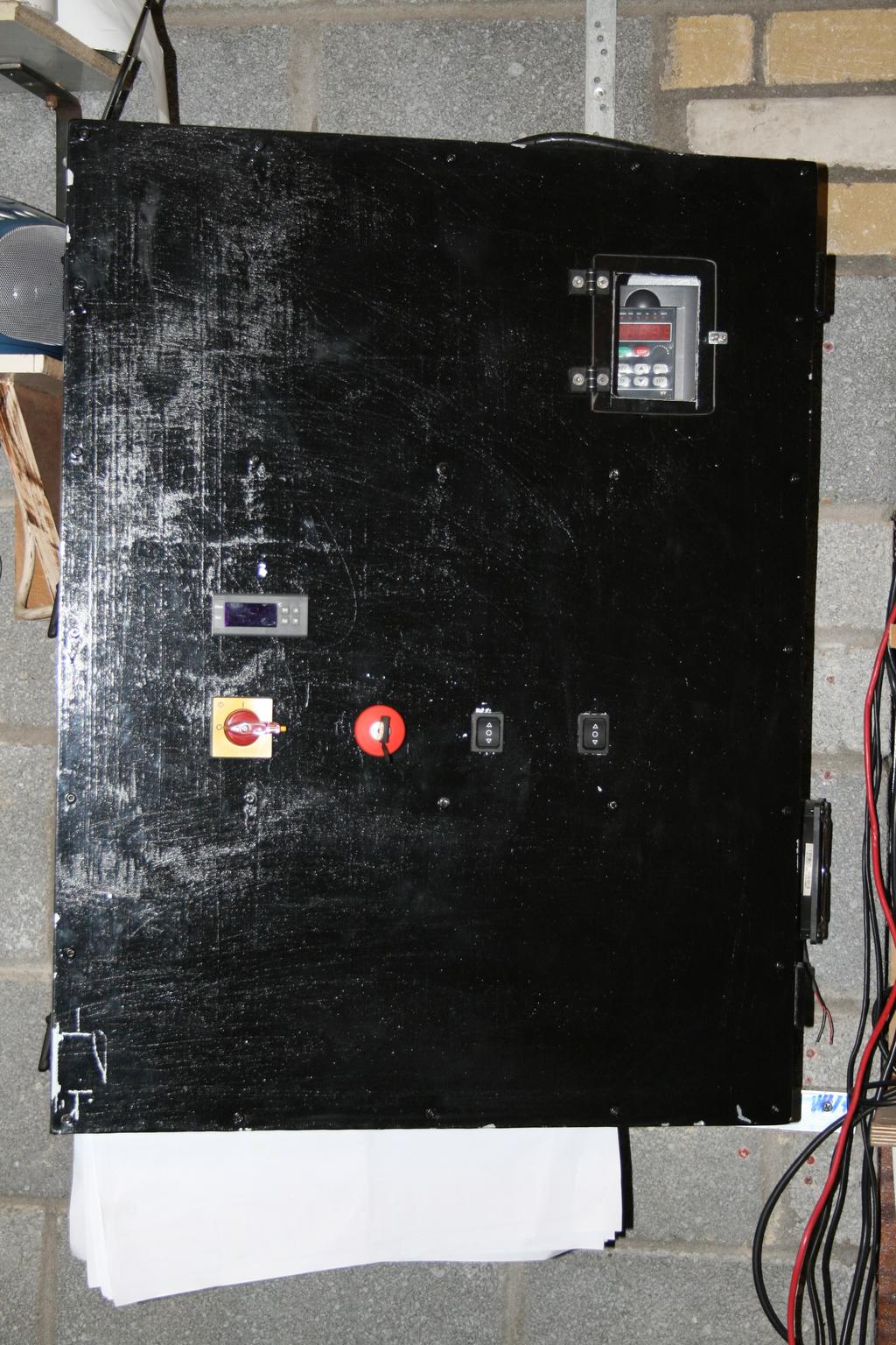

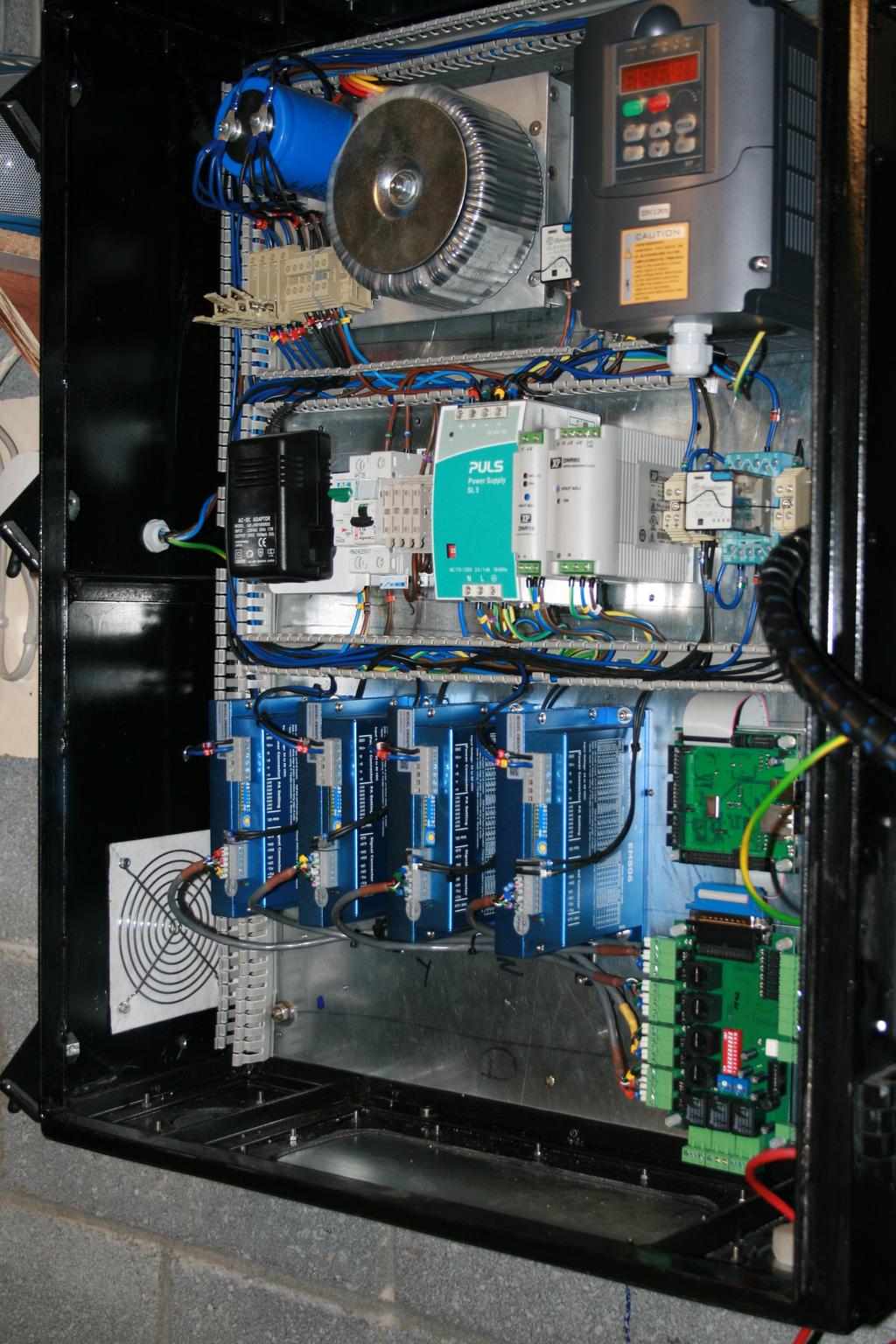

    My broadband went down early in the week so i decided to get the cable runs organised. i also fitted the home/ limit switches. i had gathered switches down the years so i decided to use them istead of sensors . Clive posted a link some posts back to some sensors that i will use if these don't work out. i also cut an opening in the door for a small window on hinges so i can see the VFD and adjust accordingly. i'm still a bit unsure about the inputs to the BOB ( which i plan to tackle next) i have a dwg. organised relating to the E/ STOP input to the BOB which i hope some will have alook at and give me the thumbs up or down.
    my query related to if i have the e/stop connected to the BOB correctly . is it o.k to take a tap after the e/stop as per dwg and use this as an input? this terminal disables the enable to the drives . i'm still trying to get my head around the fact that i can hook a supply and a ground to the terminals provided without having a dead short and blowing the BOB .

    Are you controlling the vfd via mach3 or are you changing the speed by the panel on the vfd if so I did a post here http://www.mycncuk.com/threads/7388-...se-Spindle-VFD post 1 its a very simple mod only taking a few minutes. The front panel just clips out ..Clive

    i have a breakout board that has PWM capability , from what i can gather. i haven't got around to the spindle side of the build yet! i'm trying to get my head around getting these motors to turn and getting the inputs to signal. i was hoping to get the M/C up and running with the basic controls and safety functioning and when i become comfortable with the operation going back at the spindle control. for the time being i would use the VFD . if the PWM doesn't work out , then i would definitely go the route of the link you posted, in fact it would be quicker to adjust a pot and have an instant response i would think, especially if the pot was mounted in a home made pendant that could be brought to the front of the M/C? i have my machine e/stop on a lead that i can mount either side of the machine on a hanging bracket and i could incorporate the pot and some other controls as i become more familiar with the process. by the way , is my understanding of how i should incorporate the e / stop to the BOB correct? i'm reallly not too sure if i'm right.

    The way I read the manual the inputs will take up to 30V there is a 1k Resistor in circuit that will limit the current at 24V to 24mA so not a dead short. Dean will no doubt pop along and give you the advise re the Estop and that bob. ..Clive
