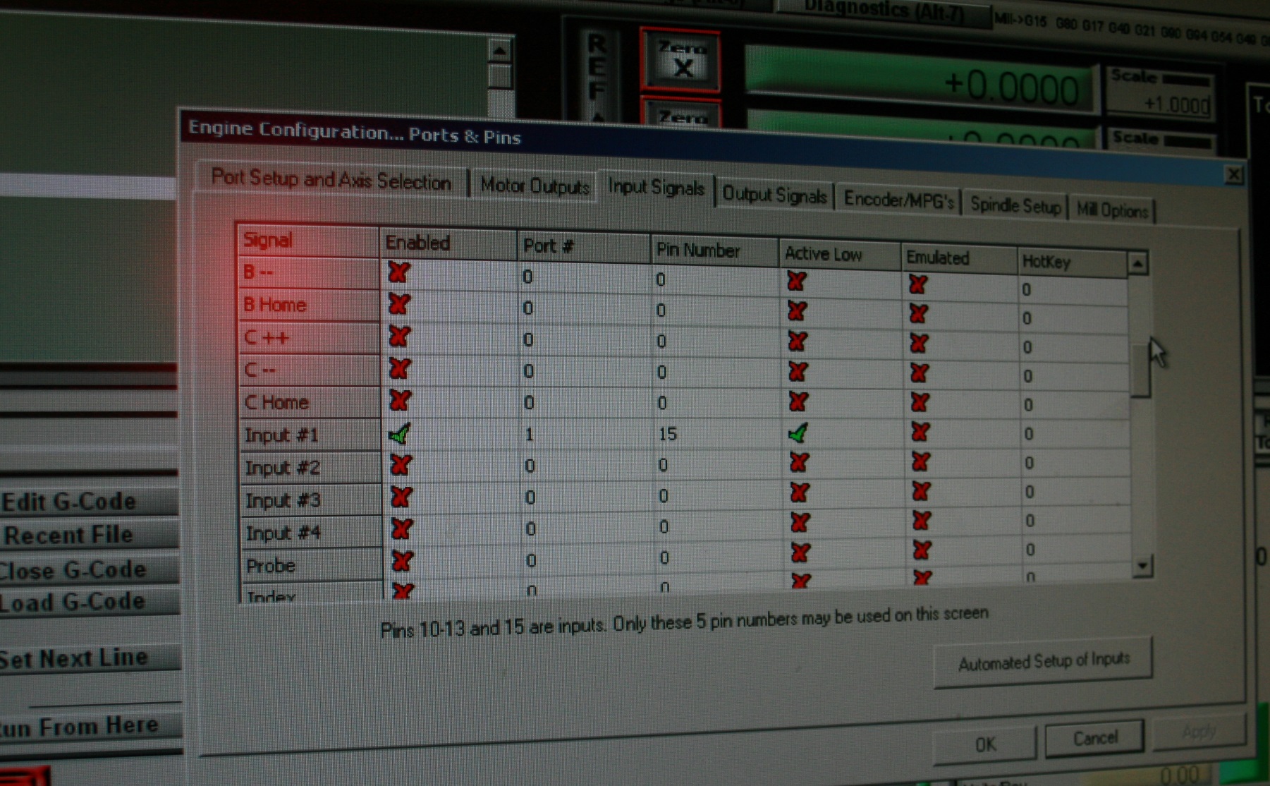

    It could be the Charge pump output if BOB as Charge pump feature.? You'll find it in OUTPUTS.

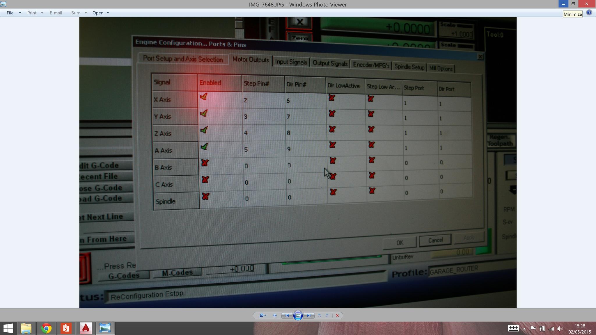

    Also make sure you have Enabled the Motor output.
    Take some screen shots of motor outputs, inputs and output screens so can see how your set.

    the manual for the drives allows me to auto configure the motors by switching SW4 twice in 1 second but i can only do this if i have the signals for the drives unpluged. when they are unpluged the motors go into a holding state i.e. they are powered.i have the drive enables wired directly to the bob enable inputs, when i disconnect them i can hear the motors humming and they are locked/held. sorry for the delay , i'm using a p.c. with no internet, paint , office , . i have it dedicated for MACH3 so i had to transfer files to my laptop.

    also, my reset will only come out of'' external e/stop triggered''
    if i have it set to pin 12, 13 or 15. if i set it to pin 10 or 11 it won't reset.

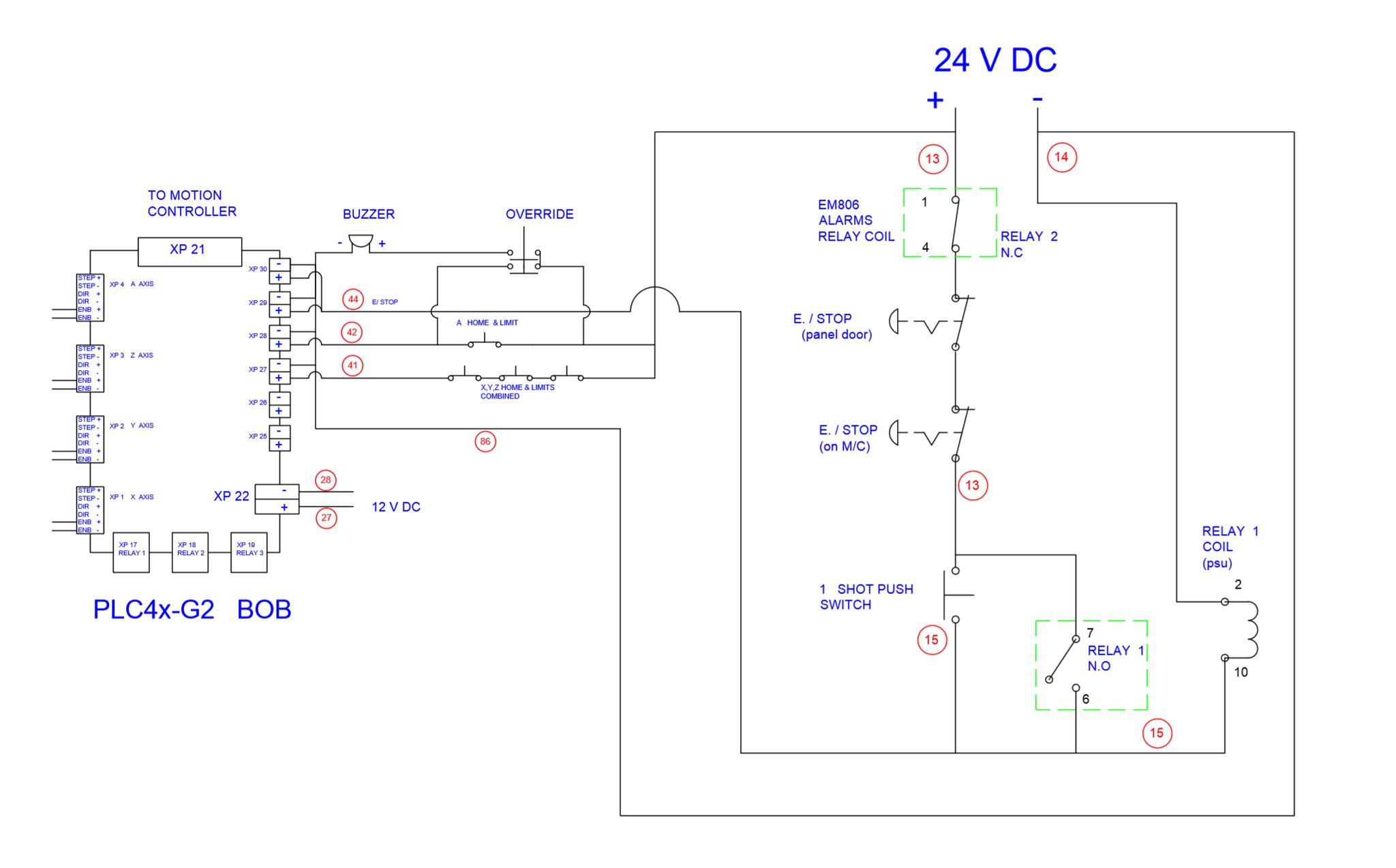

    i left the dip switch positions off on the BOB. to be honest i thought that i would get the basics hooked in .i have an e/stop , a home /limt and xyz home/limit hoooek up normally closed . i thought that these would get me up and running.

    i haven't the overide wired up yet , i didn't think that would matter with regards to getting the motors to turn .

    Looks like you hadn't set enable output. (enable1) Thats why the motors won't turn because the drive enable is being turned off.
    Try this xml.
