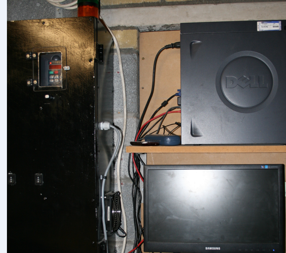

    I have been busy most of the week but did have time to try and sort out the 1.5 v issue with the PWM on my breakout board. I tried changing the settings but didn't have any luck. in the end i had a read of http://www.mycncuk.com/threads/7388-...se-Spindle-VFD (courtesy of Clive ) and decided to give this a go. i found a 10k 10 turn pot and it works a treat. i lost faith with the PWM control from the BOB because it ran on its own at a low R.P.M.when switched off and i didn't want to take any chances. The pot is on the door next to my P.C. so it worked out o.k.
    . my next task is to flash the table top and get it ready for some tee slot extrusion . i will have to revisit the PWM at a later stage when i'm more familiar and comfortable with the whole experience.
