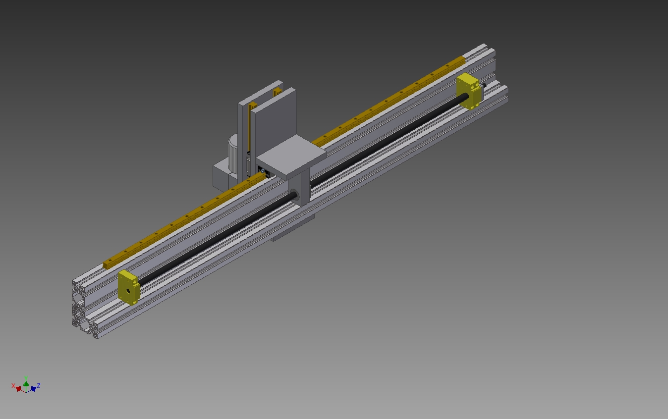

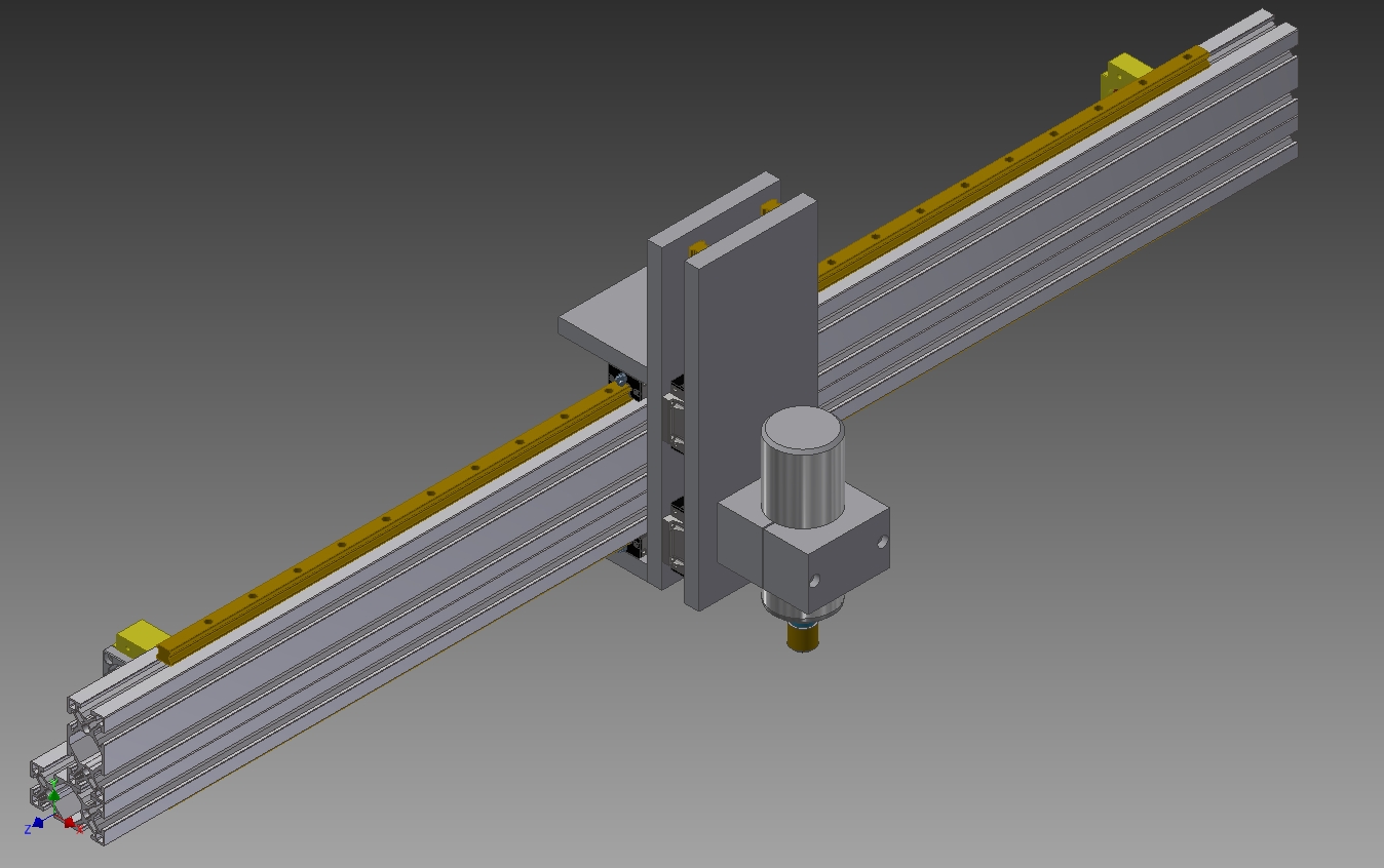

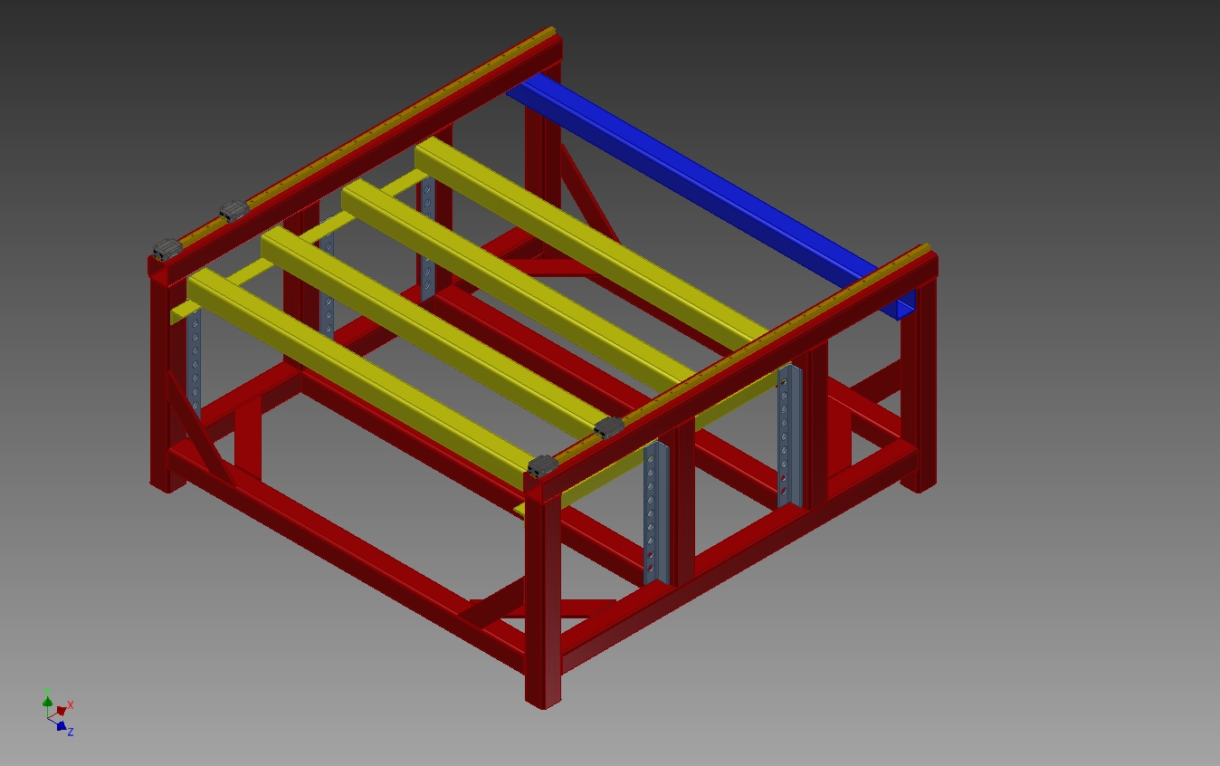

    At last i have an opportunity to get some images of the intended build posted for comment. i have read a lot of material on this forum and tried to include as much advice as possible . i haven't purchased any materials yet even though i'm itching to get started , but taking the advice given to other potential builders from Jazz, Jonathan , among others, i will build the frame first and then once i'm sure of key dims. i will take on the mechanical purchases and build. the gantry images are posted as a reference to my intended build but as always i'm open to suggestions.
    the frame size should take a half a standard sheet ( 1220 x 1220 ) built from 80 x 80 box section. 5 mm wall for the top rails and 3 mm for the rest. the adjustable bed ( yellow) will be held in place by graduated 50 mm x 6 mm angle ( green) secured to the frames uprights. the stand alone box section ( blue ) is detachable to allow space for a fourth axis , eventually!!
    i have a choice of extrusion for the gantry ( length 1610 mm ) either 100 x 50 , 4.18 kg/m, 120 x 40 , 4.35 kg /m or 120 x 40 , 6.8 kg /m .
    the linear slides, 20 mm hiwins , ballscrews 16 mm and aluminum plate for gantry , 20 mm . i haven't any motor specs yet so i didn't finish the z axis assembly . I might use 20 mm linear slides on the z axis ( off cuts from the 2m x rails ) or just purchase 15 mm rails. i will use epoxy to create a plane for both x axis and a permanent bridge for this and the x axis motor to belt drive the twin ball screws, OR use separate motors for each x axis ballscrew. all to be decided with the advice from the experienced builders here, hopefully!!!! i'm also looking for some motor dims, nema 23 , 3nm. they seem to be the weapons of choice for what i'm about to take on , so if any one can point me in a direction for a reputable supplier that has dims i can use to finish the z axis dwgs i would appreciate it. cheers Paulro.
