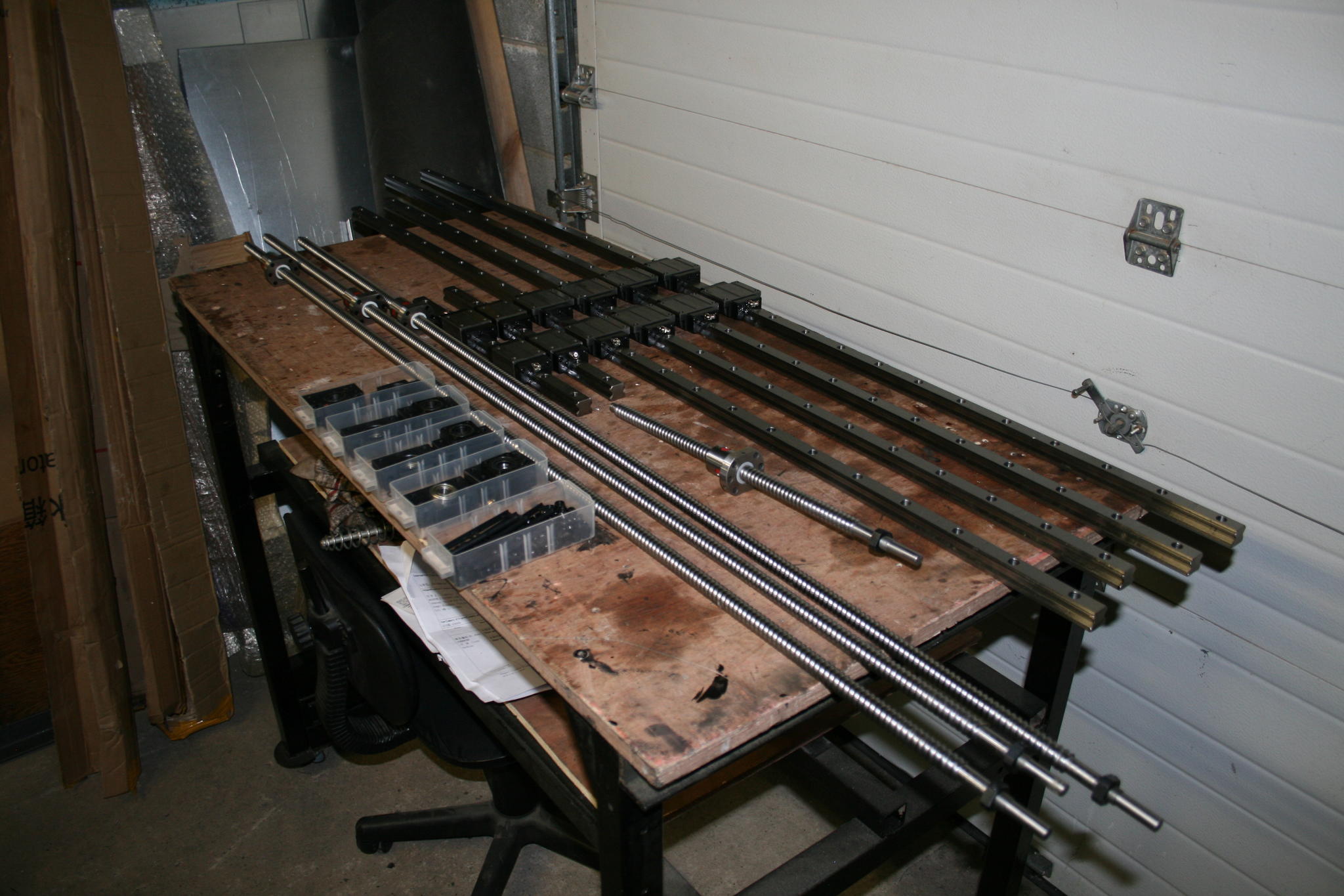

    Has anybody used the linear guides and rails from Chai? i have organised the ball screws from him and thought i would use his linear gear but only on a recommendation from the previous builders here.

    apologies for the delay in getting back to you Eddy, i haven't decided whether to mount a plate to the inside frame to house the chuck or sit it on the blue frame dedicated for the fourth axis. I plan on clocking it true it with a clock attached to the gantry, with regard to the separate panel i hadn't really thought of that option but now that you say it ..... i haven't sourced a panel yet . i'm hoping to pick something up in the region of 800 x 600 x 200 deep if its not too expensive. i have off cuts of 1mm galvanized sheets getting in my way and if the parts that i ordered from Chai are on a slow boat then i might toy with that idea for a panel.
    by the way can you recommend any supplier for linear rails ?

    Well sometimes I can't be bothered to piss about looking for the cheapest, so I go for the easiest. In my case I bought my rails and bearings from cnc4you.co.uk
    If your talking about the Profiled linear guides then yes I use them all the time and they are fine.

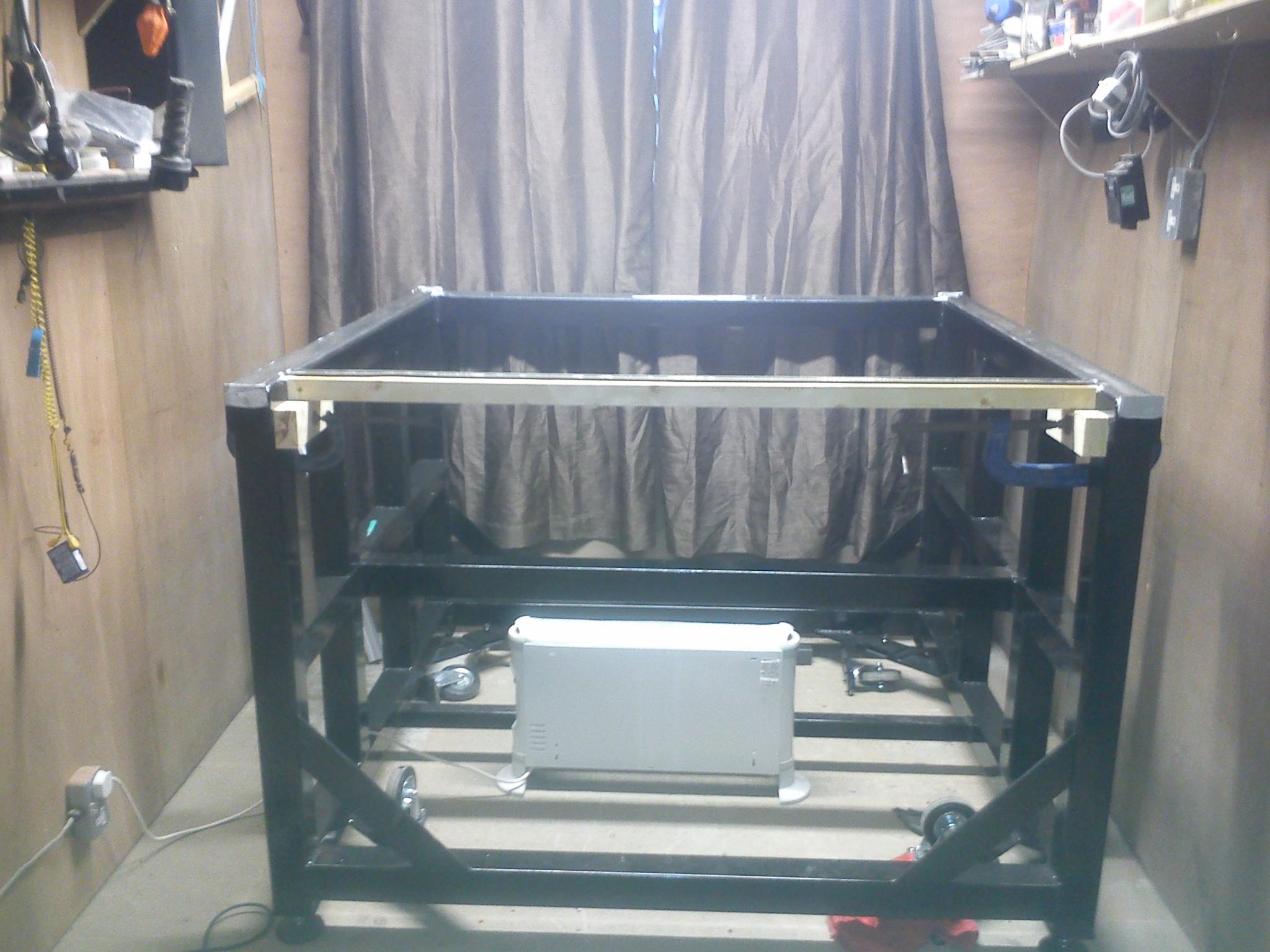

    steel has arrived and is cut and both sidewalls are welded.

    I have to string the crossbeams and tie both together.
    I contacted http://www.ecfibreglasssupplies.co.uk /to purchase epoxy 105 and hardener 209 but drew a blank . apparently they don't stock 209 hardener but told me the 205 or 206 hardener are very similar but for pot time and cure time. has anybody used these hardeners? i'll probably go with the 206 because it has a longer pot life but would like some feed back before i do.
    i also spoke to Chai about his linear guides and rails and the preloads are as follows
    Z1: 0-0.02C or Z2: 0.02C-0.05C . i'm sure either of these will do the job but would like to know which preload is the preferred choice for wood routers.

    Paul I contacted ecf as that is where I purchased mine from they don't stock it but they can order it, but they will not deliver it out of the country. Here is a chart that will show you the difference between 206 and 209 (page 3) http://www.paynesmarine.com/document...0Adhesives.pdf as far as I can see the 206 cure time is about 9 to 12 hours and the 209 has a cure time of 12-24 hours but the 209 is recommended in hotter conditions. The idea behind the slow cure time is not how long it takes to pour it, as that is only a few minuets but the time it takes to let it level out. ..Clive
    I have done a bit of research and you can buy it in Dublin here:- Waller & Wickham
    Unit 96, Baldoyle Industrial Estate, Dublin, , Republic of Ireland
    353 18392330 He will be in his office around lunch time today.

    Clive Cmon he's in Ireland don't think finding a cool days is going to be a problem, . . dry day well !! . .
    Paul I've used epoxy with equivalent cure times to 206 in past and had no problems but like clive says the conditions must be correct. Infact I've just ordered some 206 because ECF didn't have the 209 and couldn't wait or fancy being ripped off.( wanted nearly double the 206.!!) and I don't envisage any problems.
