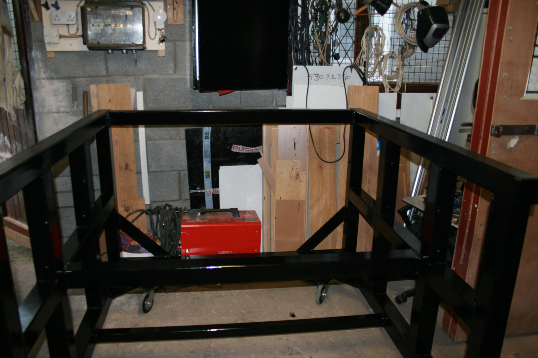

    Well at long last I can get back to the build of this baby. i had to take a break and head abroad for a time but i'm back now with a clear run for the next few months . i poured the epoxy and left it cure for 72 hours and i'm pleased with the result. i had a heater running and had the cubicle locked up to control the heat. it has some air bubbles but i can live with that.
