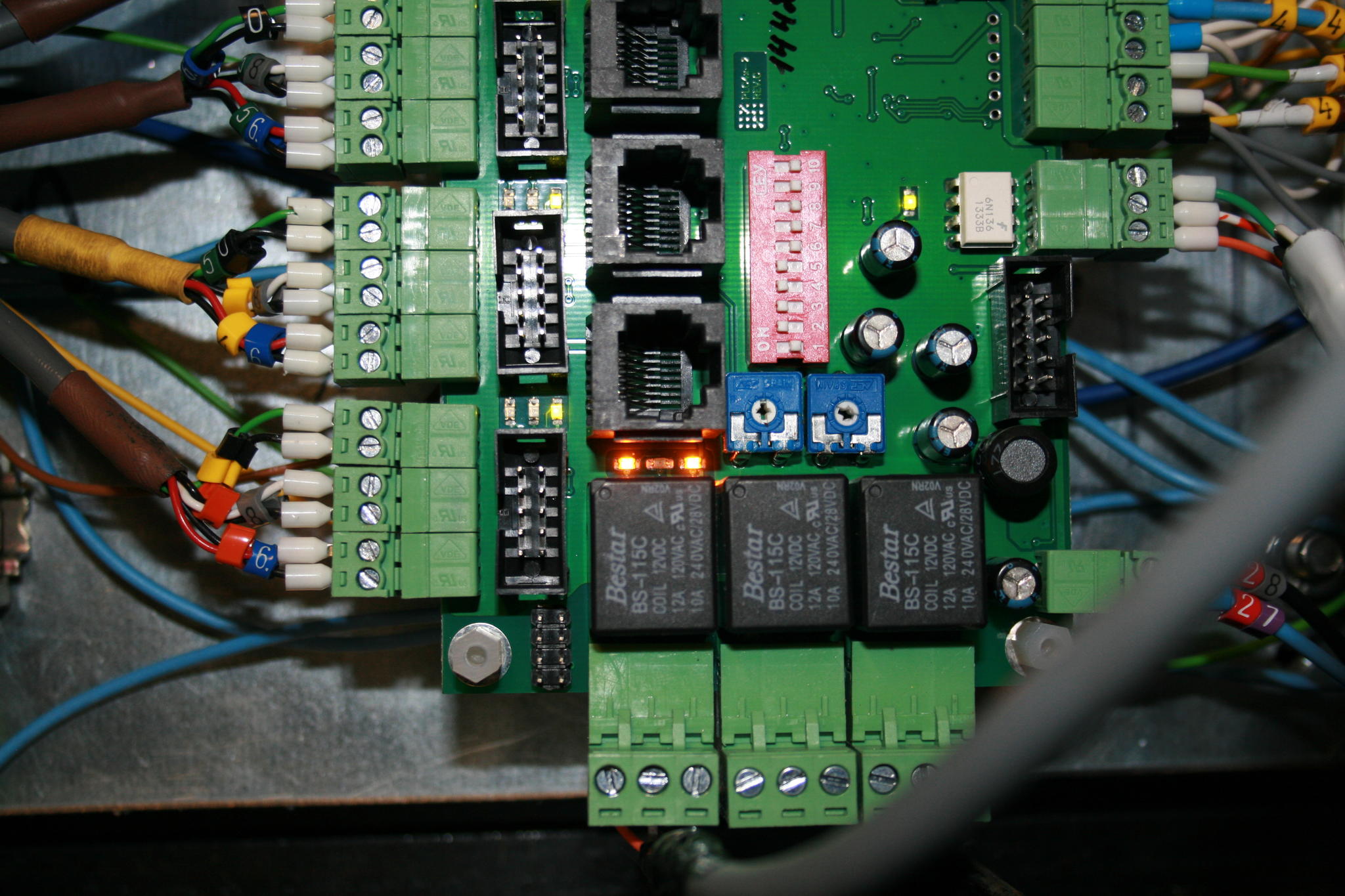

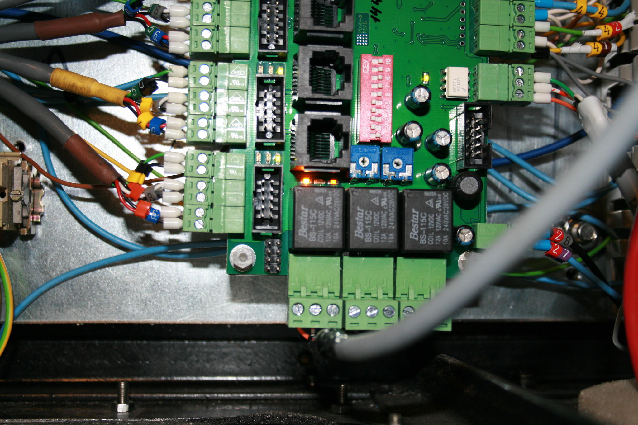

    i thought i had it all sorted so i tried to calibrate spindle from '' FUNCTION CONFIG'' tab. but it now has a different issue / maybe the same one ........
    so i tried as suggested ... PD001=1, PD002=0 .. Result is spindle running at top speed with no control from F5, or the '' SPINDLE SETUP '' tab in ports 'n pins.
    the ''DISABLE SPINDLE RELAYS '' or the ''MOTOR CONTROL '' box cannot control it either. i can, however turn of the relays from the '' OUTPUT SIGNALS '' tab using the '' ACTIVE LOW'' or '' ENABLED'' option. so MACH3 can control the relays from here .
    what has me puzzled now is that i have used the'' MDI'' tab to input M3 S2000 and the spindle runs once i hit ''enter '' on the key board or the spindle CW F5 . the VFD shows a reading of 20,904 on its window but the DRO for the spindle speed does not change. the '' RPM '' value in MACH 3 has never updated since i got the spindle running . when i turn it off and on again '' Spindle CW F5'' button or F5 from the keyboard then the led on the BOB for the PWM controlled relay 3 comes on , but doesn't burn as brightly as the start / stop relay led. the spindle will begin to run at 280 RPM (VFD readout)
    if i then hit ''RESET '' on the spindle speed window the spindle turns on fully and the led for the ''PWM '' relay3 burns brightly. this really has me puzzled.
    RELAY 3 is controlled by LPT pin 14 dedicated for PWM. i cannot turn this relay off from the output tab in port & pins .

    Ok well this confirms my suspicion that you are not correctly in control of the Relay outputs.
    First of all you don't calibrate the spindle with Function Config. Set it back to defaults and leave alone.
    To sort this your going to have to take a few steps back and deal with one issue at a time. So Forget the speed control for the moment We'll come back to speed and setting it up control later.
    Leave external control turned off in VFD, just control speed thru the VFD for now.
    Lets concentrate on getting control of the outputs that turn on/off the relays.
    First I need to know the position of the Dip switches on the BOB.?

  7. #255
    Ok well Dip switches are correct according to manual.
    So we need to see whats happpening or not.!! . . . We need to see if the Relay is active so i'd recommend you disconnect the wires to VFD and check with a Meter rather than having VFD turn on/off.
    First Type M5 into MDI to make sure spindle is off. Next test for continiuty between the Contacts of Relay #1 your using for RUN. It should have NO continuity.
    If it does then change the Active State of that Output.
    Now Type M3 into MDI and Check Contacts for continuity. You should now have Continuity and relay is active.
    Type M5 and relay should drop out and Continuity drop.
    If none of this happens then something is set wrong either in Mach3 or your wired wrong.? Only other thing it could be is the DIP switches are Wrong way around and the Relay is turned off on the BOB.!
    To be honest we are getting to the point where it's very hard to help without being there at the machine.! What I've suggested may seem basic but it's necessary that things are done step by step before moving on to avoid confusion.!. . . Let me know what's happening.!!

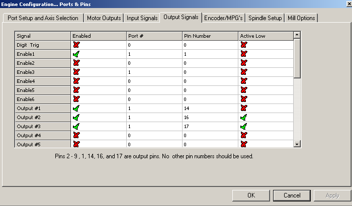

  14. #259
    i toggled the active state of the relays to see if mach3 could change the state of the relay from a non responsive state . i have them set back now to the folowing the run relay 1 is on constantly because of active high setting. if i input M3 the spindle will run at 250-300rpm . M5 stops the spindle again. the only relay to change state is the PWM dependant relay 3
  15. #260
    Paul your not listening properly because if you'd done as I suggested then the spindle wouldn't start at all. And the speed would be controlled from the VFD using what ever speed you set.
    You need to take a few steps back and deal with one problem at a time. Stop changing settings willy nilly because this makes the Job of helping so much harder. All this does is waste yours and my time by chasing false issues. I need you to only change one thing at a time then report what happens.
    First all you need to do is get Relay #1 working. Forget #2 & #3 we don't need them so you can turn them off on the BOB and disable them in Mach3.
    Straight away I see that you have the Wrong Pin number set for Relay #1. It should be Pin 16 not 14.
    Pin 14 is for the PWM Speed control which I believe is working fine just needs setting up for correct speeds which can be done later. NOT NOW.!!
    So to re cap Tell me which terminals your connecting to on the Relay.
    Set Output #1 = pin16 Active LO.
    Turn off the Enable for Outputs #2, #3.
    Next the relay will have 3 terminals which are you connecting to.?
