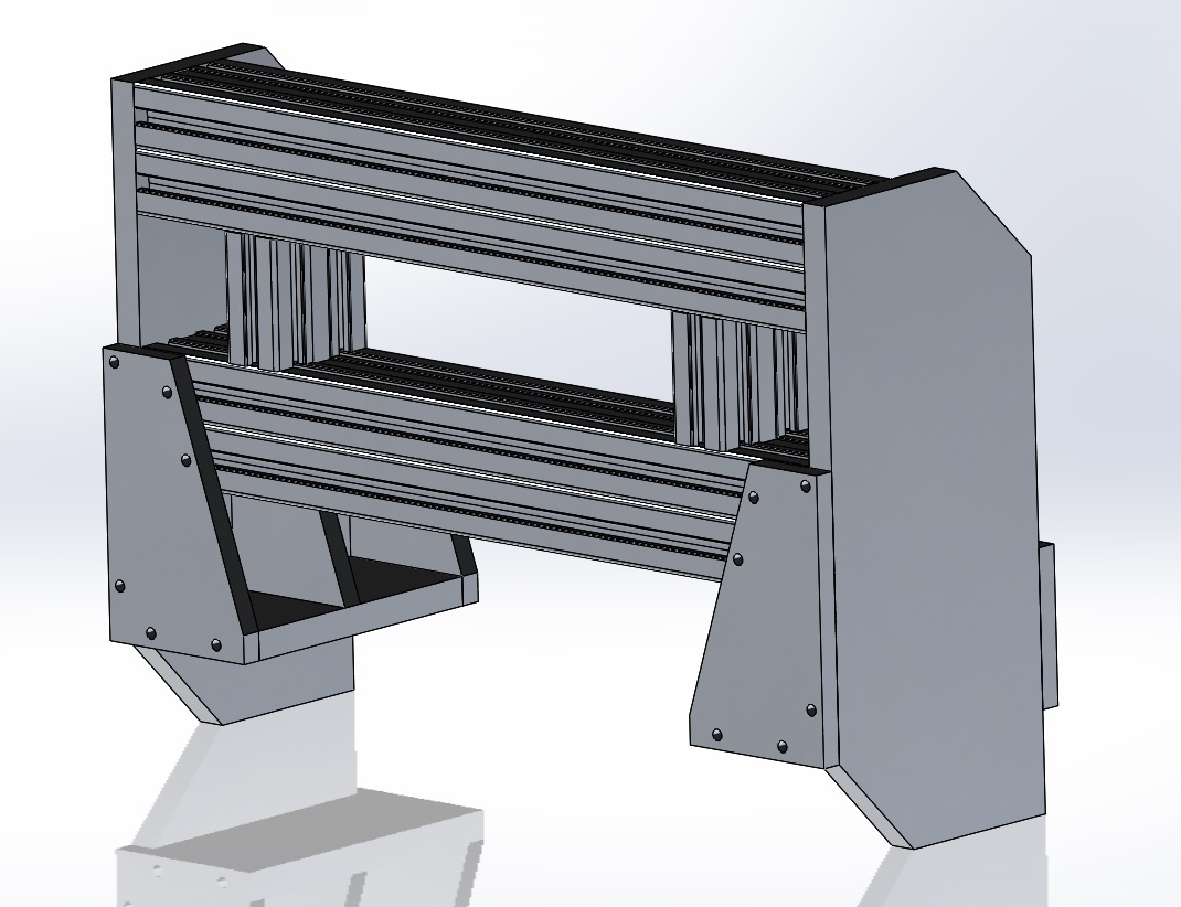

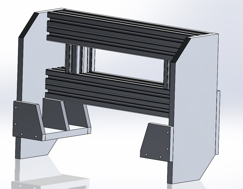

    There we go, third iteration. I've switched to square rails, 20mm. The frame is now a mix of 60x60mm and 80x80mm alu profiles. The alu plates are 20mm, except for the backpiece spanning the gantry, that one is 10mm.
    The steppers should be more securely mounted, the gantry should be stiffer and hopefully I think it might be slightly easier to assemble.
    What do you think? For some reason it just looks "wrong" to me, can't really put my finger on it.

    Looking pretty good now in my opinion. Again, if you are intent on lots of aluminium with a really good finish and short job times then the raised X-axis designs are really the way to go (i.e. not this layout).
    However, with this design as it stands you should be able to cut wood, plastic, and the occasional aluminium without any problems. I'd say it fulfills your brief and will make a nice machine.
    I'll just make this comment, which you can take or leave! The extrusion pieces between the gantry sides, rails, and lower plate - I can see why you've done it like that and it will help alot with the corner stiffness. But they look a little unfinished, if that sort of thing bothers you, then one of your first cnc jobs could be to cut out some 6-10mm aluminium plates to go over the ends and tidy it up a bit. The rear end cover plate could easily be larger and join all the gantry, side and lower plates together. In your link the rear view is shown in the 5th picture.

    This machine will be ok for medium duty aluminium cutting and will cut at those feeds and speeds but you will need some form of cooling with aluminium to get good results with finish. either Mist, flood or blown air.
    One thing I would do is get rid of those openended profiles has the offer very little strength and they will actually make building harder.? How will you access the Bearing bolts.?
    You will get the same or better strength from some simple 90deg triangle shaped plates bolted thru the gantry sides and into the bearing plates. Something like in the pics but made better looking this was just quick throw together.
    This will also allow easy access to the bearing bolts and make simpler to build and adjust etc. You could drop that plate at rear or just use some Thin 2mm plate as a blank if you want to close gantry but I wouldn't and would leave open so chips fly thru.!
