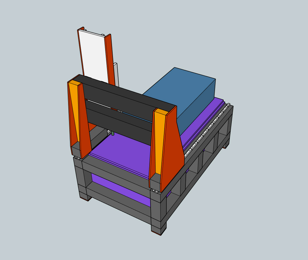

    Hi Jezz and thanks for the reply.
    The gentry is made of 100x100x4 mild steel mainly and 20mm aluminum plate.
    The estimated weight of the gantry excluding the steppers/HIWIN rails and blocks/ ballscrews and mounts is:
    Y + Z = 135 kg (including 5.5 kw ER32 spindle)
    Z = 46 kg (including 5.5 kw ER 32 spindle)
    In terms of speed I have no idea to be honest . I was told by someone who used to machine ice that I can push it as fast as I can as is really easy to machine. I guess experimentation will tell.
    I was thinking of servos as well, but they need gearing and since planetary gears are expensive and belts aren't an option in the freezer I think I am going to stay with the closed loop hybrid servos.
    I have seen your video review of the similar system from zapp and was quite impressed.
    Please see the attached pictures for sizes.
    Light Grey = 100 x 100 x 4
    Dark Grey = 150 x 100 x 4
    Orange = 10 mm steel plate
    White = 20 mm aluminum plate
    Blue = ice
    Purple = removable module to be replaceable with 4th axes module in future
    20mm HIWIN rails an all axes

    Ok well given the fact you will be running a resonably heavy gantry at higher feeds then I may be inclined to go with servo's due to linear torque.
    Other option is to use higher pitch screws 2020 so you can get the same speed at lower motor RPM. Obviously you will lose some resolution but do you need more than 0.01mm.? I think you won't for ice.
    20mm will put the motor in a 450 RPM range where torque is strong for the same speed as 10mm pitch. Where with 10mm at 9M/min you will be in the 900rpm range where torque starts to drop away.
    Also I think if you contact belt manufactures there will be belts than can handle the cold so you could either use servo's or steppers with higher pitch screws to increase torque with a ratio.
    Looking at the side view, it strikes me that things would be stronger if the cutter was further back so it was 'inside' the footprint of the two bearing blocks supporting the end frame. At the moment it is cantilevered out in front of them both.

    You and Eddy are absolutely right in your assumption. The design has changed since than. Instead of the 50x100 pieces I have used 100x100 ones all round and now the vertical bit is all the way to the back.Originally I have brought it forward to leave access to the HIWIN blocks but with the 100x100 profile it is no longer necessary.
    It looks like this at the moment:
    I have tried to design it in a way to have the blocks fixed and the rail moving, but the gentry become a lot taller.
    The reason for that is the fact that the lowest position of the spindle is different from what you have seen.
    You can see it better in the following picture.

    What i don't like about your design, now that i have seen the more detailed drawings is that the spindle center is overhanging so much that is in front of the gantry leg front bearing block. Do something about that. Instead of triangles you can offset the gantry a bit back, so the forces equalize.
    This is a major design flaw in my opinion.
    Read more here http://www.cncroutersource.com/do-it...NC-router.html The picture below is from that link and illustrates how basic forces work there.
    I would have used servos. I would have definitely used 220v AC drives even for steppers, so seems your choice is right there.
    I would definitely flip the Z design, so that the moving plate is the longer part , with the rails there, and that the Bearing blocks are on the fixed plate
