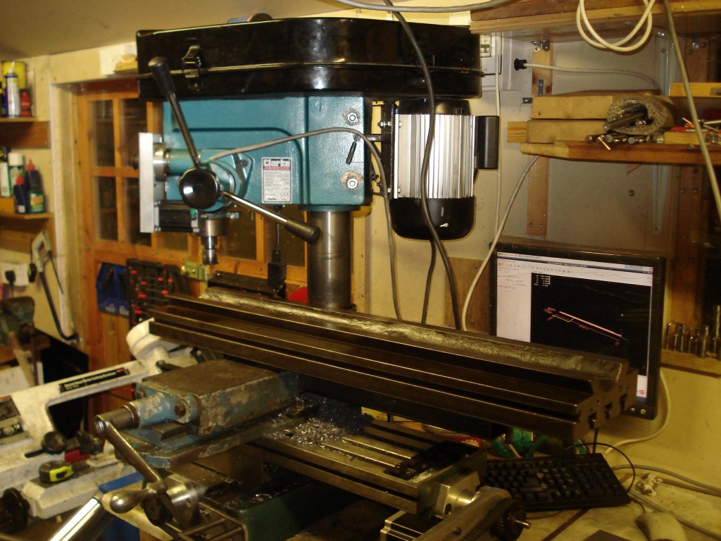

    Lately I've been working on converting an X3 mill, for myself. The eventual plan is to put linear guides on all axes, add ATC to the spindle (using similar method to the Tormach system) with a moving tool rack and replace the spindle motor with something better. To start with I'm working on the Z-axis and ATC - X and Y can wait.
    Starting with the motor - this is the one I chose:

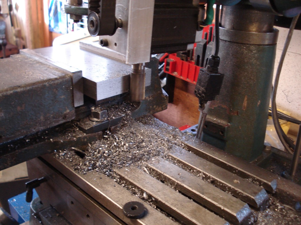

    The motor clearly doesn't fit through the cutout in the side of the mill head, so I milled a hole in the top, then cut the annoying protrusion inside off with a slitting saw:

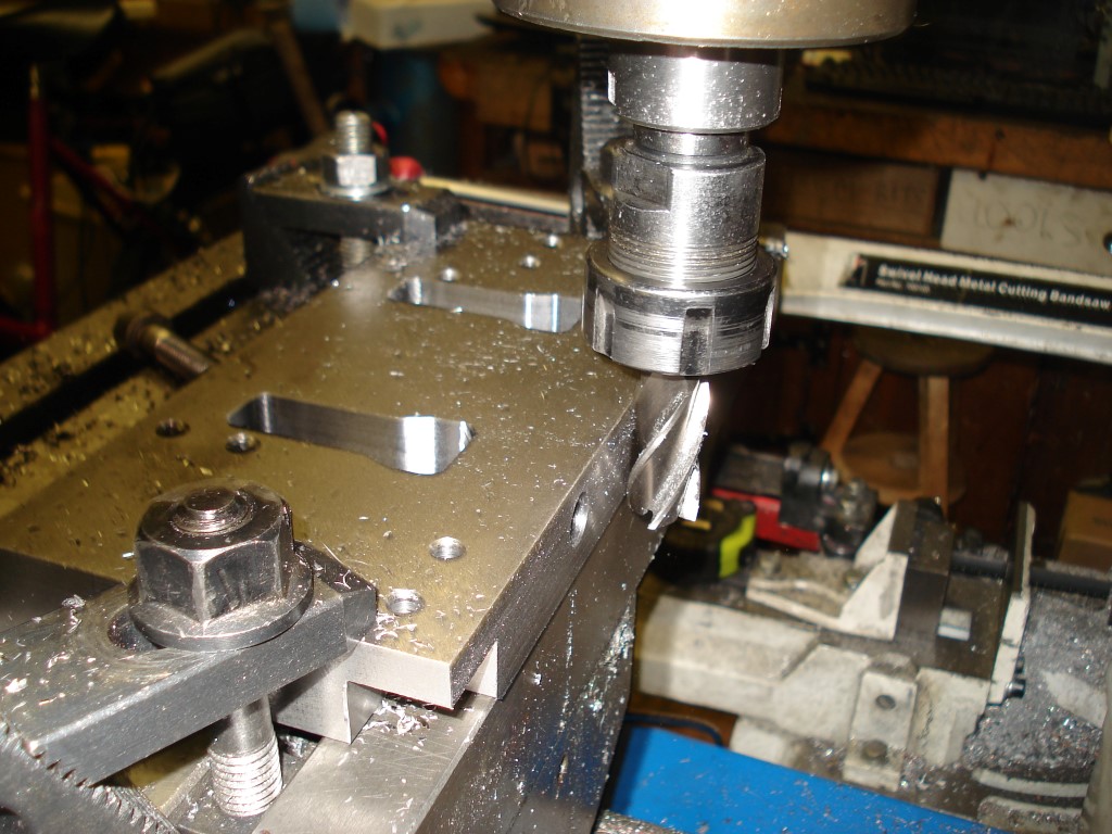

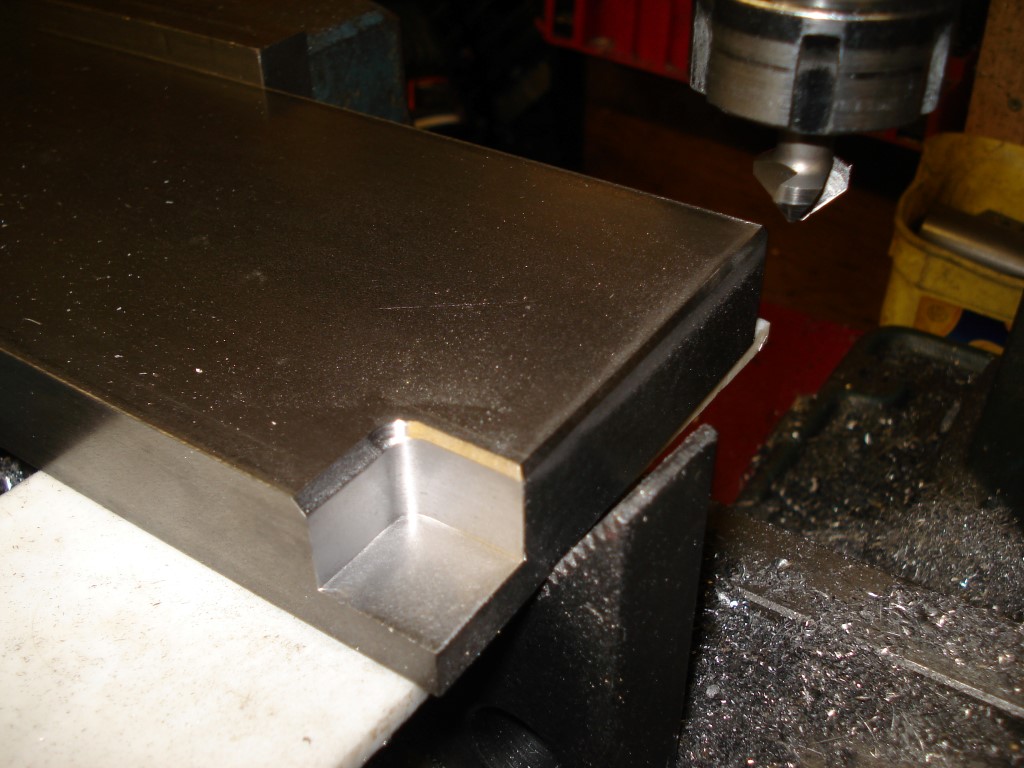

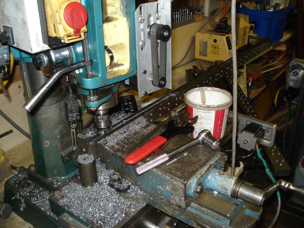

    I'll machine an aluminium plate the size of the head to both support the motor and heatsink it. I've calculated that a 5M, 25mm wide HTD belt will be adequate (just about) to couple the motor to the spindle so I've ordered that and some pulleys.

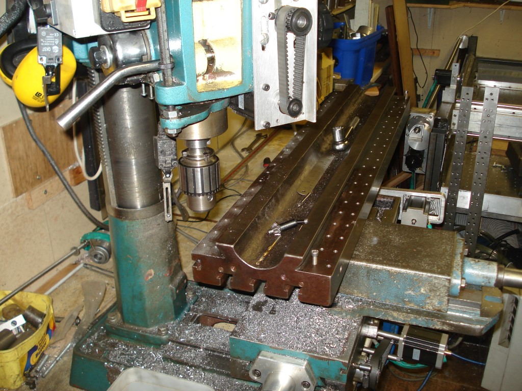

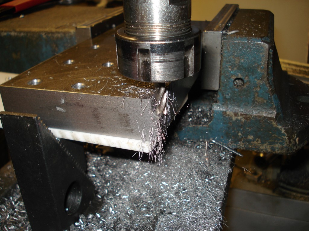

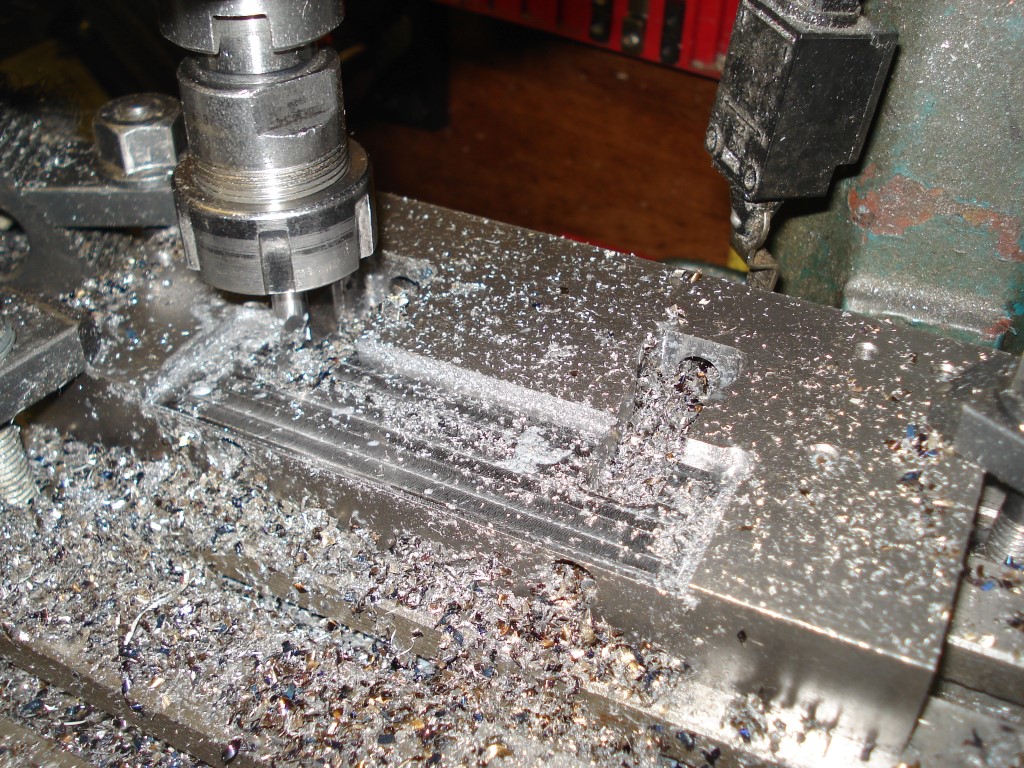

    I decided to put linear guides on the column to remove the various (potential) problems with the dovetail slides. To do that I've milled a small amount off the dovetail on one side of the column, then drilled and tapped lots of holes to fit some ground strip upon which the rails the rails will be mounted.
    As I found a long time ago when converting the other mill, cast iron cuts well on my CNC router, so I used that to do the necessary milling and drilling:

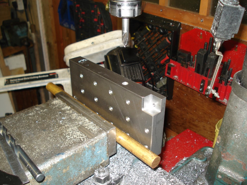

    Drilled array of holes in the back of the column so that I can mount a piece of 20mm thick aluminium to the back of it to improve the torsional stiffness. The ballscrew will be on the front between the rails, so no need to have the column open. I can also conveniently mount the motor drivers inside the column and use the aluminium plate as the heatsink.

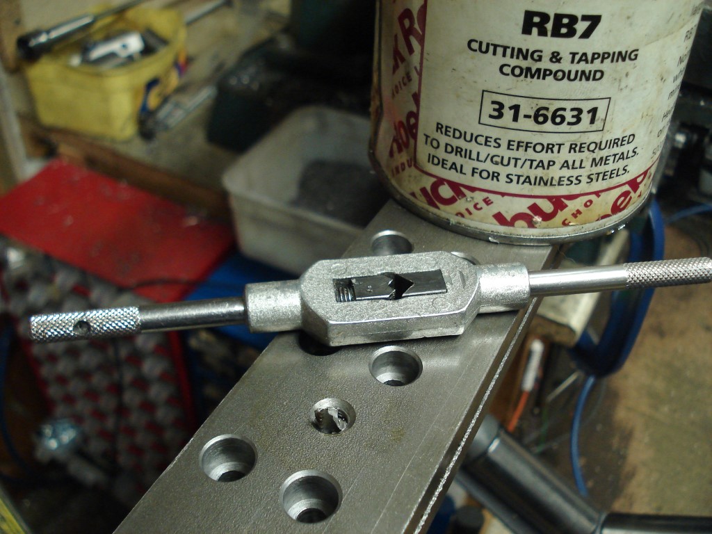

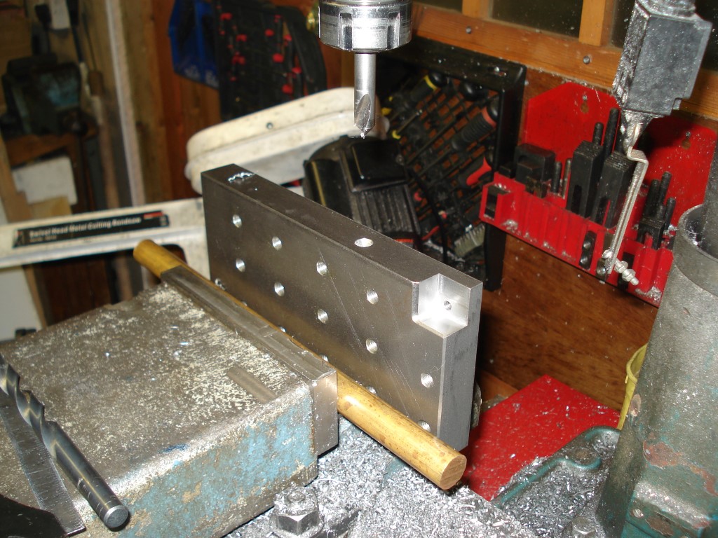

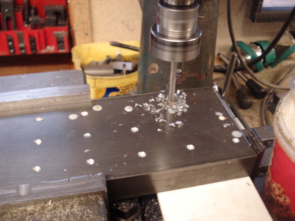

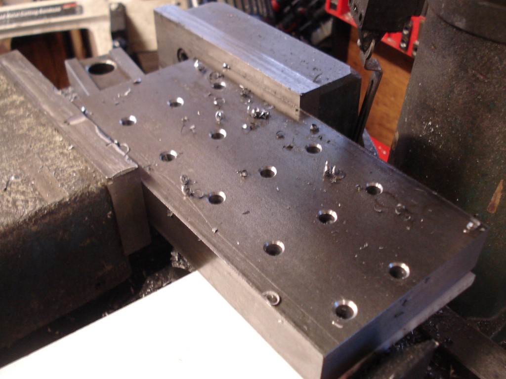

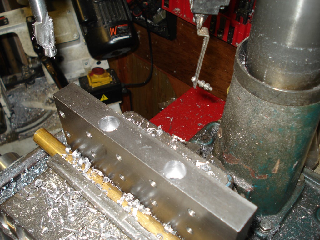

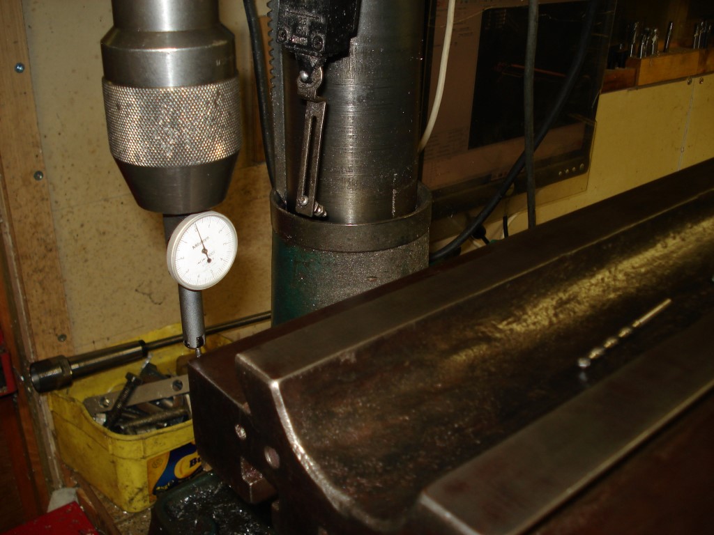

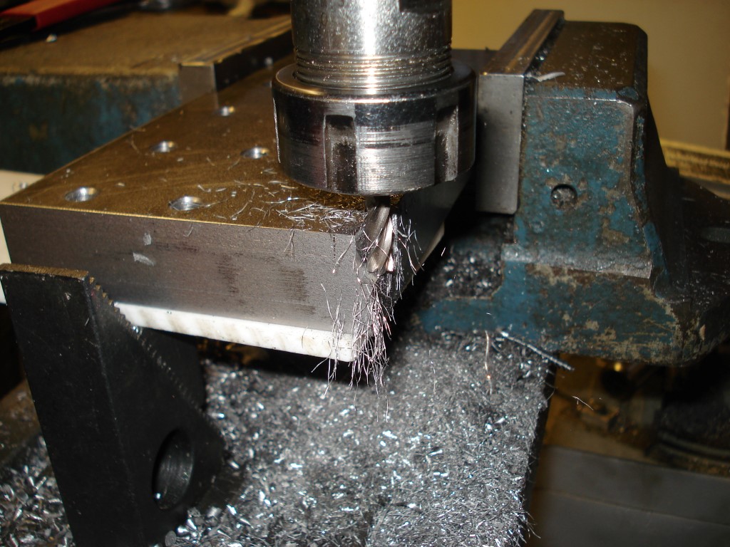

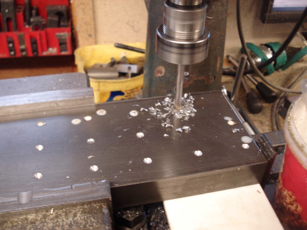

    Now to drill the rail strips - align the vice then drill, pretty simple:
ID:	12619Click image for larger version.

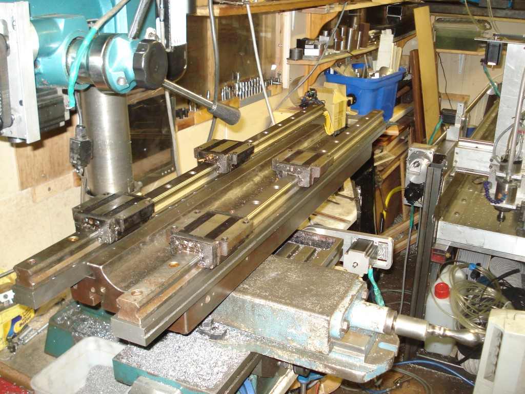

    Ready to mount rails - just need to check the join on surface plate, but it seems OK.
    Simple aluminium plate machined to connect bearings to head:
ID:	12616Click image for larger version.

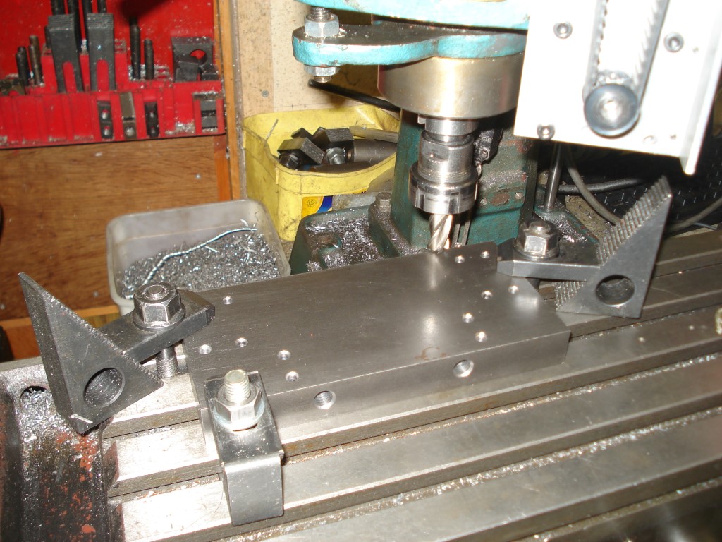

    I cut out the back plate for column, will leave the tapping for a rainy day:
ID:	12631Click image for larger version.
ID:	12627Click image for larger version.
    The spacing of the bolts is loosely based on the theory here - namely make the stress cones under the bolts intersect to get maximum stiffness. This diagram illustrates that:

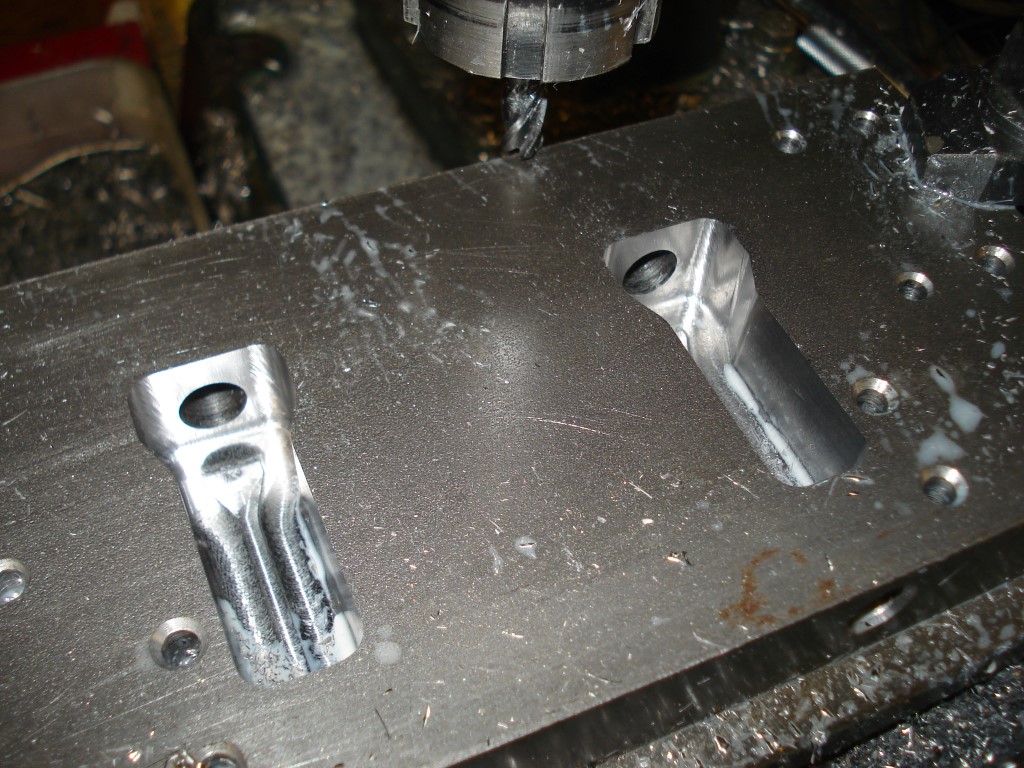

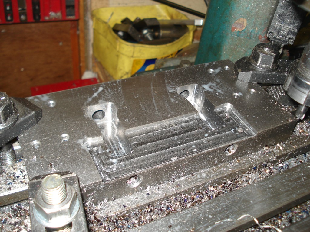

    Made a ballnut mount for Z:
ID:	12633Click image for larger version.
ID:	12632Click image for larger version.

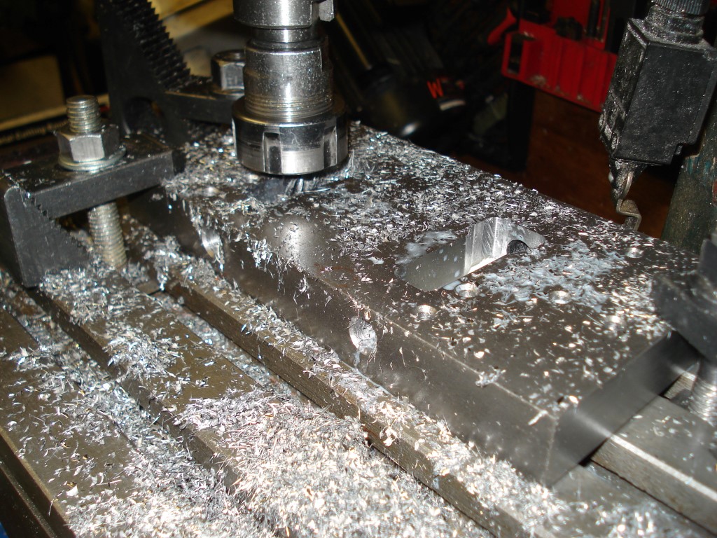

    Remembered the cutout for the ballnut mount in the Z-plate. Clamped directly to mill bed to ensure parallelism.
ID:	12637Click image for larger version.
