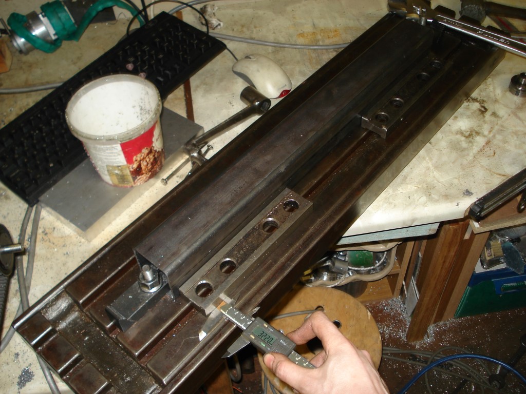

    Today, I milled two slots!
    4mm wide by 5mm deep slots in the steel strips shown in the previous post. The slots will have simple covers placed into them.
Name:	DSC00158 (Medium).JPG
    Next I've devised a bit of a mad scheme to drill the array of M6 holes in the bed:
Name:	DSC00160 (Medium).JPG
ID:	17062Click image for larger version.
Name:	DSC00161 (Medium).JPG
    Then checked that it was sufficiently parallel - couple of whacks with the nearest hammer and it's now within 0.05mm over 400mm.
Name:	DSC00163 (Medium).JPG
    Now to continue the drawing...
