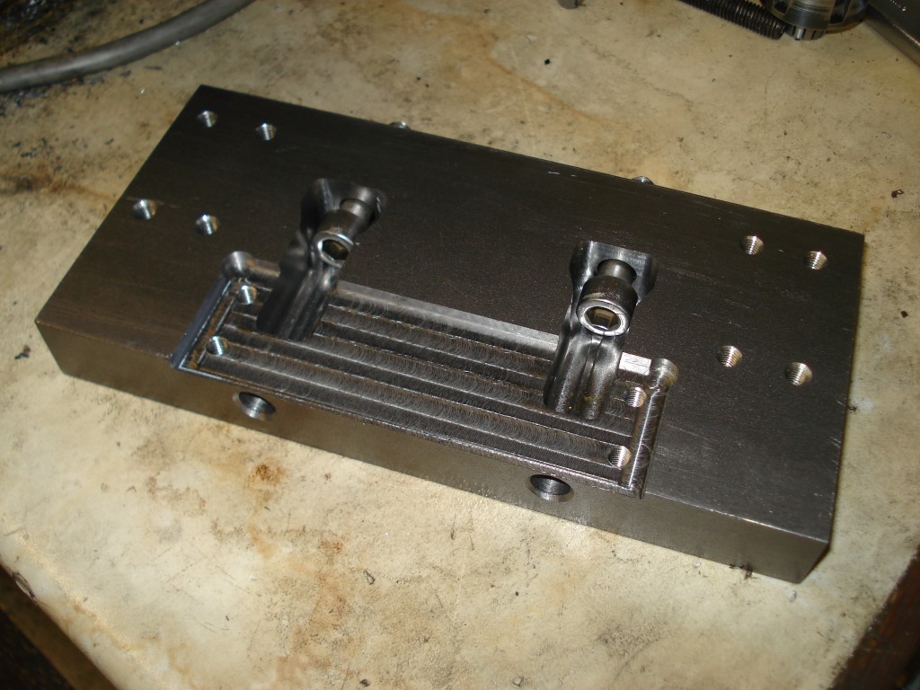

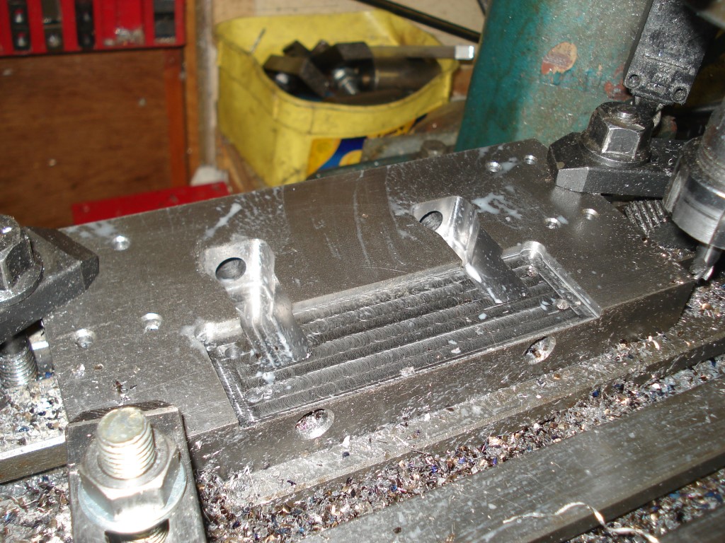

    I made some progress - over the weekend I machined the end pieces for the bed:

    I have now left the bed with "Leytoner De Montford LTD" in Leicester to get both sides surface ground. First time I have needed someone else to machine something for me...
    Next step is to acquire a straight edge asap to align the rails and decide on what bearings to use for the ballscrews (not sure on angular contact vs taper roller) so I can machine the housings.
