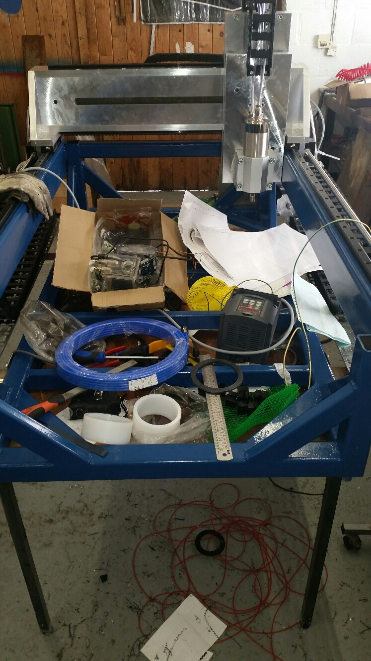

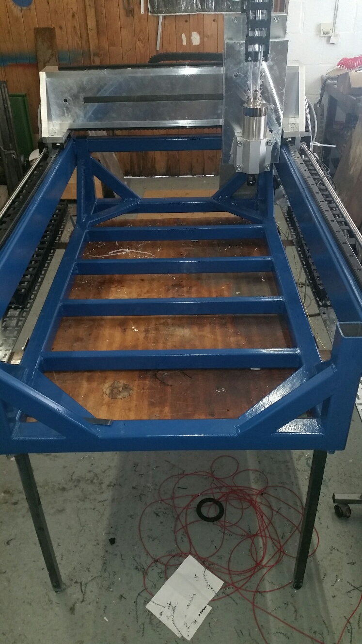

    Looking forward to more updates soon!! I can relate to the clearing crap off the table....here was mine this morning.....second is this afternoon as I'm going to start back on it again ASAP.....

    Neil...
