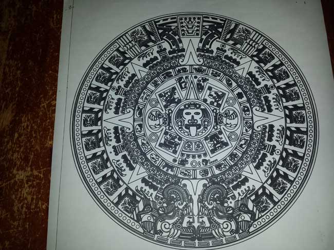

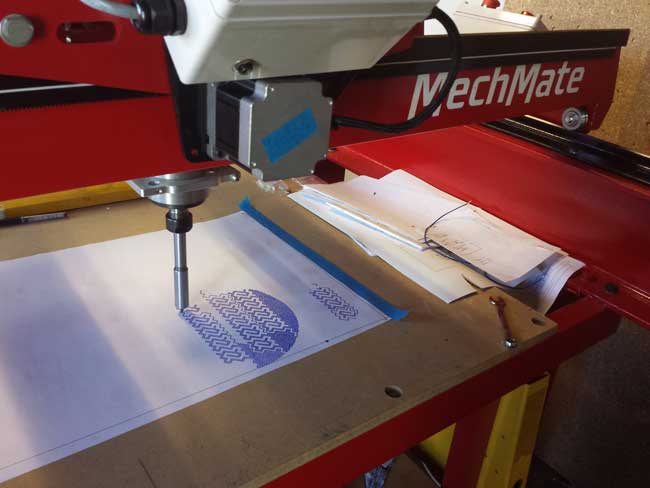

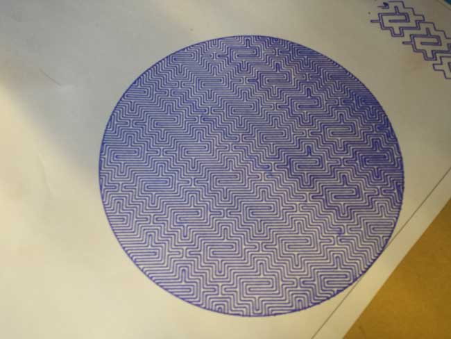

    Machine is almost ready to go, structure is complete and control system 99% done. Still need to get the spindle power and cooling buttoned up. I wanted to check that machine would do what I wanted it to so I chucked my sharpie holder into the spindle and had the machine draw a couple of things. It temporarily became a giant plotter :)
    Still haven't sorted the touch off stuff yet, have just eliminated the 126 as the problem. It is looking like the ESS is getting in the way somehow.
    Anyway, more to do before making dust instead of drawing stuff..
