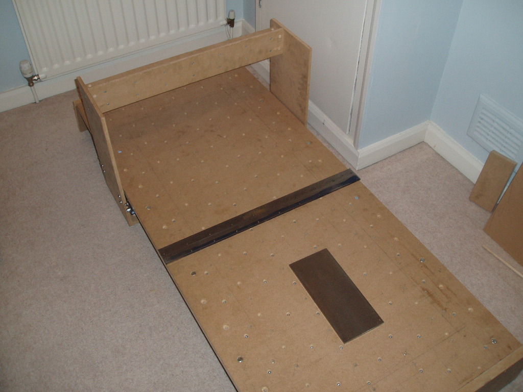

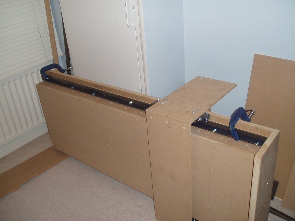

    OK, a bit more progress this week... And the result is a rolling X axis!! wooo hoooo!!

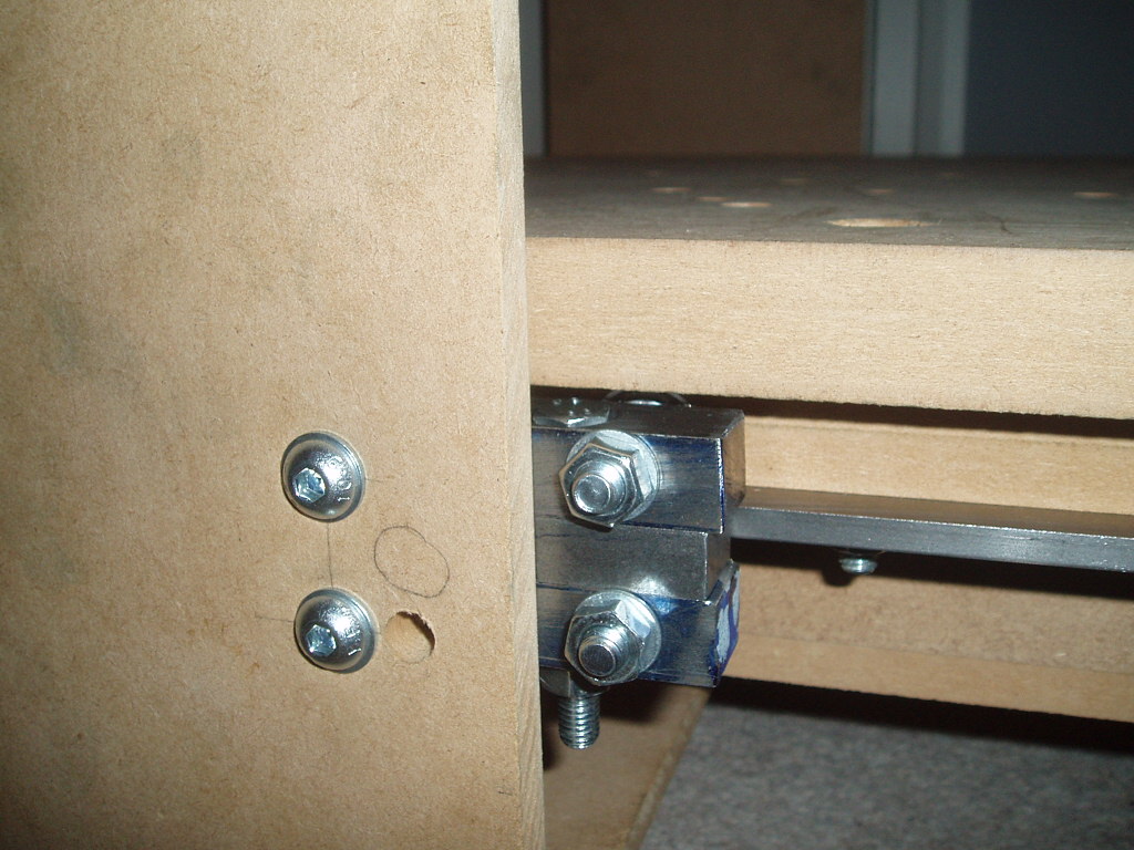

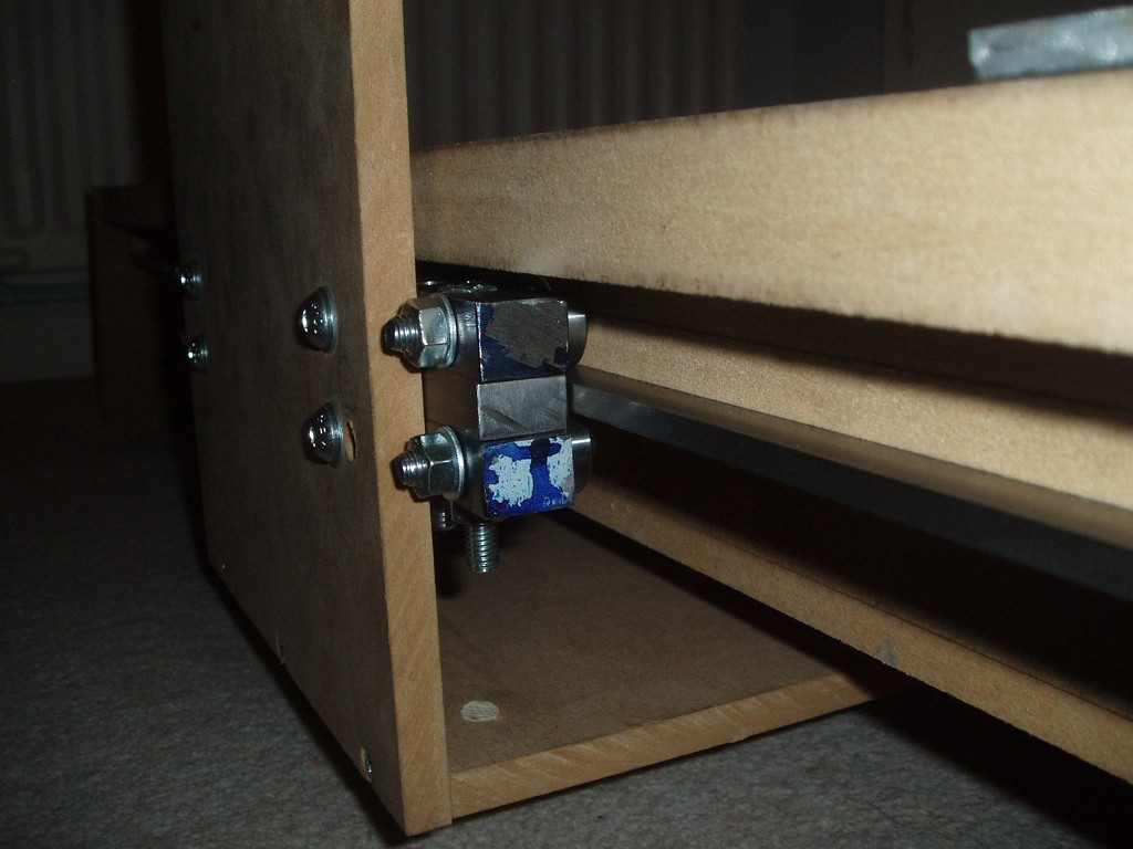

    My Y gantry was ready to go, so this week I drilled the X rails (8mm dia), clamped them to the router bed and adjusted to get things roughly symmetrical. When happy, I put 8mm holes through the router bed itself.
    Next I removed the rails and opened the holes out to 12mm dia - this is part of my 'cunning plan' to allow things to be set up just right when it comes to final assembly. The oversize holes allow up to 2mm adjustment in each direction (there's a similar arrangement in the carriages, but only 1mm each way).
    I also had to do a bit of 'fine tuning' with a newly ordered 16mm dia bit to counterbore for the hex screwheads. I thought modelling the fasteners in sketchup would be going a bit too far - I was wrong!!
    Getting it all fitted up and adjusted was a little fiddly, but not as bad as it could have been! :clap:
    And it rolls fairly smoothly.... A bit of a relief!
    Pics:
    1) Fitting the first X rail
    2) Counterbore for screwhead clearance (oops)
    3) Looking along one of the rails
    4) The whole machine, with Y rails drilled ready to do the whole thing all over again on another 2 axes

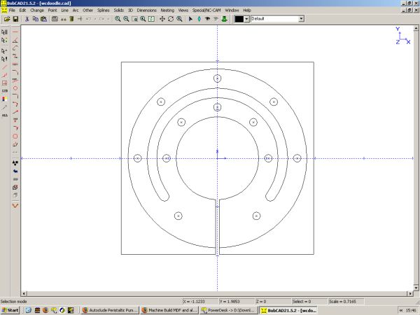

    I was thinking just a piece of square bar bolted to the mounting with a hole down the centre and pass water through...voilà kiss principle cooler :idea: I have one drawn up in cad somewhere that got a little fancy.
    I'm not sure of the internals of the Kress ie whether it's like a lot of routers and has the bearings mounted in rubber cups or if they're in metal for heat transfer....Bearings get hot and the comm takes a pounding (I have a router that I ran for 5 minutes and the comm is messed up...cheap crap) Way too much plastic in use on electric tools these days!
    Would like to see a pic if you find your cad drawing:wave:
    Possible to simplify a design I don't split my brackets.
    I drill the side hole first and put a bolt and nut thru and tighten it up, then bore the 43mm hole.
    Lastly I cut the head off the bolt so the stud with cutaway can move and clamp.
    Just like a tailstock barrel clamp.
    Saves a slitting or sawing operation, did I mention I was idle ?
    Not noticed mine getting hot but it's only the 800w model, never run more that 6mm cutters so couldn't see the reason to go bigger
    John S -
    So that wasn't suds you were using on your Bridgeport then John?
    Nice clamp John, not seen any made this way before.
    Michael.
    Yes it's a .cad format that will only open if someone has got Bobcad.
    took the liberty of getting a jpg from it.
    I presume the small circles are for a top mounting plate ?
    John S -
