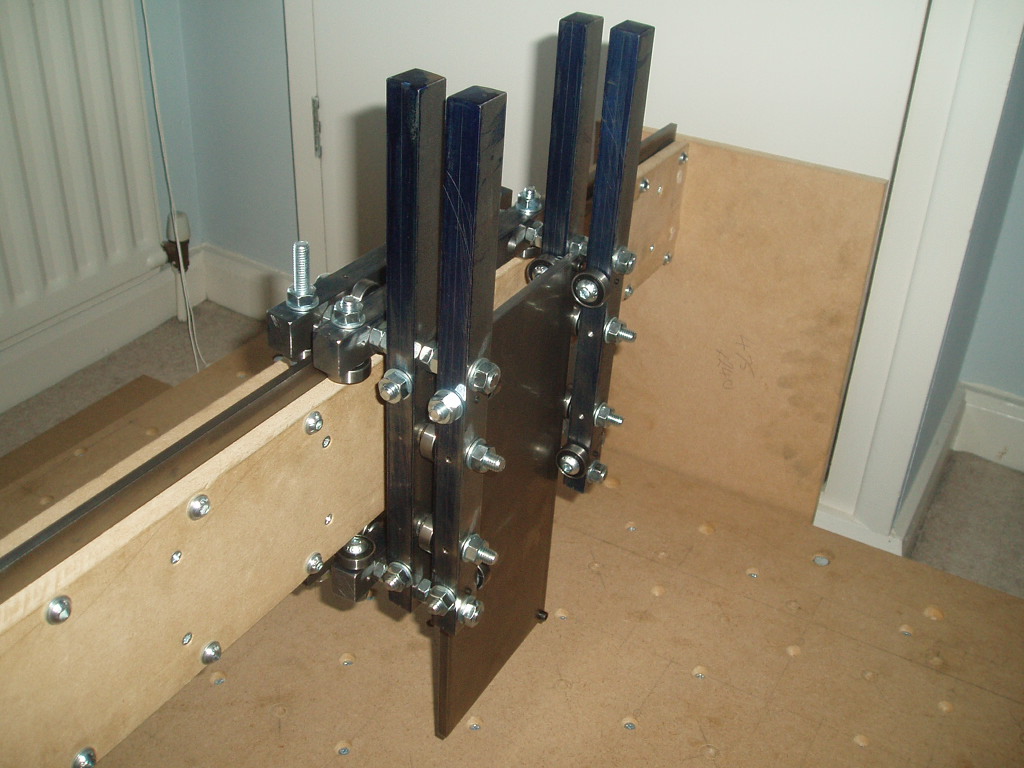

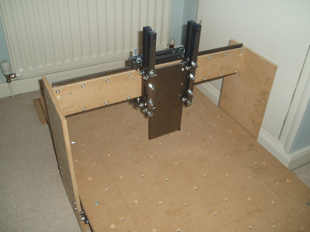

    OK, a bit of progress. The Y and Z mechanics are finished now. A bit of adjustment will be needed to get the Z exactly perpendicular to the table, but that can wait till leadscrew time. I'm pleased with the way it's turned out - heavy for sure, but no sign of any flexing.
    Pics:
    1) Distance shot (can't see the rough edges from back here!)
    2) Close up - (ah yes, there are the rough edges)

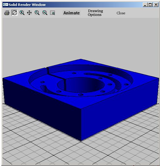

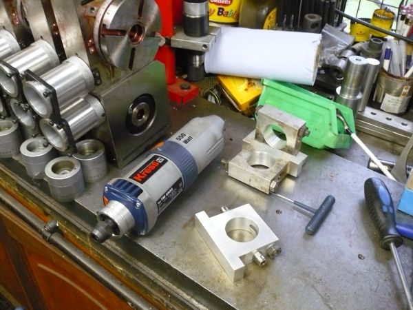

    Well managed to get a few minutes today free from upsetting customers long enough to do a few water cooled Kress mountings.
    I suppose you could call these Waterkress mountings :naughty:
    One piece construction with the water going around about 70% of the circle, 6mm push in piping.
    Couple more at the back just want scotchbriting as this was the last bit of 25mm thick bar I had and it was a *bit* shop soiled.
    John S -
  6. #26
    No cross drilling, it's all milled out internally with a 8m cutter down the sides to form 20 mm wide slots and a 14mm cutter at the back.
    No idea on pump, just made the mountings to order.
    John S -
