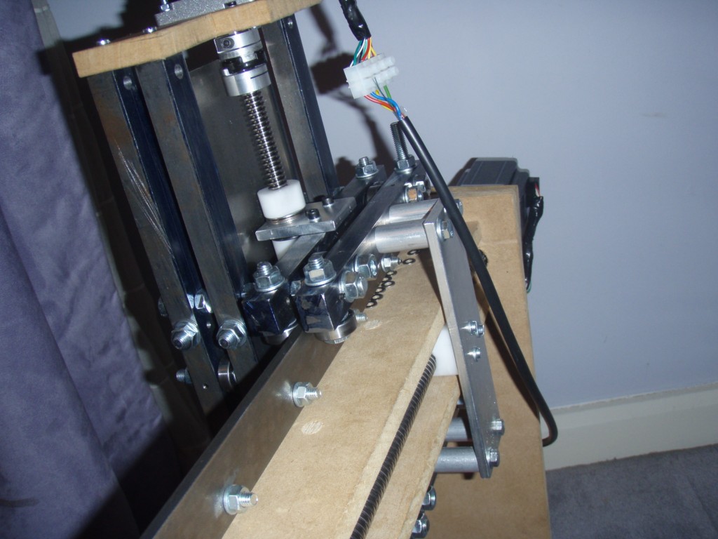

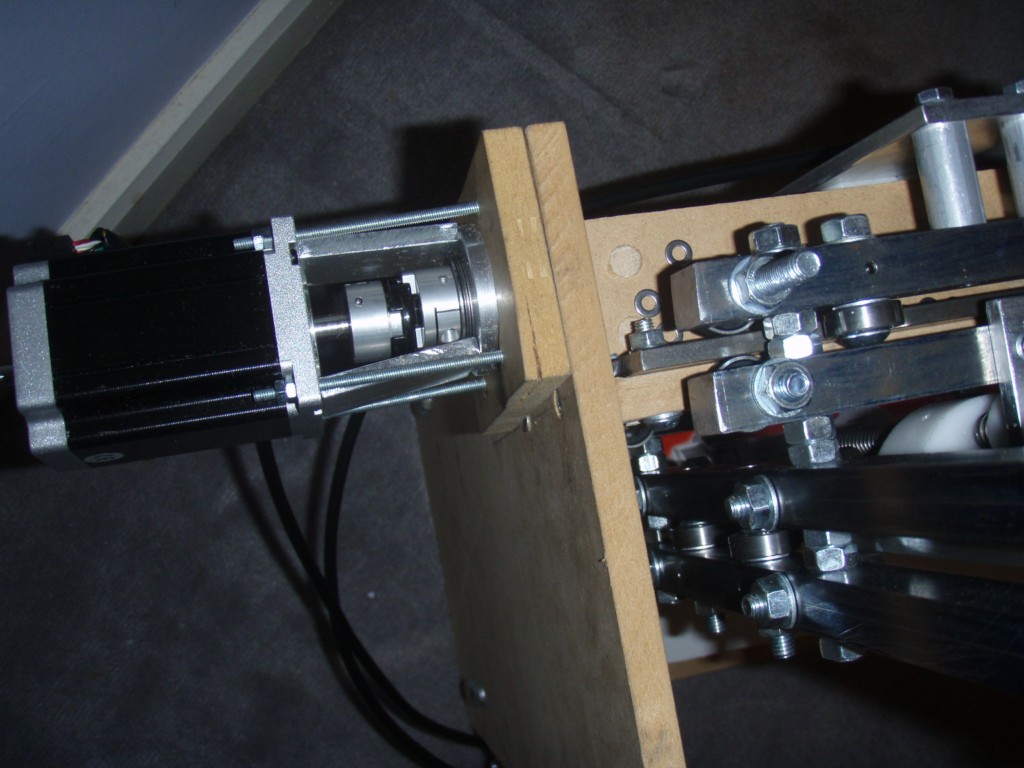

    Photos:
    Pic of the front
    Bodged temporary motor mounts
    Rear of the Z carriage

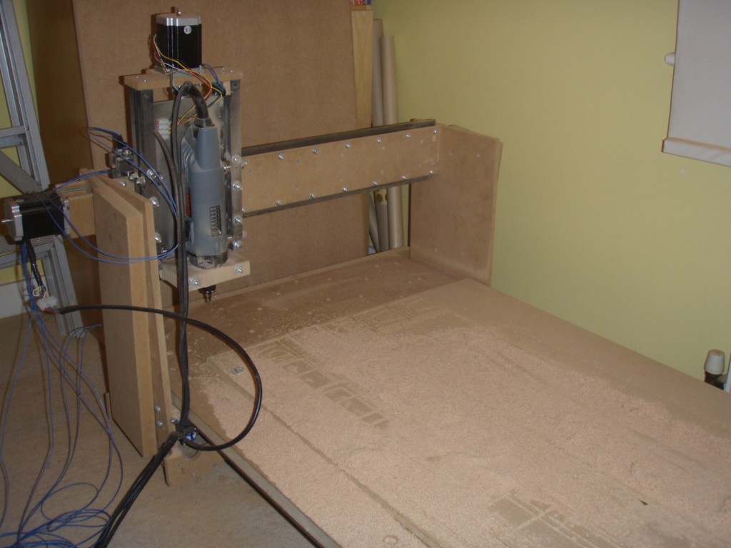

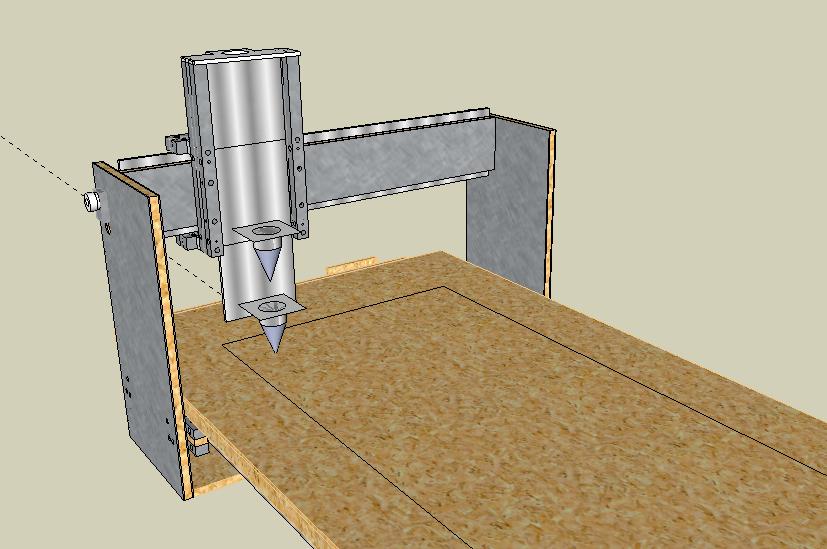

    The shakedown runs of this router are finished, and I'm growing in confidence with it.... Purely for posterity here is a before screengrab from sketchup, and an actual photo of the thing for real! (complete with deadly MDF dust)
    There are a couple of weaknesses with it so far. Some are easy to build out with some re-cut panels, which I'm in the process of doing. Others are slightly more fundamental (but happily, not too serious).
    Improvements to make:
    1) The gantry is not sufficiently strong along the Y direction. Looking at it now it's obvious! But there are no diagonals, and I'm re-cutting these before even attempting alu. If you remember, this is supposed to be an alu sandwich router, but it's going to need gantry #2 before I can cut the alu for gantry #3...
    2) The X leadscrew is not perfectly straight (well actually, bent!), and combined with the poorly braced gantry leads to wavy sides (pitch of 4mm!) on the x edges of parts I cut. Hopefully the braced gantry will fix this. If not, a new screw....
    3) Some poorly placed drill-holes during the initial build means that at the moment the Z axis sits a couple of degrees away from vertical. The collet end of the router hands back under the gantry. Again, some re-cut panels (with computer aligned holes, not pencil aligned ones) will solve this.
    4) The final, slightly more thorny problem is that the Y rail support twists slightly (tucks under) in the x direction, when the router is at full Z travel down. The problem is worst in the centre of the Y travel. A fix to this would involve spacing the Y rails further apart, and re-drilling the Z carriage to accept new skate bearing positions. It's not impossible, but I will try alu skinning first, possibly followed by replacing that piece of MDF with a chunk of solid alu if that doesn't work (it's only 100mm x 700mm).
    Current max axis speeds are (so I don't forget):
    X 40mm/s, accel 80mm/s/s
    Y 100mm/s, accel 110mm/s/s
    Z 30mm/s, accel 60mm/s/s
    X and Z are conservative, put there to stop the machine shaking itself to bits with a wobbly gantry and bent screw. I hope to increase these as the improvements are added...
    A happy speed I've found for cutting MDF so far is 1800mm/min, with a 6mm 2flute mill, and 4mm of cut on each pass. This is definitely limited by the current rigidity of the machine, but onwards and upwards... Rooolll on the improvements....

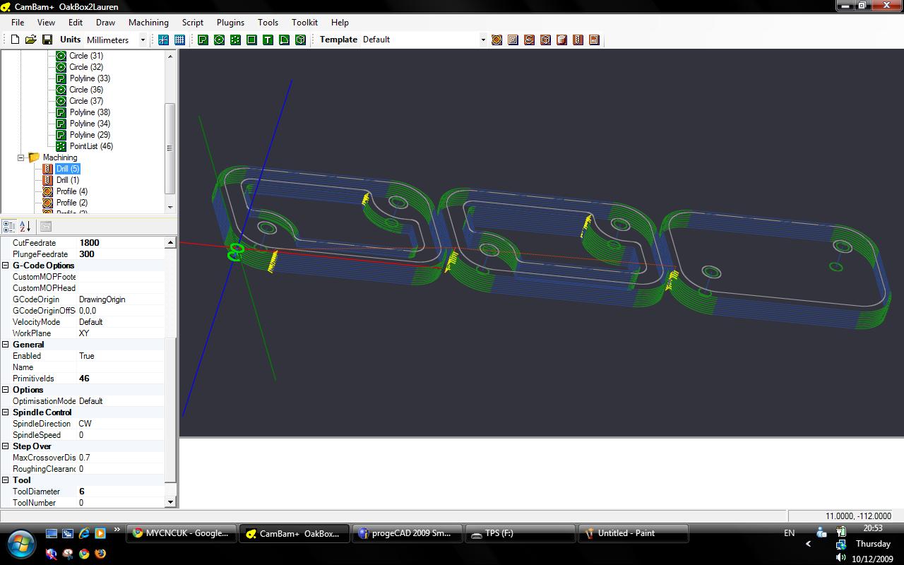

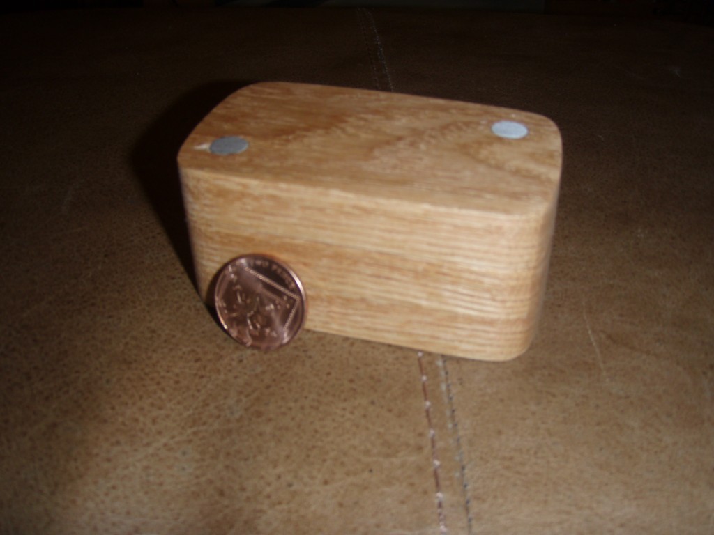

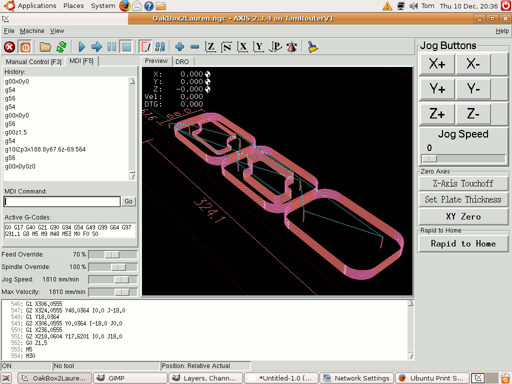

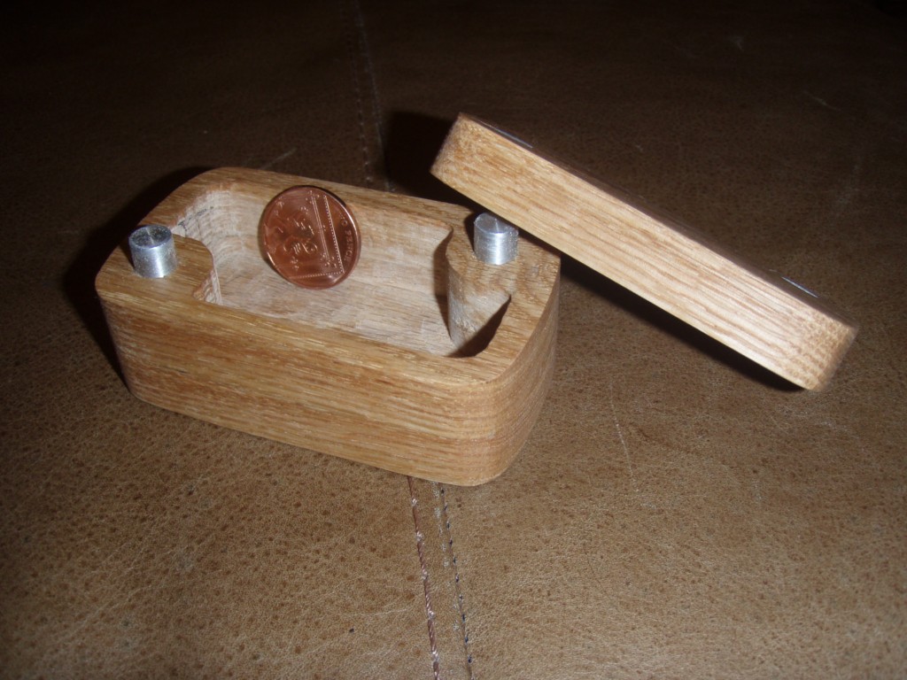

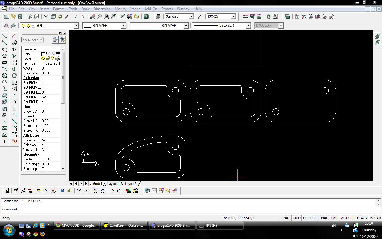

    Here's the first really pleasurable job i've done on it... This was fun, a small oak box as an xmas present...
    Pics:
    1) ProgeCad
    2) CamBam
    3) EMC2
    4&5) The finished article (too many straight lines though )
    (oh by the way, there was some belt sanding involved - unfortunately didn't come off the machine looking like that! :)

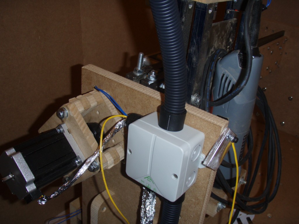

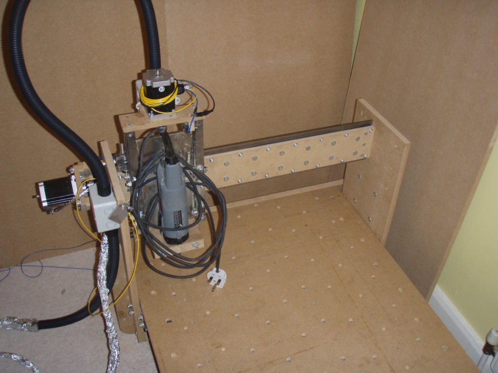

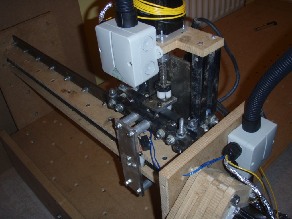

    I've spent part of this holiday getting my router into better condition. I'm surprised at how much time it takes to go from a machine that moves, to one you can walk away from during a job. I still have to pounce on the E-stop too often!
    There are some photos of the latest changes.
    Major one is that the new gantry is now fitted. This is now 18mm MDF (was 12mm), and it has bracing round the corners which improves the rigidity massively! It's fixed problems 1 to 3 in my earlier post. I think the aluminium skins are still worth adding, but that will be in a few more months when it's earned some money!
    A smaller change is that i've added flexi conduit to control the cables. This has tidied it up immensely, and is a major step towards the day when I can sit in another room with a cuppa while the machine's running! lol Unfortunately it's two steps forwards, one step back - it doesn't bl***y work any more because of electrical noise issues which keep tripping the limit inputs during a run.
    I shouldn't be surprised - the motor and signal cables are both unscreened, and they're now running in the same conduit in some places. There's some lovely screened motor cable on it's way to me now. For the screened signal cable I'm going to butcher a network cable, which is an idea I've pinched from Robin's Mill Build Log
    Lesson learned - make it bombproof from day one!
