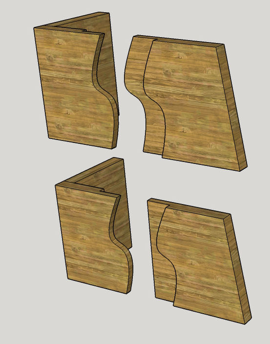

    Gerry, try this.
    Half lap

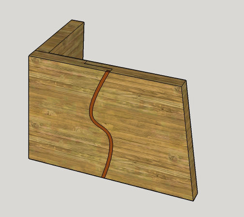

    Same joint with decorative inlay

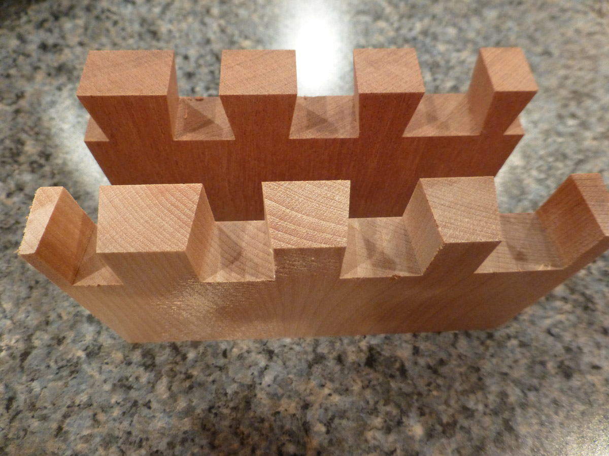

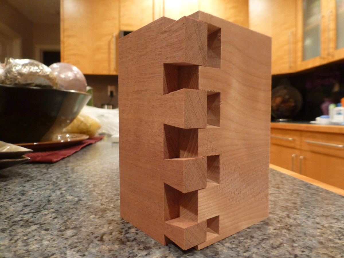

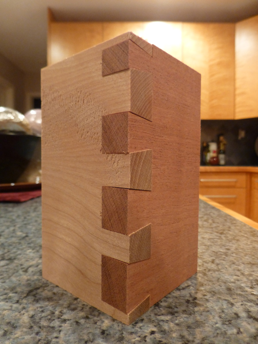

    Cutting some hardwood samples to end up as website photos. African mahogany and flamed birch.
    Very clean cuts, and very tight fit.
