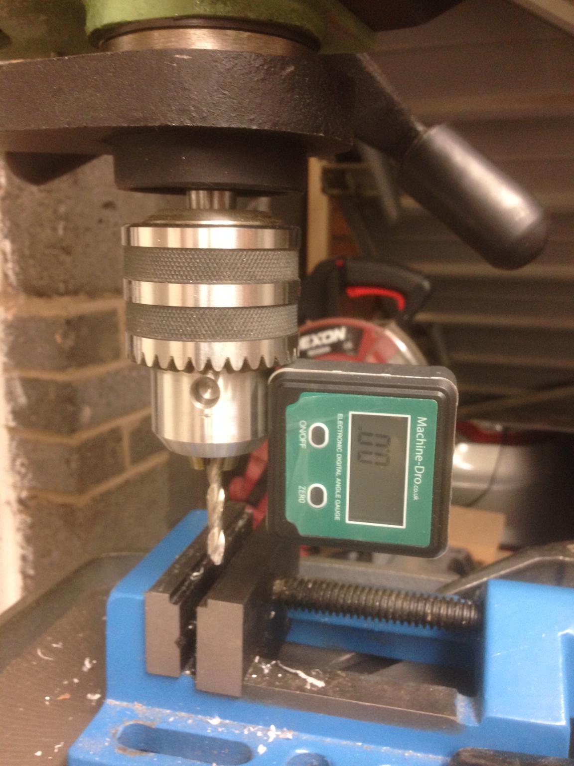

    After using the drill for a bit I noticed what appeared to be excessive run-out on the chuck. After a call to Warco they assured me the one of the reasons they sell this unit is that the chuck is good. So I measured the run-out on the arbour (chuck removed) and found it was about 0.05-0.07mm. Pretty good for a pillar drill. I then re-fitted the chuck and put a small round bar in the jaws and measured around 0.1mm, which again I was happy with. A bit confused I then rolled the drills along a flat surface and found that they were pretty bent! The drills were a brand new (but cheap) set from ArcEuro. I then chucked up my trusted 4.2mm tapping drill from Tracy Tools and switched on the drill. The tip ran true to the eye so I went on the Tracy Tools website over Christmas and ordered what I’m hoping is a quality set of drill bits.
    But even with bent drills this makes light work of drilling holes in 20mm aluminium plate.

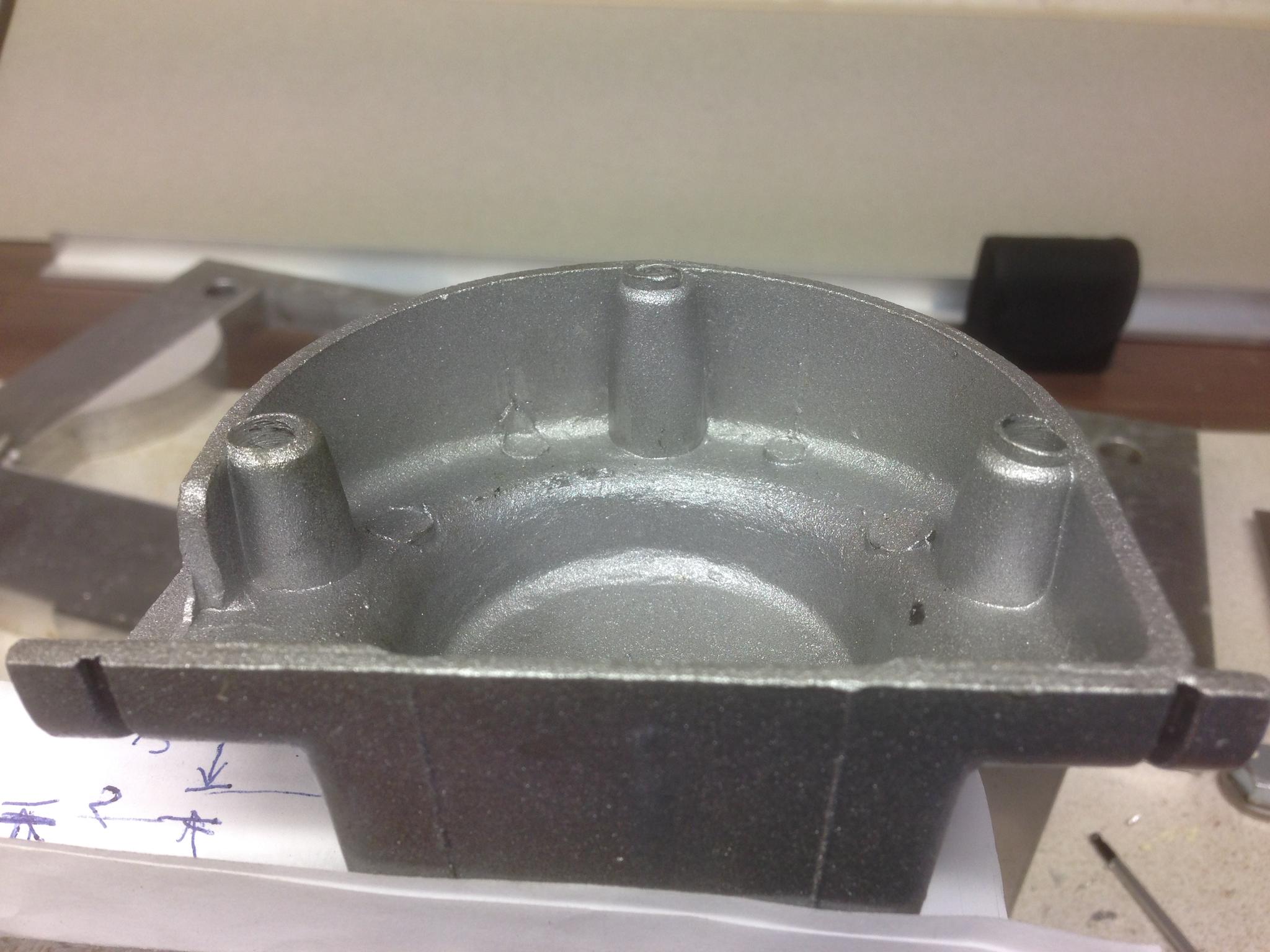

    I noticed that the casting was not great with some flash around the holes so I filled them flush:

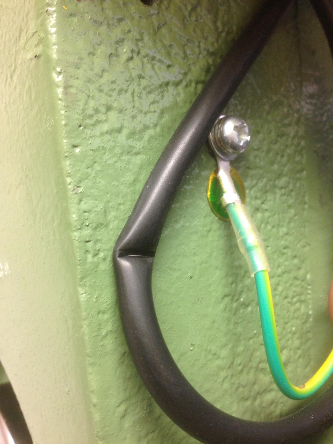

    Then I had a look behind the electrical box on the front - glad I did as one of the wires had been trapped by one of the plastic ribs:
    I re-seated it so the cable was free.

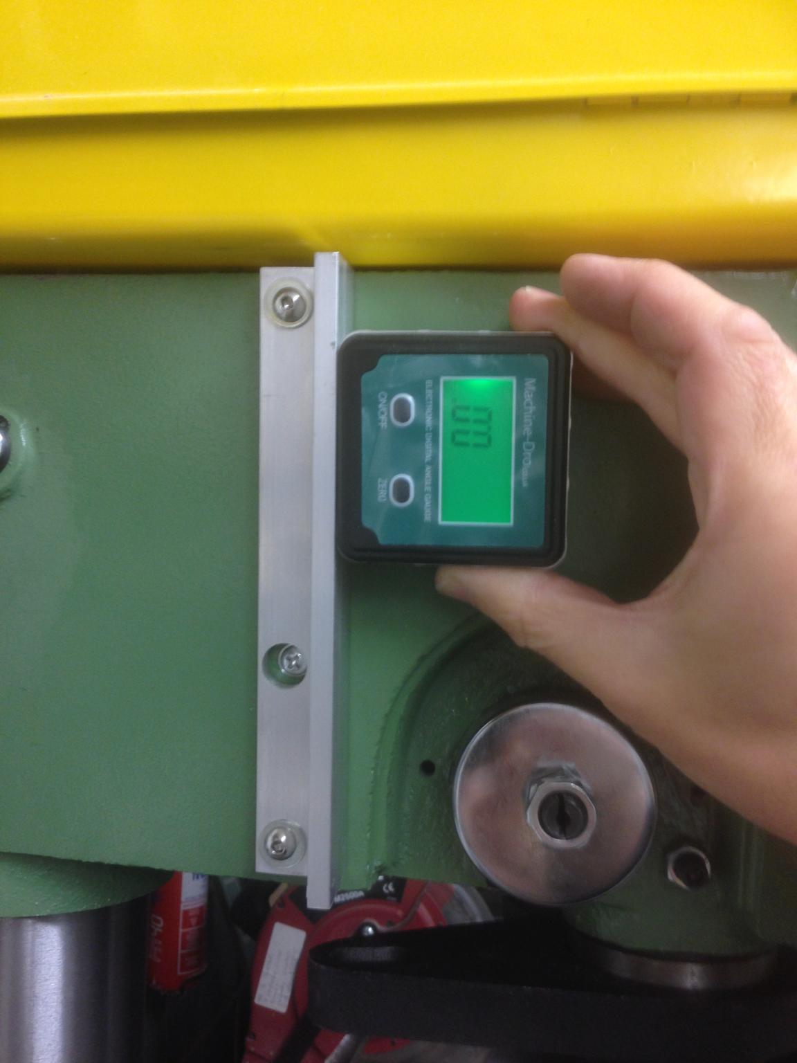

    Then I drilled and tapped the casing to take an angle bracket, then squared it up with the chuck (to try to get them parallel to each other and keep the DRO accurate):

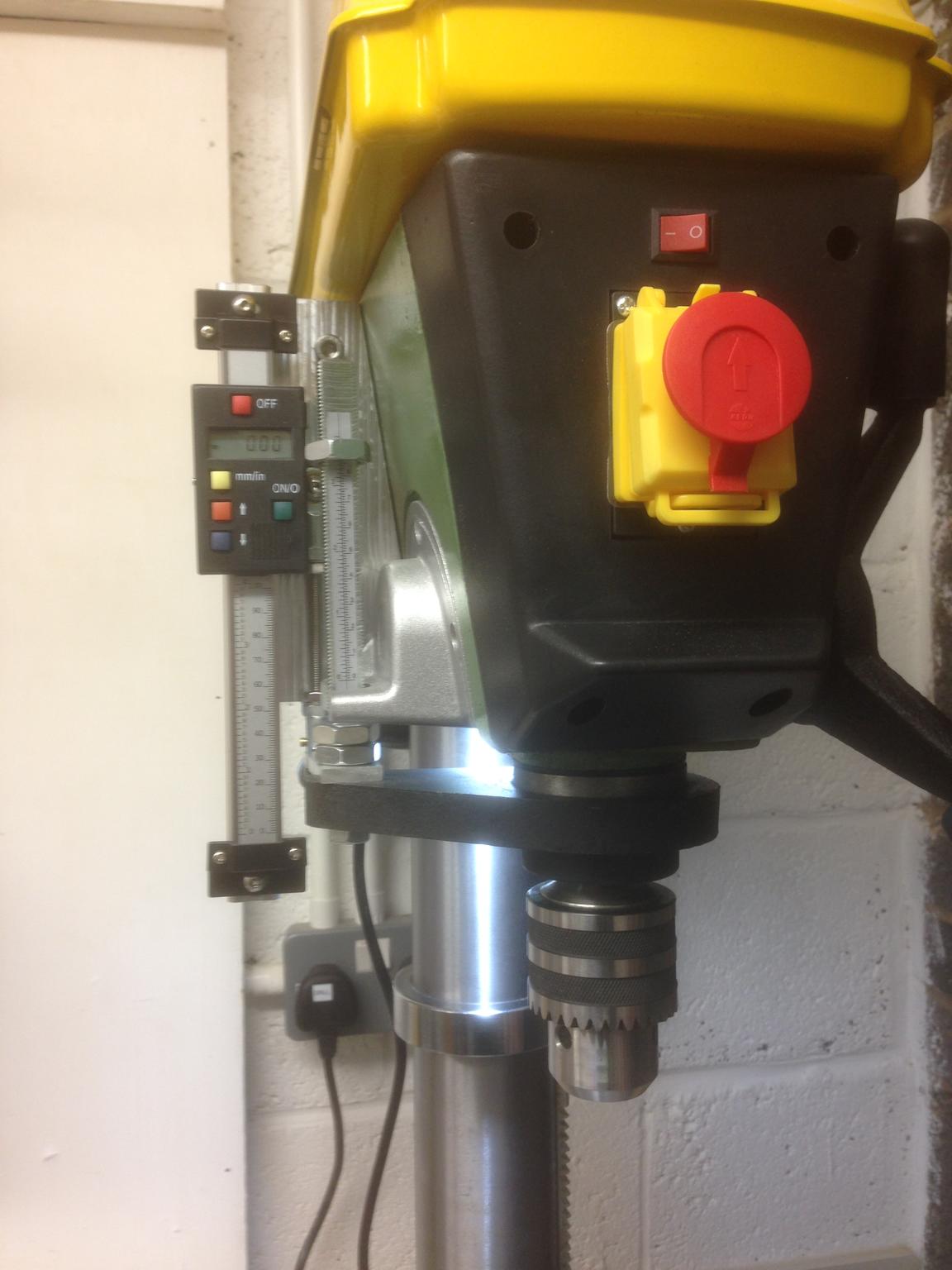

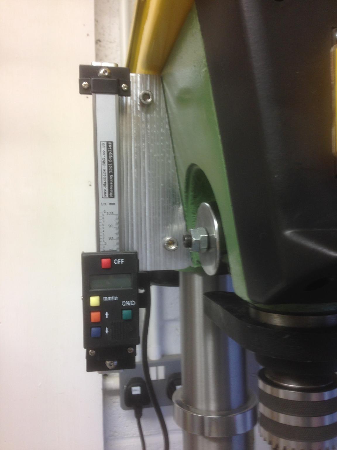

    Then I machined up a plate bracket, bolted a piece of extrusion to the plate, then mounted the DRO:

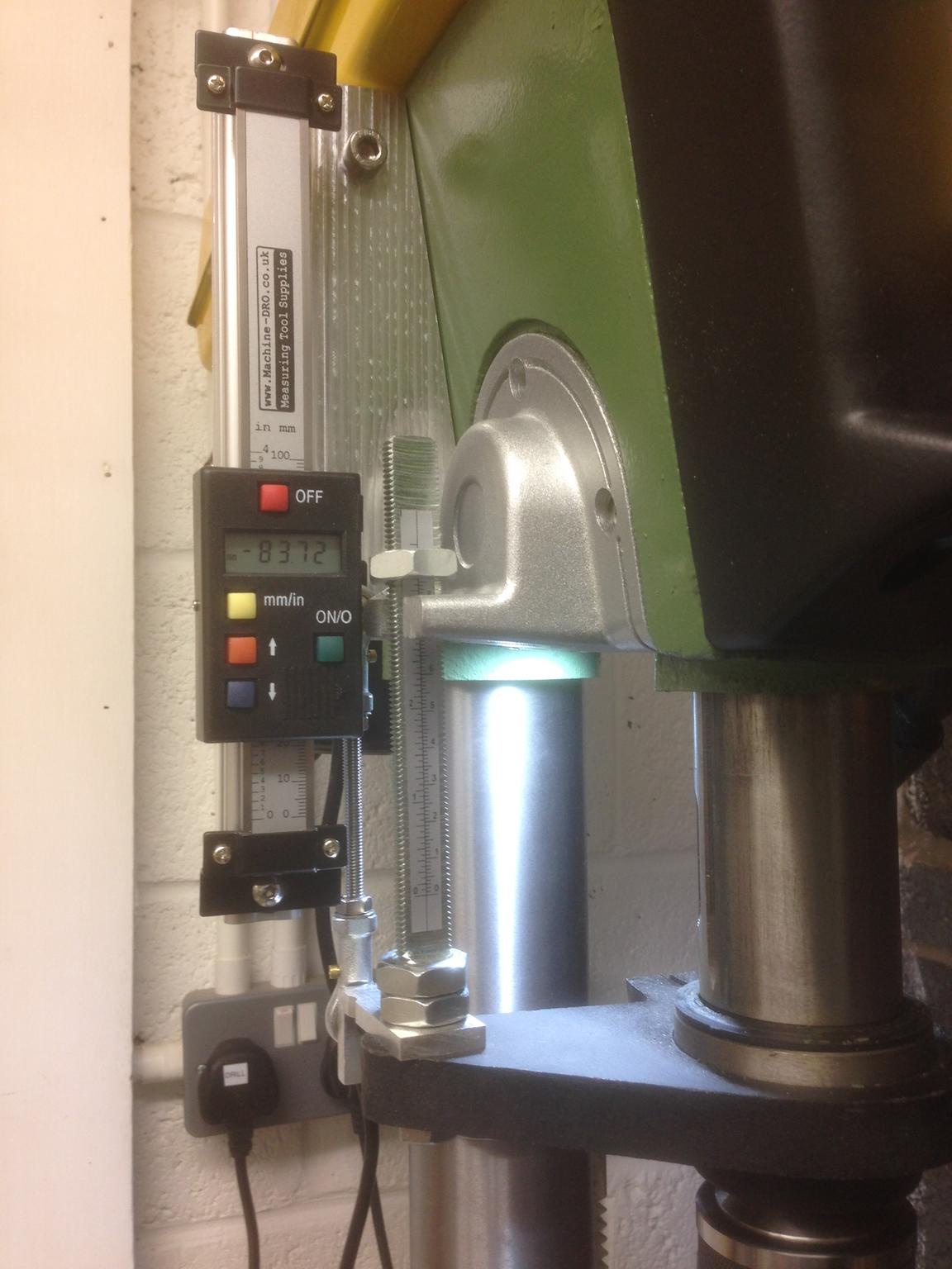

    Then I used a couple of M6 rose joints and threaded rod to join the DRO to the quill depth stop arm. This is because I couldn't be sure that the DRO would be absolutely parallel to the quill and didn't want to side load the slider. Also there is a tiny bit of play in the quill when extended which would also load the slider. Keeping the rod long minimises any error:
    Here it is fully extended:
    I had to cut a bit off the end of the spring cover / depth stop casting so it didn't hit the DRO slider.
    Works a treat - the quill can be locked off at any depth by setting the nut on the underside of the depth stop threaded rod, or a maximum depth can be set by the nut on the top side of the threaded rod. Only probably is that the DRO readout slider resonates/buzzes quite loudly when the drill is running. I'll have a look and see if there is a pre-load set screw somewhere to take out the play.

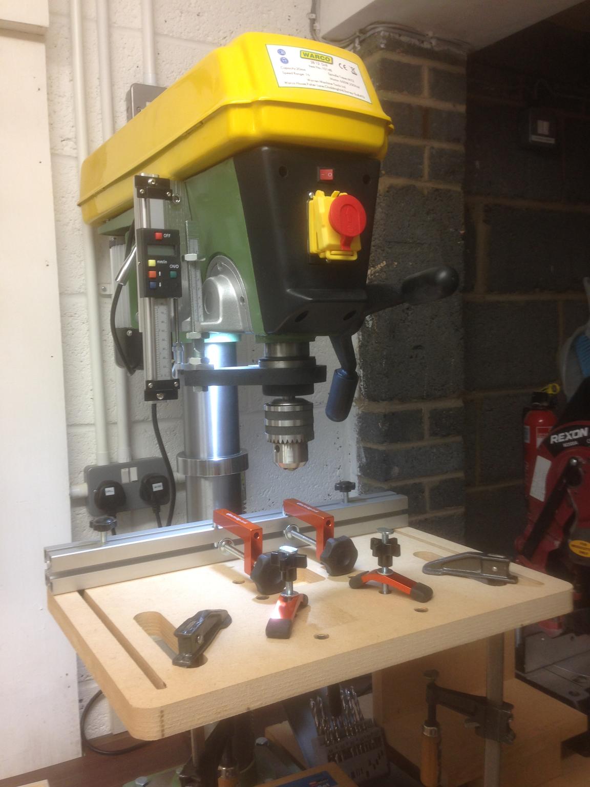

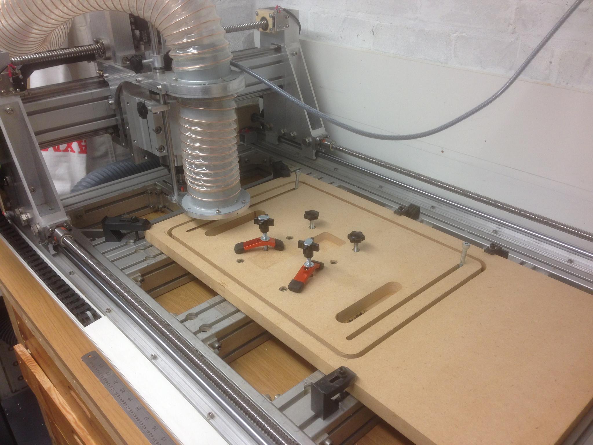

    On a related note I also managed to knock up a drill press table with fence, hold down mini-clamps, horizontal clamps, and G-clamp options, plus there will be a production-stop on the fence for repeat jobs. Centre pocket is to take a 60x60x18 mini spoil board which can be replaced when it is full of holes.
    Here it is being machined, then some of the bits trial fitted:
    And here it is with a trial fit on the drill press (still need to add bracket to the underside to hold it onto the table):

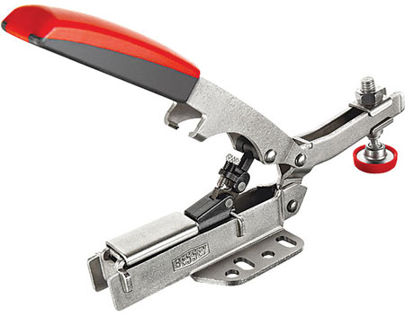

    Got one of these Bessey clamps on order - it will sit on a wooden batton and be adjustable fore/aft:
    Plus thinking about adding a pair of drill press vices which sit either side of the chuck centre - makes it easy to drill angle plate, or hold long thin parts on edge. Again the pair of vices would be mounted on a wooden batton which can then adjust fore/aft.
    Should be enough clamping options there I think !

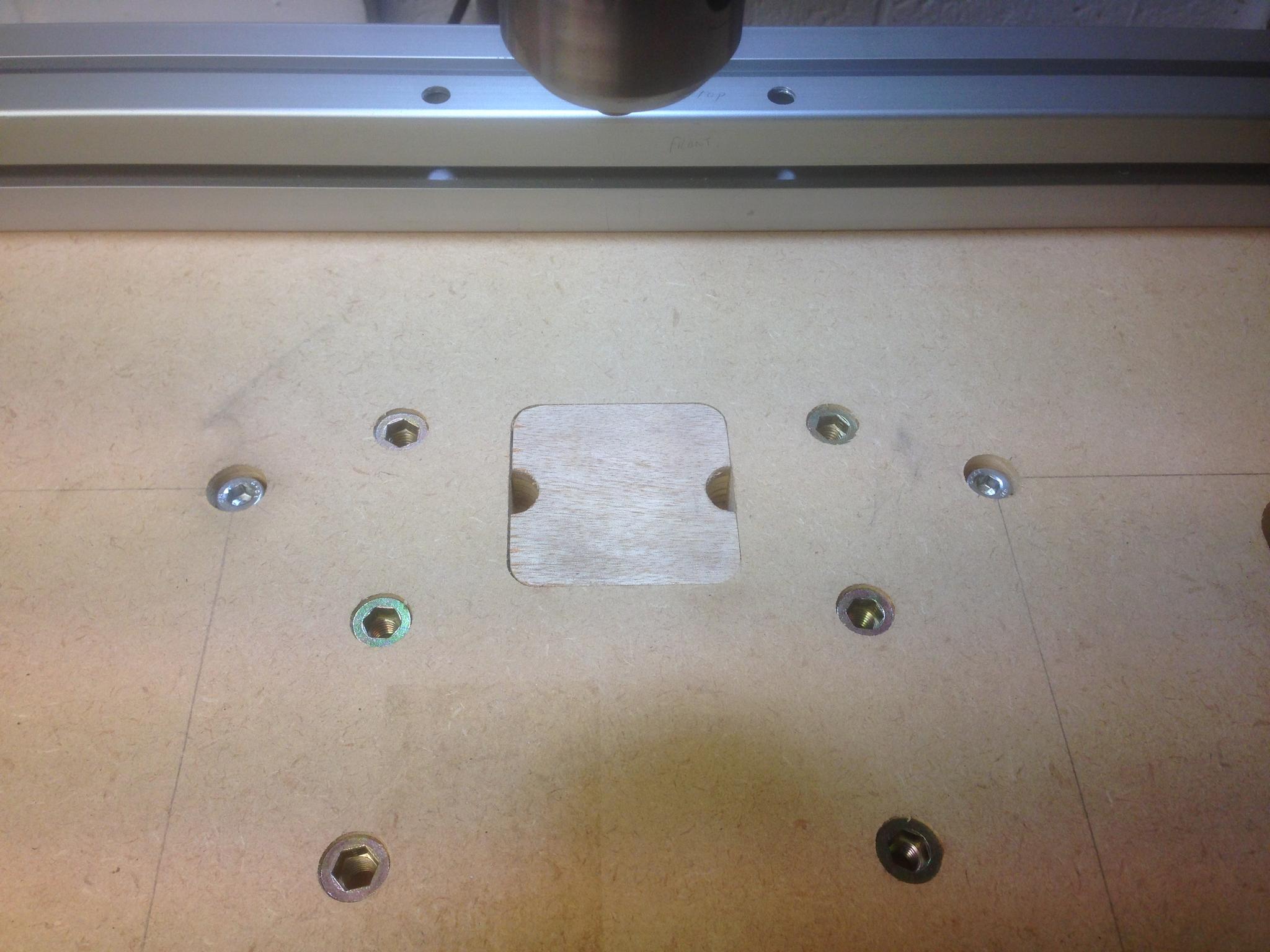

    Final bits of the drill press table finished.
    CNC machined 3off mini spoil board to go in the pocket in the middle of the table. Missed a trick here and should have offset the pocket to one side or fore/aft of the drilling point. Then you can rotate the mini spoil board around 90 degrees and get a fresh surface. Oh well.
    Here it is in position. Took a guess and made it 59.7 x 59.7 (for a 60 x 60 pocket) and it is a nice gentle fit which should stay in place:
    Then after thinking about different options I finally decided to drill and tap into the main table and just bolt it on with 2 M8 bolts. You can see them poking through on the underside. I made the holes in the wooden table a fairly tight fit on the bolts to achieve a bit of alignment when it is fitted and removed, but it's not that critical. By moving and rotating the table I was able to use the pillar drill to make these 2 holes, do the tapping (motor off), and counterboring. I used the DRO to sink each cap head exactly 10mm - very pleased with how that all works.
