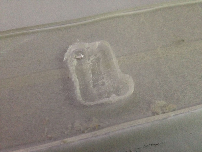

I have been trying a 6mm single flute carbide bit @ 21000 RPM 400mm Feed and 2mm depth, but the subject always gets to hot see pic:-
should i try faster feeds? slower spindle ? deeper cut ? or some form of coolant / lube ? to resolve the heat build up.
