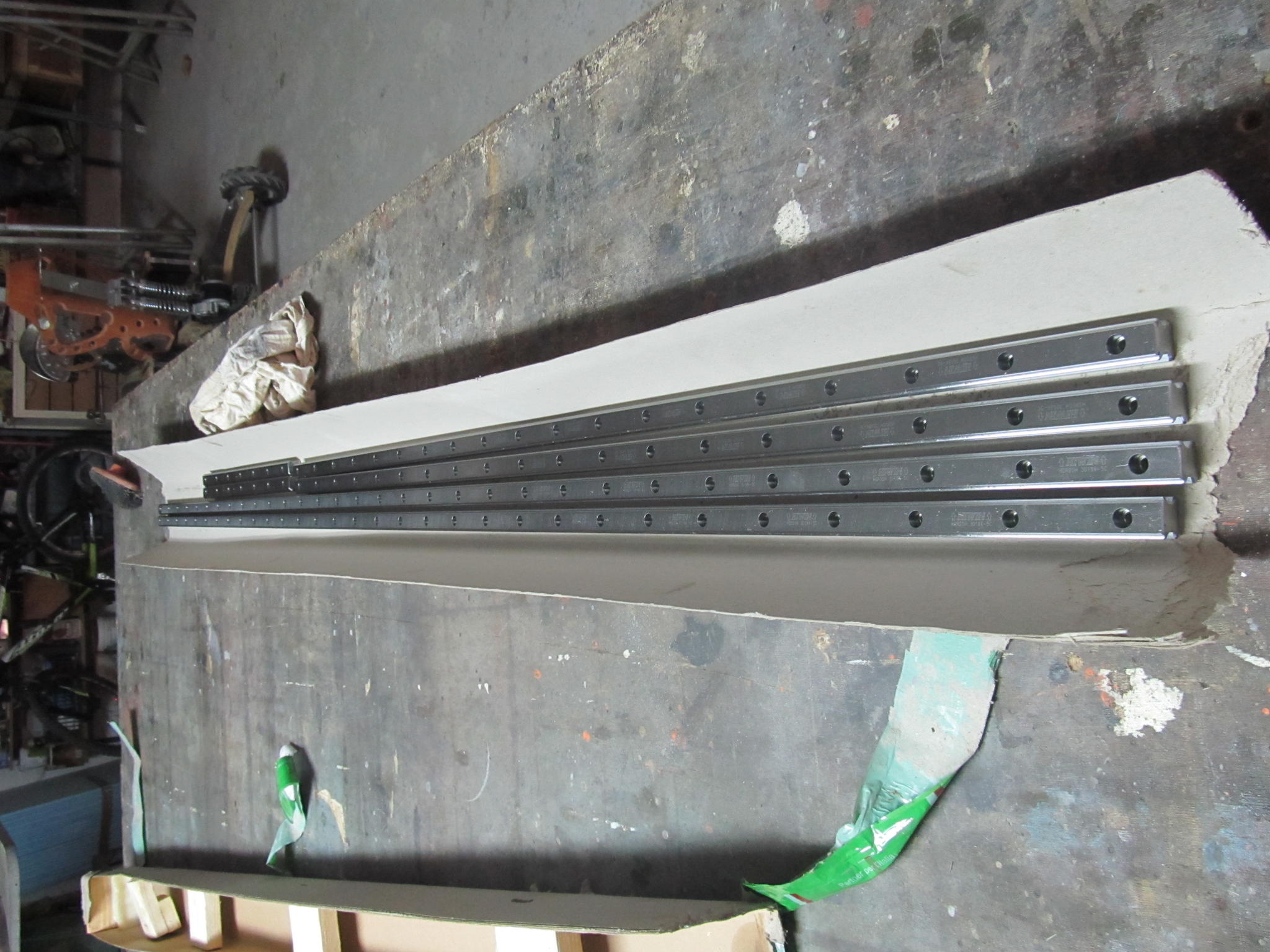

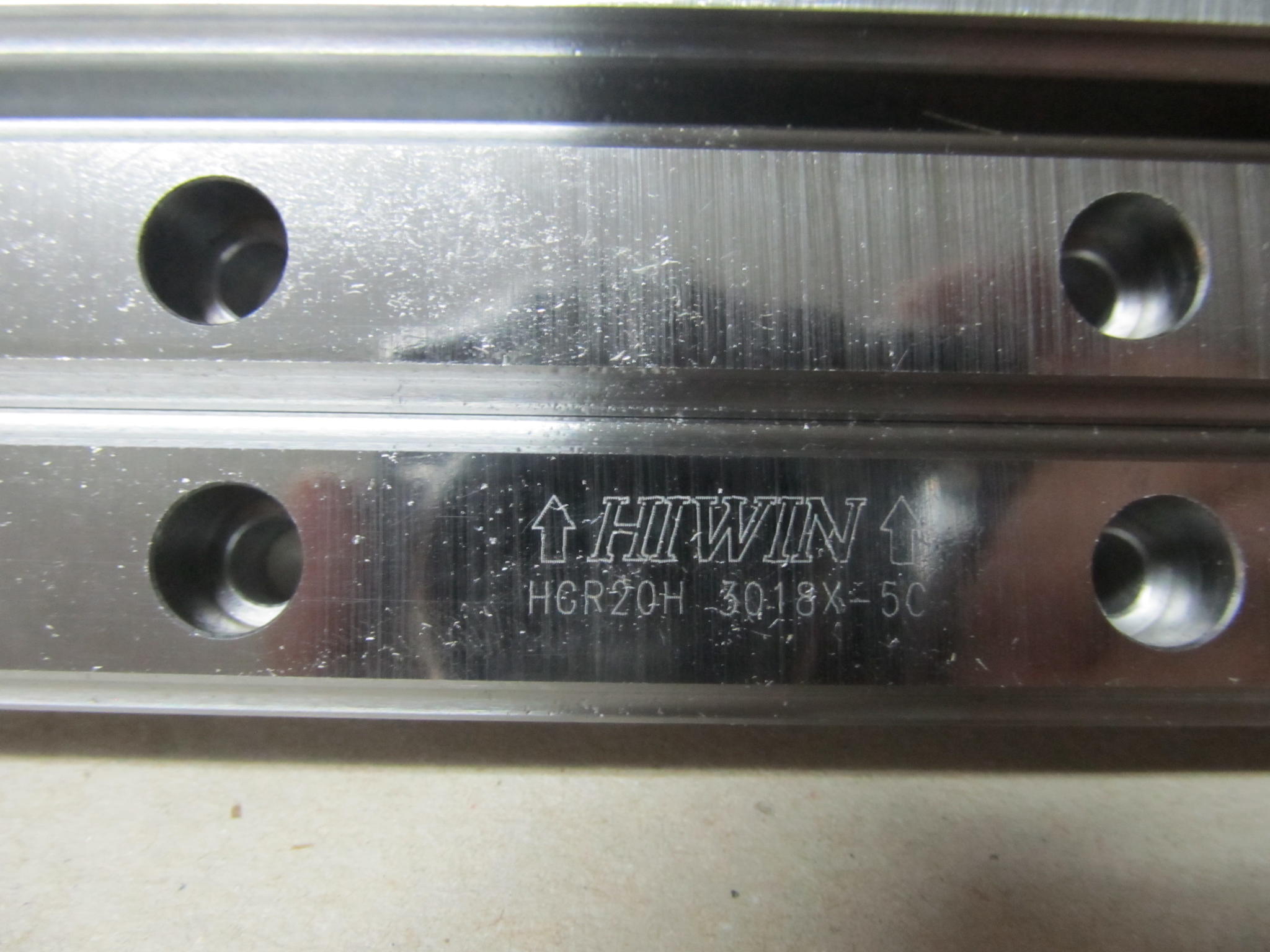

    I have another issue with my profiled rails
    On the rails i can recognize the following code HGR20H 301 8X-5c that i cant translate according the Hiwin guidway.
    HG means HG series
    R means that the rails are interchangeable( there is no master and subsidiary rail, both rails can be used the same)
    20 is the thickness of the rail
    H (that follows 20) must be the precision level of the rail I cant find out what the 301 8x-5c means. Does anybody have any idea?
    Here the photos that i took
    Thanks for your time
    Vagelis

  8. #6
    Is the length 3018mm's?
    Gerry
    UCCNC 2022 Screenset
    Mach3 2010 Screenset
  9. #7
    No this is not the real lengh
    I bought the rails with the help of friend that makes woodcrafting mahines.
    He import rails from Italy for his macines so he accept to make an order for me too.
    He told me that his provider ( of the rails ) has lengths of hiwin rails that can cut to any dimension according his customers orders.
    My rails have dimensions
    1840mm
    1080mm
    400mm
    But they all have the same laser printed logo HGR20H 301 8X-5c
    So it is possible that the provider of the rails cut the rails to the dimensions that i order from a piece that initialy was 3018mm.
    The creative adult, is the child who survived
