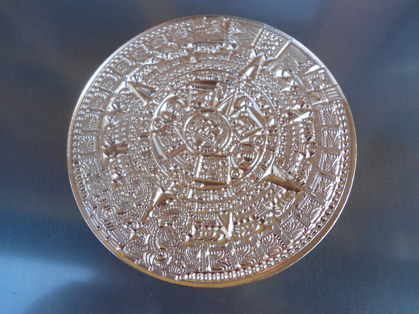

    To give an example of the kind of detail 10mm pitch will get you see my aztec calender.
    Resolution is still more than enough for cutting aluminium unless your wanting to cut very high detail, in which case your probably building the wrong design of machine anyway.!

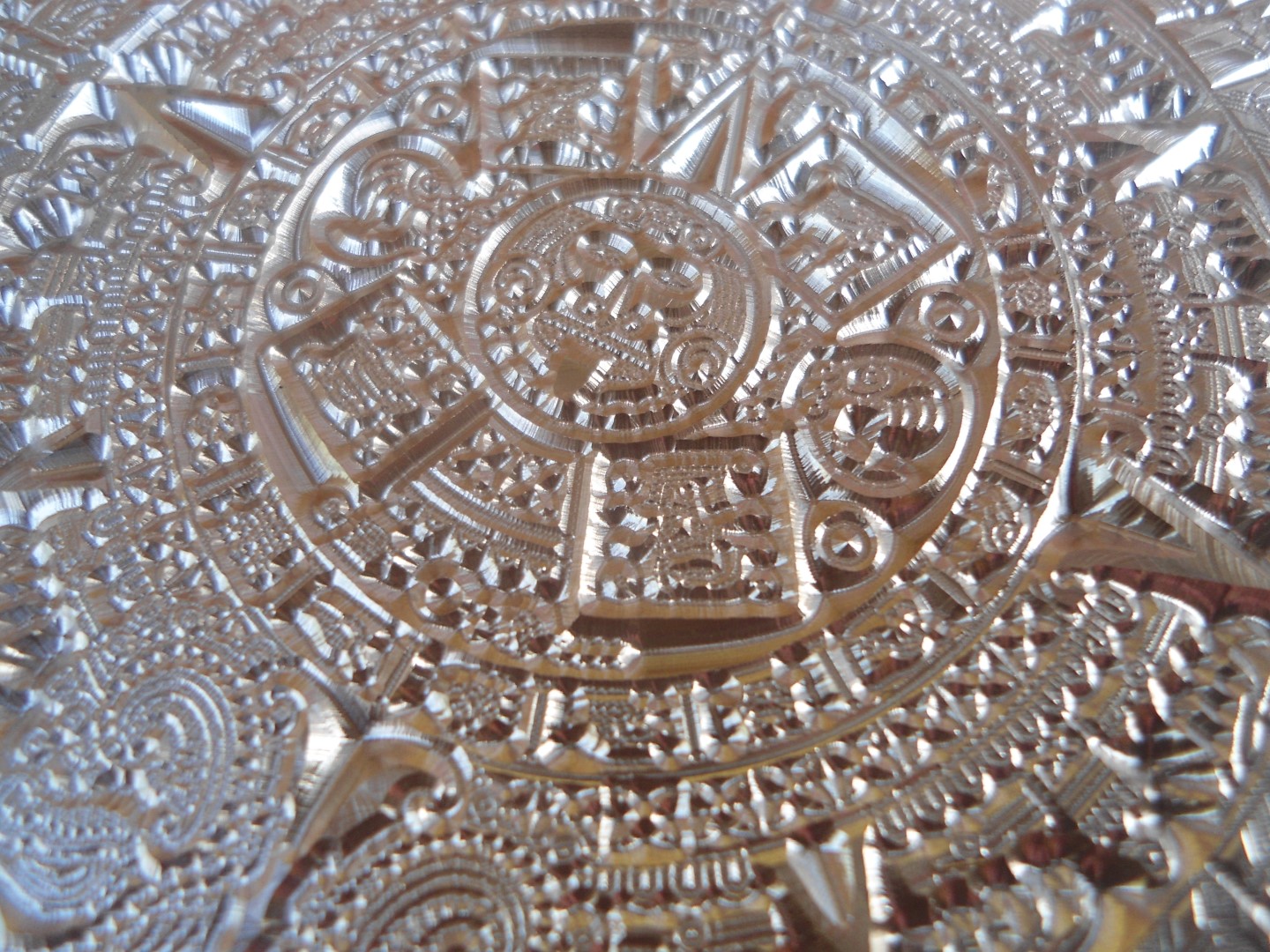

    Now try one half the size:
