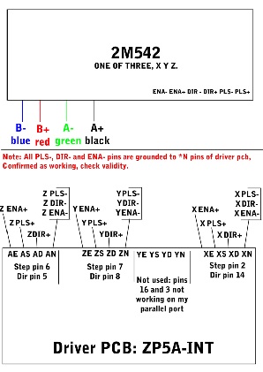

    I have some issues with wiring on my cnc and was wondering if some more experienced guys could step in. I have searched around and found a thread with similar issues but I still have a bit of a hard time wrapping my head around current source vs sink arrangement:linuxcnc.org/hardy/lucid/index.php/engli...tle-assistance/reply
    I have my cnc wired with similar hardware, ZP5A-int breakout board with 2m542 drivers. I have been running mach3 but missed steps occur often.

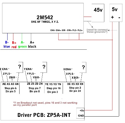

    Initially I set up my breakout to source current to the drivers as in the second image attachment and things seemed fine at first but missed steps are common so I now believe that my BOB can't source enough current to drive the driver optoisolator inputs on my 2m542 drivers correctly so want to move to current sink ( image 1) as per this thread (although i'm having difficulty wrapping my head around this arrangement)
    If anyone can shed some light I'd appreciate it.
    thanks and regards

    The drive current could be the reason for missed steps. M542 is 7mA min, 10mA typical, assuming 5v supply and 270ohm resistor as per leadshine datasheet. But the driver can only output around 3.8v so assuming a 2v LED you're actually getting something like 6mA. Having said that, you should never drive optos from a logic output, you should always sink to ground, i.e. the driver PUL+ to +v, usually an isolated 5v supply, driver PUL- to BOB output, configure as active low. The hc244d can sink 7ma nominal with 0.4v drop so a sink will drive the LED harder. you'll get nearer 8-9mA.
    Also likely your parallel port is 3.3v out and BOB is expecting 5v signals (the 'logic high' for a 244d on 5v supply is 3.15v). too much preload is stalling the motors is a distant possibility...

    Thanks Irving, just for reference then the sinking arrangement I posted is correct?
  9. Your first picture, yes... I'd try that first before making an intermediate driver.. or change the BOB for one with better output drivers...
    And don't connect motor supply and BOB supply grounds else you'll lose the isolation.

    K, so can I just leave the BOB xn (GND) unconnected, that had me confused mainly
  12. yes., assuming BOB xn(GND) and 5v GND are connected (I'd be surprised if they're not)
