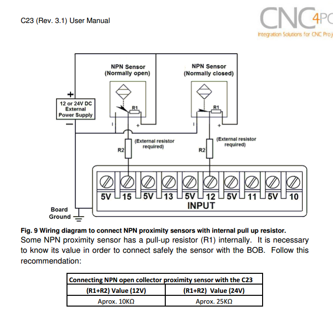

    I would need some help please with wiring correctly the proximity switches/LJ12A3-4-Z/BX Inductive Proximity Sensor Switch NPN DC6-36V/ to C23 board.
    Now i read carefully all posts about that and thought that i understand it, but maybe i am making some basic mistake.
    What i would like to achieve is all axis to have 2 switches at both ends each , one as a limit and one as a home. All limits in one pin, all homes at one pin and A home/ second long axis gantry motor/ separately, so be able to square the gantry by adjusting the switches.
    I read carefully the manual of the board with the wiring diagrams, but maybe i am missing something.
    First the manual of the board says: "Note. The bellow wiring diagrams require setting the inputs to use pull-down resistor."

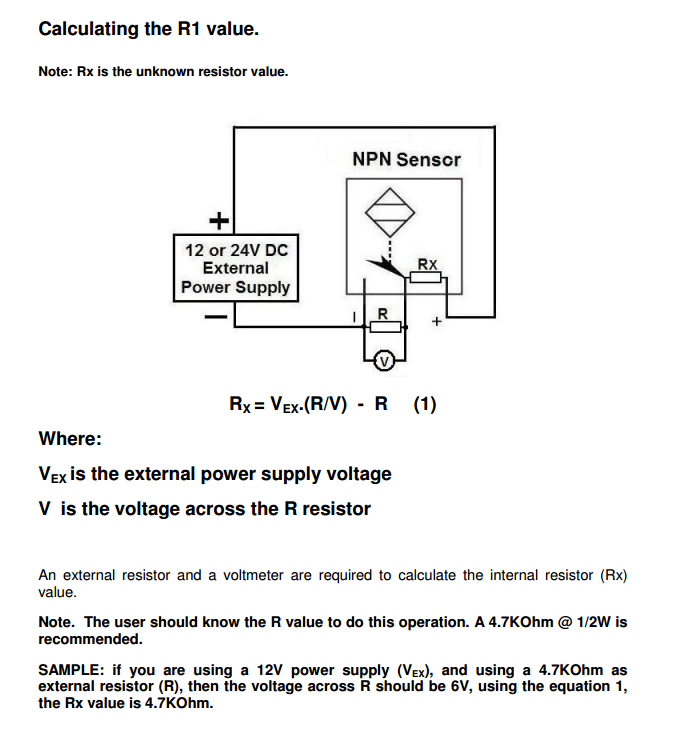

    Second the manual shows how to measure the internal resistance:
Name:	limit switches c23 2.PNG
    So i calculate its 11kOhm, so say roughly 10kOhm

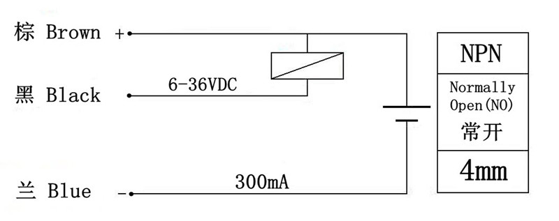

    These switches are supposed to be normally open. They have 3 wires brow blue black.
    I supply them with 18VDC + at brown -at blue. There is 18v at black, measured between black and blue. I activate the switch with metal object and black goes to 0v.
    I followed the corresponding diagram and what i read here at the forum, so wired them like this:
    All blue together , all brown together. all black limits together, all black homes together + one black home separate for the long axis squaring.
    Now the diagram says connect negative/blue/ to board ground.
    I treat 18v as 24v so i connect 10kohm resistor between the input pin and corresponding wire.
    So now inputs light but they can not detect triggering of switch. Whatever i change in mach3. I even changed the inputs of the board to high/what i read here on the forum/ but still nothing happens.
    One by one the switches work but connected together nothing happens. I searched the web but could not find something better, they all refer C23 diagram in fact.
    I am ignorant in electronics, but still wonder how this works, as when more than 1 switch blacks are connected there is always same voltage in the black measured to ground, how the board will detect something happens?
    What am i missing here?

    Some sensors have internal pull up resistors built in hence the calculation to determine it. In my case that value was 10K so no external resistor is required.
    Your PDF explains that very well. saying R1 + R2 needs to be 10K if R1 (internal) is 10K then R2 (external) is not needed.
    Hope this helps. ..Clive
