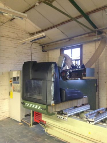

    Am mainly thinking about etching into stone, am at the planning stage so i can change were or how its going to be mounted, but i do have a large area on my Y/Z arm, plenty of hight and saftey. and if its easyer, the machine is 4500mm long, so i can anex one end.
ID:	12808 So if its possible adn feasible and makes sence, mounting a tube vertically or horizontally on the z is not a problem, neither would cooling.
    My machine quoted max speeds are
    Maximum Speed of X Axis: 2,165 IPM
    Maximum Speed of Y Axis: 1,770 IPM
    Vectoral Speed X-Y Axes: 2,796 IPM
    Maximum Speed of Z Axis: 710 IPM
    Would that be to slow ?
    Am thinking, if i can mount it direct on the Y/Z i could change tube and powerpack and focuser if i needed i higher power cut, like steel, but i dont understand if it will cause the laser tube any trouble by moving so fast.
