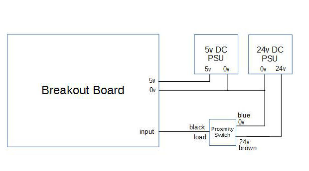

  1. Hi Ray,
    You need NPN NC switches. I'm fairly sure, but not 100% that your BOB doesn't have opto-isolated inputs (the manual is useless), but maybe someone can confirm this. Do you have a voltmeter/multi-meter? If so measure the voltage from limit switch input to ground (with power on the BOB). If its more than 2v then its probably not opto-isolated and if it 5v it probably has an internal pull up. In which case wire the switch as:
    Brown: +12 or 24v power supply
    Black: To BOB limit input
    Blue: to Ground on BOB limit input AND to Ground on 12/24v supply.

    Hi Irving, i have stated already, my BoB is only 5 volts, are you now saying i can wire a 3 wire sensor direct on to the Bob?

    Hi Eddy. I'm confused, why do i need a separate 5 volt psu, when my BoB is already putting out 5 volt. On the board there are terminals for 5 limits but only two wire each, + & -, Am i reading it wrong or what?
    Ray
    This is the drawing. You will have to make sure the 0v terminals of both power supplies are connected together otherwise it will not work. Where it shows a 24v dc PSU you could use a 12V dc PSU instead if desired.
    Colours of the proximity switch wires are for the ones I used but I think they are pretty standard.
    Because these are home switches I was not overly concerned about N/O, N/C, so for example mine are 'off' and 'open' until they are activated whereupon they are 'on' and 'closed'. If you get yours wired up and they operate the wrong way you thought they would you can just 'invert' their operation in the software.
    Attachment 12831

    I think you mentioned previously that proximity switches work on detecting ferrous metal, which is true, but mine also work on ali and brass. The ones I use are 4mm axial detection, but I use them in bypass mode, where the detection position is not necessarily 4mm, but it is consistent. In axial mode you have a great danger of jogging onto the switch and crushing the end, which kills it. (That is why I have the spares, bought as a lot of 8 from china.)
    To Ray:- You have to regard a proximity switch as an off/on (ie normally open) push button switch, but it needs 6 to 36v to make it work. The ground connection is common to the switch and the electronics in there. 5v won't cause it to switch, either not at all or not reliably.
    PM me with your phone number if you want to talk it through. I have got 5 LJ12A3-4-Z/BX switches and some 12v power supplies, which are intended to be used in my next build.
    Ray
    I don't know your BOB but you have to power it from somewhere I and others are assuming it is powered from a 5V source if it is powered from 12V then you can use that to drive your sensors.
    Can you confirm what the BOB is powered from? ..Clive
