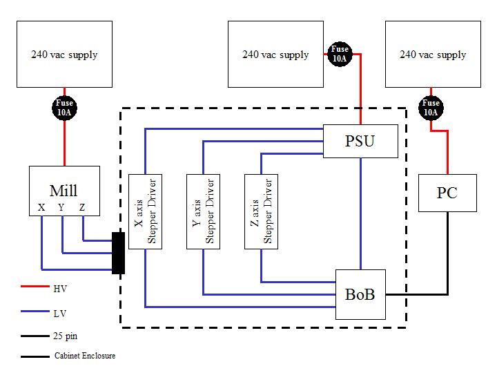

    My BoB is powered by a seperate Transformer which has a duel out put of 5 v0lt and 36 volt
    I don't know your BOB but you have to power it from somewhere I and others are assuming it is powered from a 5V source if it is powered from 12V then you can use that to drive your sensors.
    Can you confirm what the BOB is powered from? ..Clive
  2. #32
    That BoB, I believe is powered either from the USB lead or a separate 5v input. There will be a switch on the board or a jumper to select which. The BoB doesn't put 5v out AFAIK.
  3. #33
    You are correct, it is powered by a seperat Transformer, does this mean i can use sensors with higher than 5 volt?
    Ray
  4. Yes, as long as they switch to ground and don't have an internal pullup. You can check this by measuring the voltage between the black and blue wires when they are powered up. If it's always zero or there abouts then you can without any other parts. If there is volts then you need a resistor between the black wire and the Bob.

  7. Ray,
    Eddy, Jazz and myself have all said the same thing, and any supply to the switch between 10 and 36 volts will work.
    The only reason I'm being slightly pedantic and suggesting you do some basic voltage checks is to avoid any issues or disappointment. Chinese supplied products can vary in subtle ways especially stuff on ebay. That switch comes in 2 variants. One is truly just a switch to ground and that's what you need. The other version has an internal pull-up resistor to the +v supply and if it's that version then there is a chance you could damage the BOB if you don't have a resistor between switch and input. All I'm saying is do the electrical equivalent of 'measure twice, cut once' :)

    Ray,
    I got these from your earlier threads;
ID:	12837 Click image for larger version.
ID:	12838 Click image for larger version.
Name:	Control Cabinet Front Interior.jpg
    It looks like your power supply is this one;
    http://www.zappautomation.co.uk/elec...-supply-7.html
    You are using the 36v to power the steppers and the 5v to power the breakout board, you also have a 24v supply in there for the Pilz ?
    Because the 36v is used for the steppers I would suggest not using that for the proximity switches as it could contain a lot of electrical noise, instead I would use the 24v supply provided it is DC and not AC.
