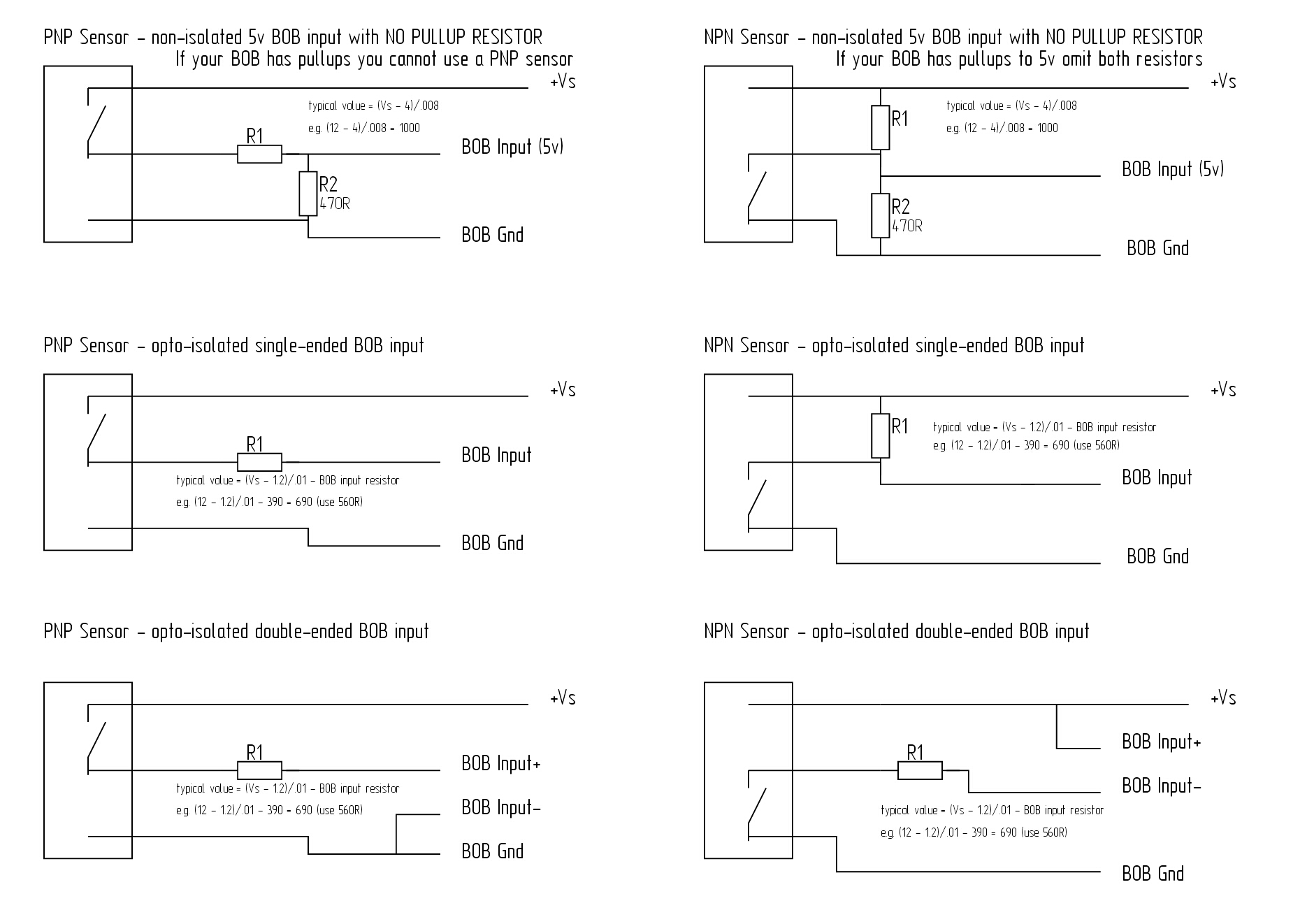

    Many thanks for the explanation, this switch seems rather small, the spec sheet says it has a gap of only 3 mm, therefore i would need a piece of metal less than 3 mm thick to go through it, would this not be a bit flimsy for a robust milling machine? and also would this switch be ok powered by my ZP5A Breakout Board, which only gives out 5 volts? and does it wire directly to the BoB?

    Albeit on a router, they work well and are very repeatable. Because they are 3 wire NPN you can power them from a 24v supply but still connect the output to your 5v bob input where they either leave it open (high) or short it to ground (low).
    The drawing here shows how they are connected; (bottom left corner of drawing)

  5. Wiring of these was discussed at length on many threads. Here is a schematic I did for one such thread showing all possible variants...
    You don't need a relay, its overkill and unnecessary if your BOB has opto-isolated inputs.

    Hi Irving, I did say i am not an electrician, how do i know if my Bob is opto isolated i have the paperwork for it but there is no mention of this? Which do i need, NPN or PNP, i'm confused.

    You really need a 12V or 24V power supply to work but they can still be connected to your BOB, power supplies are not expensive. ..Clive

    I do have both power supplies in my CNC cabinet, so can i refresh -
    I need 12 to 24 vdc proximity switches, NPN, N.C. all i need know is a scheme / Wiring diagram, can you help?
    Ray
  10. #20
    This is the drawing. You will have to make sure the 0v terminals of both power supplies are connected together otherwise it will not work. Where it shows a 24v dc PSU you could use a 12V dc PSU instead if desired.
    Colours of the proximity switch wires are for the ones I used but I think they are pretty standard.
    Because these are home switches I was not overly concerned about N/O, N/C, so for example mine are 'off' and 'open' until they are activated whereupon they are 'on' and 'closed'. If you get yours wired up and they operate the wrong way you thought they would you can just 'invert' their operation in the software.
