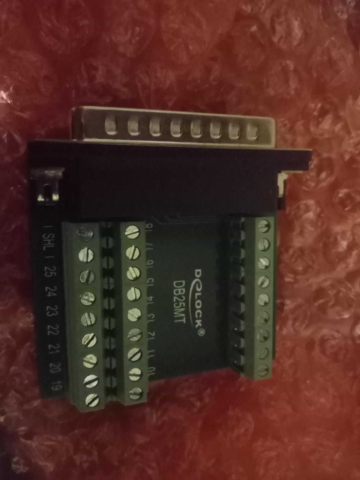

    first, hi and sorry to bring up a old post,i brought one of these and im yet to connect it up. I am a little confused as to were the step,dir enable are on this board,do i just pick which ever?

    it came with this, im guessing i connect the steppers driver through the virtual lpt thenClick image for larger version.

    That's just a DB25 terminal block. You really need a proper breakout board that offers some signal isolation to protect the controller. The breakout board will also provide a few other features like Spindle speed controller and relay.
    It's been a while since I used the PLCM-e4 so I've forgotten exactly what it provides regards input/outputs etc but think i'm correct in saying to get full use you'll need either dedicated board that offers enough I/O to make full use or will need 2 or more standard breakout boards.
    I'll see if can find the manual to refresh my memory.!
    https://purelogic.ru/data/docs/elekt..._manual_en.pdf
    link to the manual, to be honist i just wanted a all in one type board, if theis gets to confusing i might just get rid and buy a CSMIO/IP-M type
    Firstly, I'll admit to being cautious to reply - because if you have to ask the question then you clearly are less than confident with what you're doing - don't take that the wrong way.
    Jazz is mostly right - however I think you can afford to skip a few of the nice-to-haves. You can use the Port#1 outputs to directly drive your stepper drivers - the drivers pretty much all have Opto Isolated inputs, so the risk of damage is limited to getting your wiring correct in the first place. The Russian manual is shite - there's no specification for the buffered outputs but lets assume that they can source 20mA at 5V - then designate yourself the step/dir for each axis (chose just one to start with!) and configure Mach accordingly, and wire the output to the driver step+ / dir+ inputs (two, one for each) and ground the step- / dir- inputs on the driver.
    For inputs (limit switches etc) I wouldn't use the Port#1 inputs directly without a BoB, for Jazz's reason of isolation - but then the main board has 16 isolated inputs that you can use - go for them. You also have a 0-10V output for the spindle analogue input and any of 8 relays to help control the spindle & other bits. Plenty to go at. To answer your original question - yes, you have to define the mapping of step/dirs yourself to the port #1 outputs. Leave the EN's open for now on the stepper drivers.
