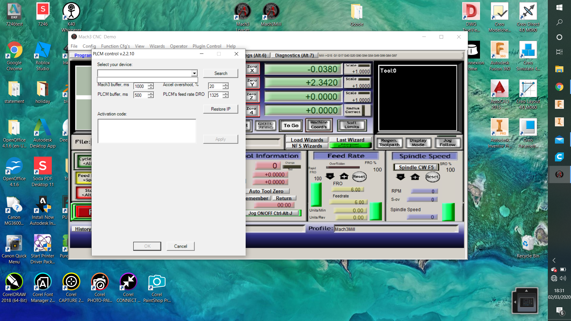

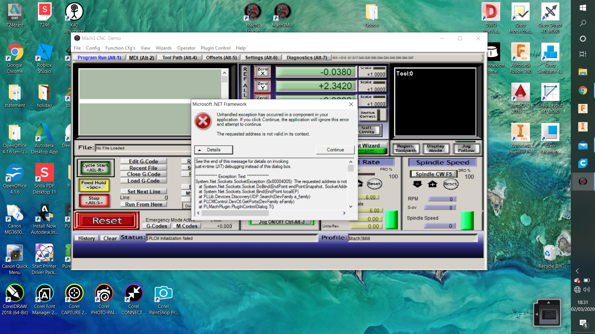

    starting to give up will connect using pure motion/pumotix but can not even get the card to show in mach3,wondering what im doing wrong i fi see a cslabs board going at a good price i think ill cut my losses. im sure this would be great if i could get it tow work
    tried ip addresses etc even turned fire wall ofClick image for larger version.

  7. Gregors,
    As far as we see, your PLCM Mach3 version is not actual.
    Please find the updated one here https://purelogic.ru/data/soft/elekt...mach3_soft.zip
    Also having a PLCM-E4 motion controller, you have an opportunity to get Pumotix software free.
    Please have a look at the thread http://www.mycncuk.com/threads/13399...x-CNC-software
  8. #17
    yup that plugin worked great, connection is now made in mach3
    ive had a look at your software and may be something ill play with in the furture for now ill tick to mach3
    just need to get the inputs like probe and limit switches of this board
