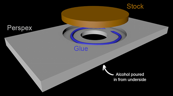

    Hole in plastic. Detail in the hole. Hot glue gun.Glue it. Wait 1 min. Do the job. Spray can filled with alcohol/rubbing or whatever/. Spray on the hard hot glue. Unglues like miracle. No traces on job or board .Thats it.
    I use mostly hot glue to hold almost anything. Double sided tape is pain in the a**s to clean. Even when i used very very thin one/ used for photo prints to fix on a support and lexan top/ it makes a mess. Especially if you have a cut through or hole, the last mm should be very slow or bit breaks in the goo.

    Do you mean like this, silyavski?
    How easy is it to ensure that the stock stays 'flat' (perpendicular to the cutter) when seating it on the glue..? The mother of pearl show-face is usually ground flat (already pretty thin) and bonded to a rough stone substrate which gets surfaced parallel to the show-face before starting the job. If there's too much of a rise in the stock once it's glued then it might be problematic... Hey, but good suggestion and worth a try for sure.
