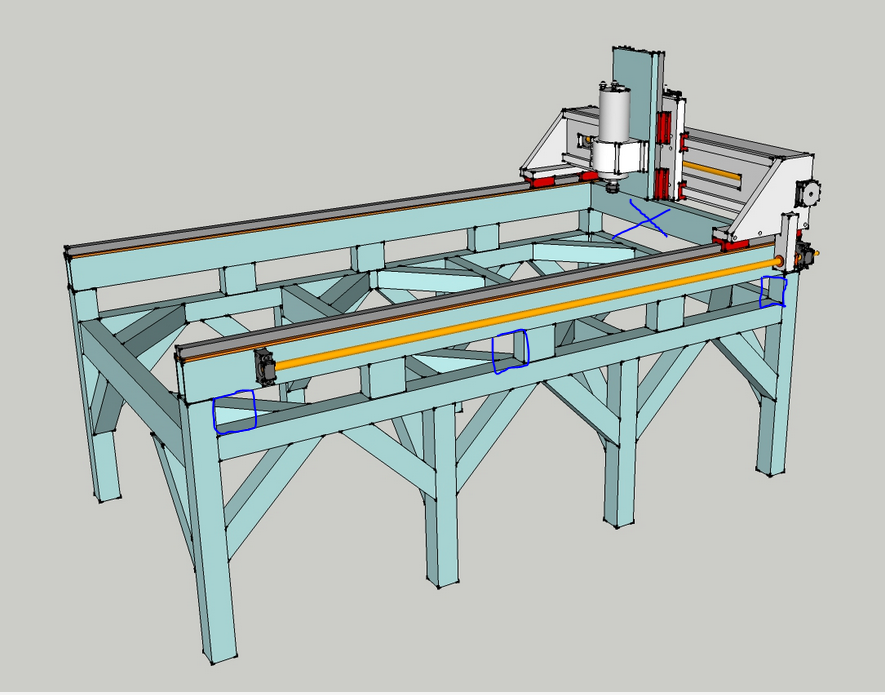

Here goes, my steel and aluminium have arrived. My mill is installed and I've had a play with my evolution saw... It's bloody loud when cutting steel but I'm really impressed with it. I feel like I need to make a new build log and close this thread off now? Just one question though, how do you lot measure your large beams (eg. 1350mm) after machining, do you just rely on your machines açcuracy, I've only got a tape measure!
I was thinking about getting a 3 axis dro for my machine but connecting the 3rd longest scale to some round rail to make a large height gauge. What do you think?
Anyway here's a couple of pics and I'll see you all in my build log when I post it :-)

Tape measure is pretty accurate, more than you might imagine ;)
Very clean, where is all the mess from cutting!?
21-09-2015 #4
Not done much cutting yet, just facing the beams so they are square and using my tape measure for measuring ;-)
