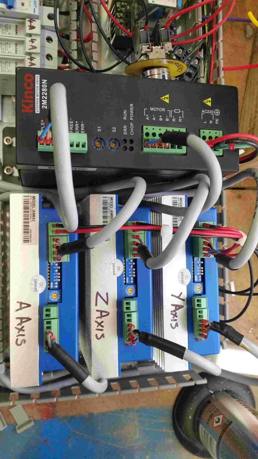

    I'm running my Nema 34 on a 230V Kinco driver and at the moment it's running on 10 m/min rapids and very happy, had it on 15 m/min and was still happy but don't need that sort of speed. I got the 40 tooth pulleys as the Nema 34 has bags of torque and I wanted as much tooth engagement as possible...
    I've not noticed any whip on change of direction...

    Neil I thought you had used 230V but when I looked at your schematic I saw three drives connected to the PS did you originally go with nema 23 all round?
  7. #87
    I've got an AM882 driver for a 4th axis as well now but did originally plan to use a Nema 23 on all axis as the calculator showed I'd be able to use it on the X axis but I decided to play it safe and go up a size.
    Neil...
    Build log...here
  8. #88
    Ah! that fooled me
  9. #89
    On the schematic it only showed the two AC wires that were going to the driver, don't think I even put a representative box on it....
    Neil...
    Build log...here
  10. #90
    I looked here but didn't notice the 230V drive. That will teach me to assume. ..Clive
