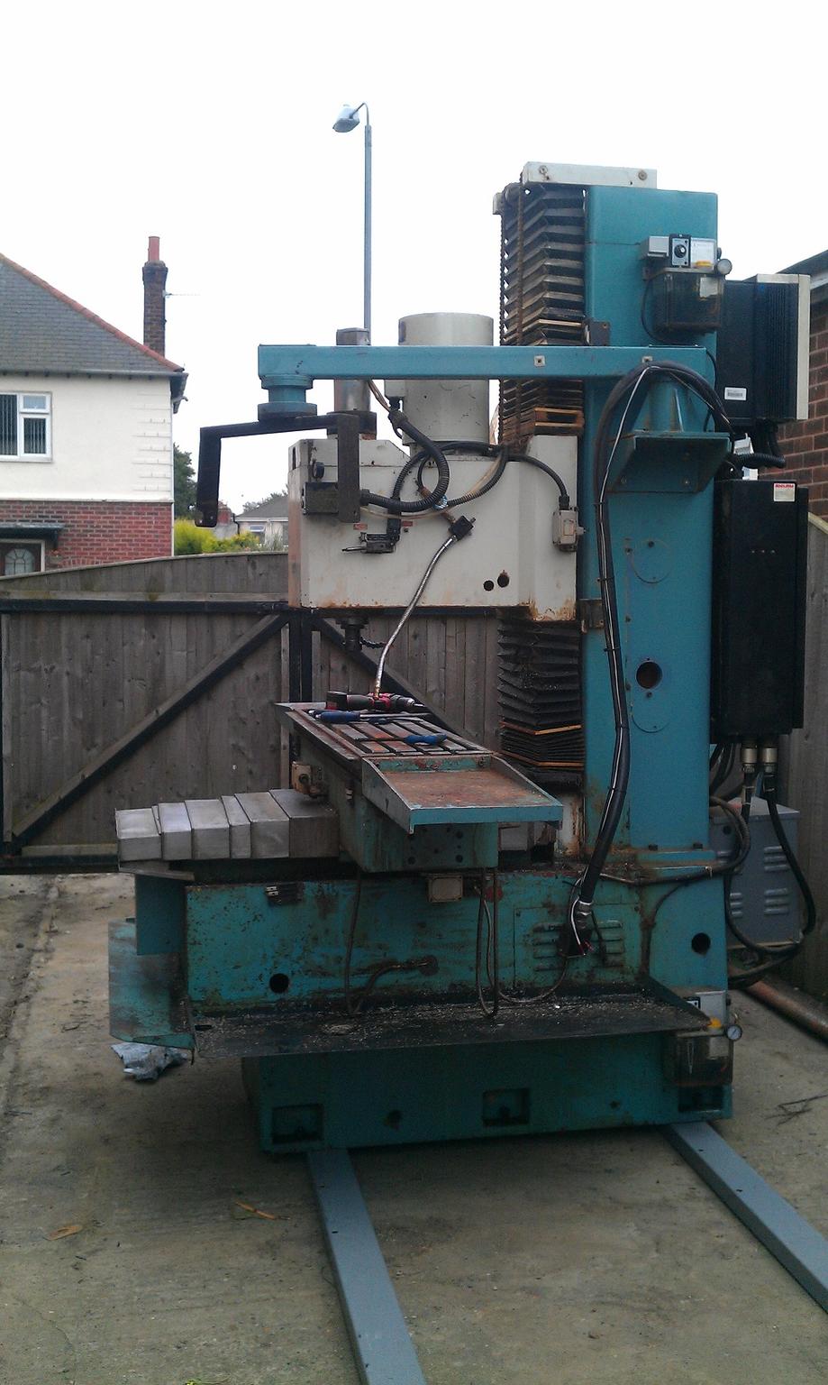

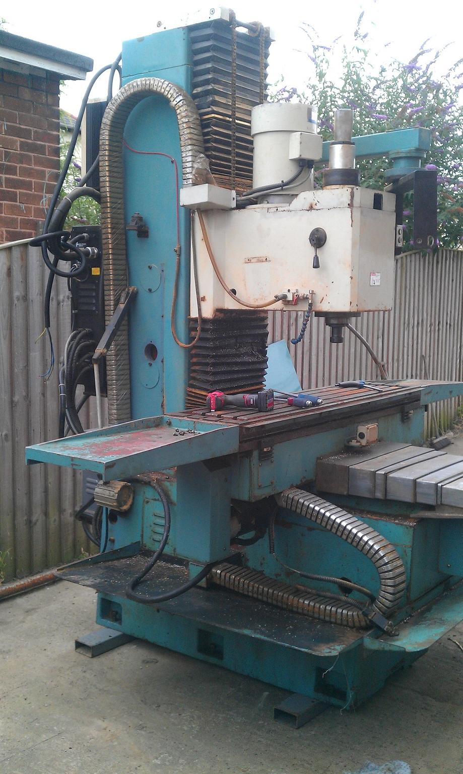

    If your going for metal then forget the moving gantry design. Go with the design above and make it massively strong. To be honest if your wanting to cut metal then I'd suggest you keep an eye out for a large Milling machine and convert to CNC or look for used or knackerd CNC VMC and convert to Mach3/Linux cnc.
    Only few weeks ago there was a Cincinnati CNC VMC on ebay for £1400 24 tool changer and full bag of tricks. At that money even if screws and rails where worn out you could convert control and replace components for same money or not much more than building a DIY machine for cutting steel.!
    To give an example I picked this CNC Mill up at scrap value. 1100 x 500 x 500 cutting area. DC servo's, 7.5Kw Cat40 spindle, Was fully working apart from needing PSU for the out dated Hindeman control which at some point around 2060 when get time I'll be replacing with Mach3 and CSlabs Analog controller. DIY isn't always the best option esp when you get into milling steels.!

  9. #49
    I see three problems with buying a mill.
    1. I couldn't say I made it myself ( big one)
    2 It's bloody huge! I would never get it in my back garden and even if I did, I wouldn't have anywhere to put it.
    3 Divorce is expensive :-)
    Cheers, Charlie
  10. #50
    Quote Originally Posted by CharlieRam View Post
    Well easy replys's to these Commnets.!!
    #1 It would be an achievement in it's self for someone new to CNC to Retrofit something like this and they could be proud if they did it.!
    #2 This should tell you everything you need to know about what's required to cut steel.!! . . . . It's nearly 3000KG and mostly cast iron.
    #3 Turned out to be the Best thing that ever happened and worth every penny(And there where many 1000's. . Lol).
