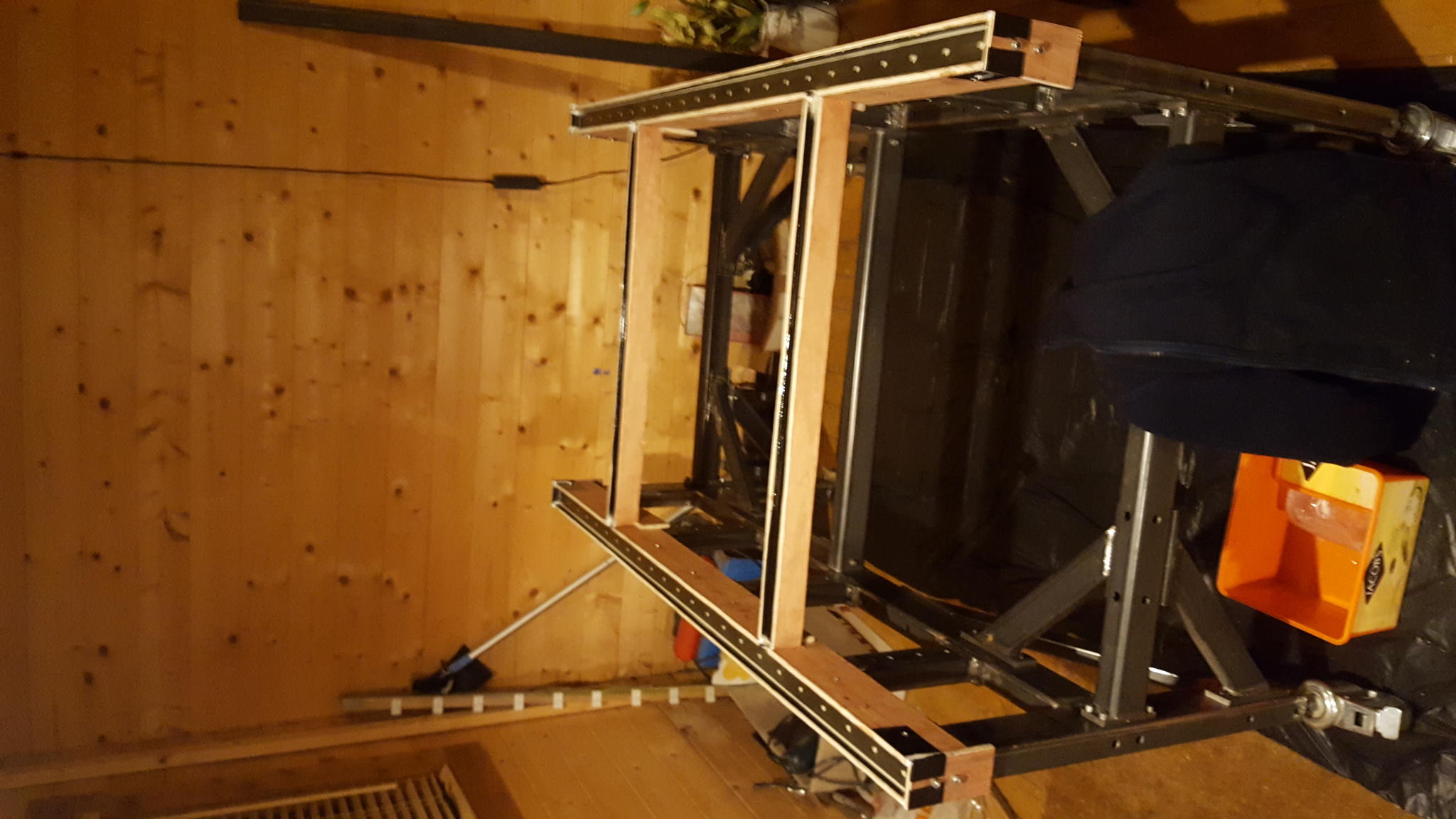

    Well.....after a very long hiatus I'm finally back on it 😁 last night I poured the resin after a week of making sure my box section was water tight........success 😁 I have noticed a couple of very tiny air bubbles but other than that it looks pretty good.

    Very nice Charlie, Just don't strip it to quick, leave it a week.

    Yeah don't worry, i'm going to leave it until Saturday/Sunday although I have had a horrible thought...I should of leveled the ballscrew mounts rather than the rails prior to pouring!! Only time will tell how close they were so its a week of waiting.

    Looking good. Reminds me of when I did mine last year - glad it’s all behind me now!
    On the ballscrew mounts if they are onto the bare metal ( the unleveled section) then you will have to shim them in later using something off the gantry or carraiges to get each end at them same height. Should be OK as you’ve done the hard bit which is getting the rail surface right.
