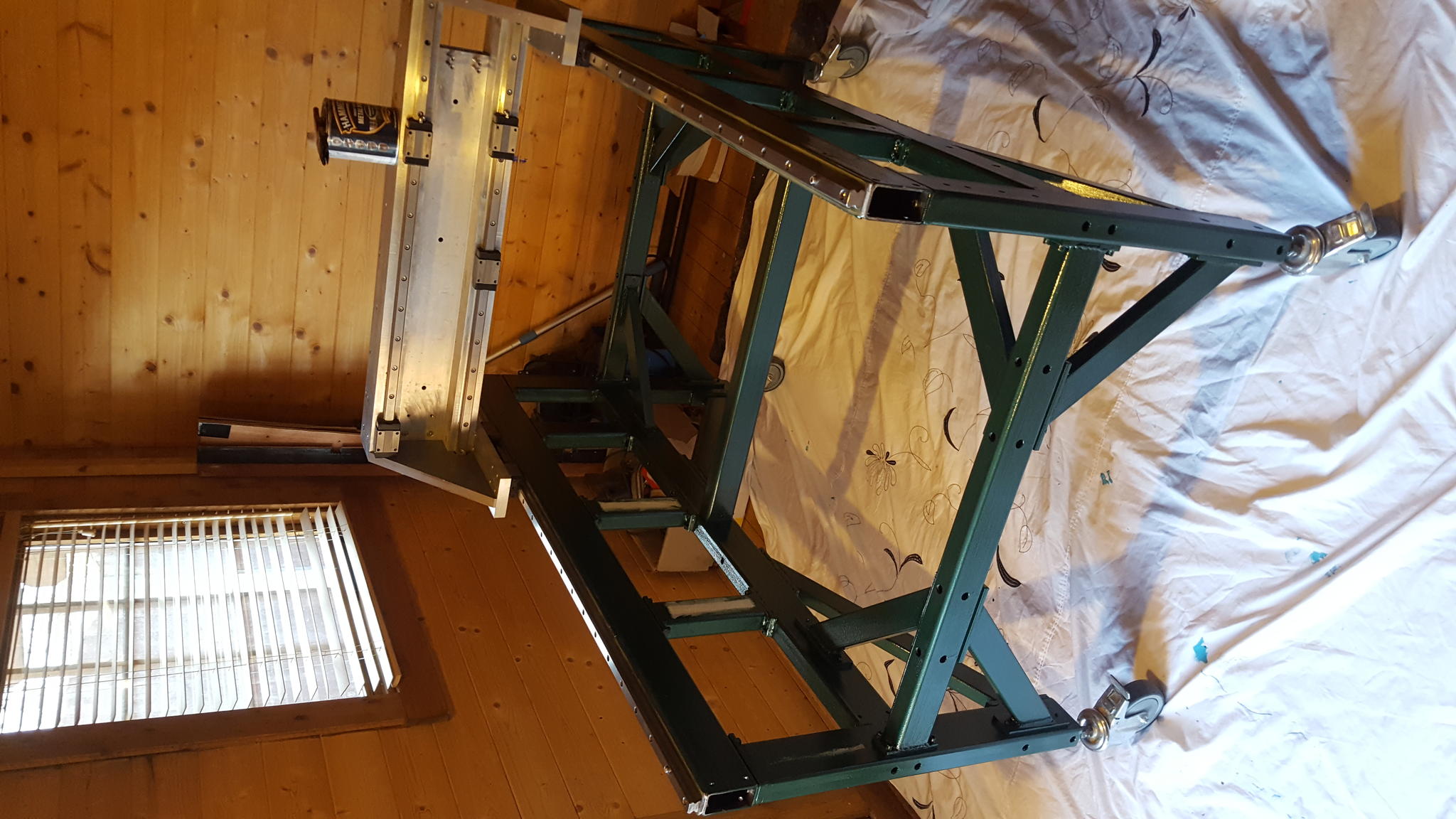

07-07-2019 #180
Well I've been busy doing the electronics and control cabinet and familiarizing myself with the AXBB motion controller, its my first one so can't compare with any others but i must say I'm impressed with it. I have completed almost all of the electronics but before I fit the motors to the machine I want to make sure the limits are fitted just in case! Is 5mm from a hard limit a good distance or do i need more? I think I may of gone a bit overkill with the cable chain too!
Sent from my SM-G920F using Tapatalk
