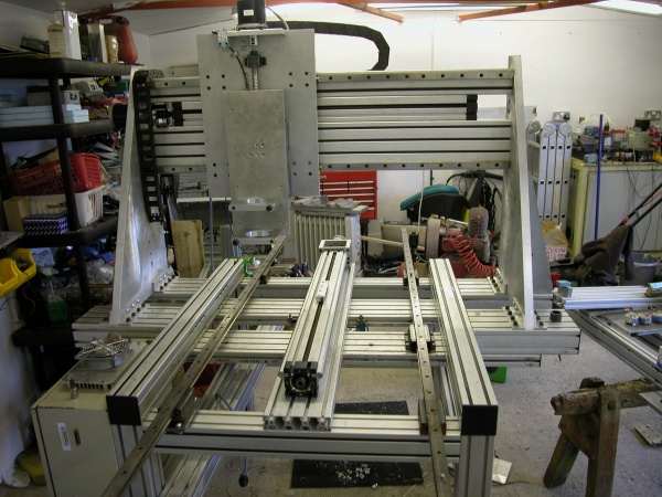

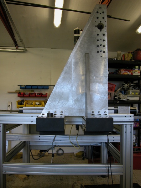

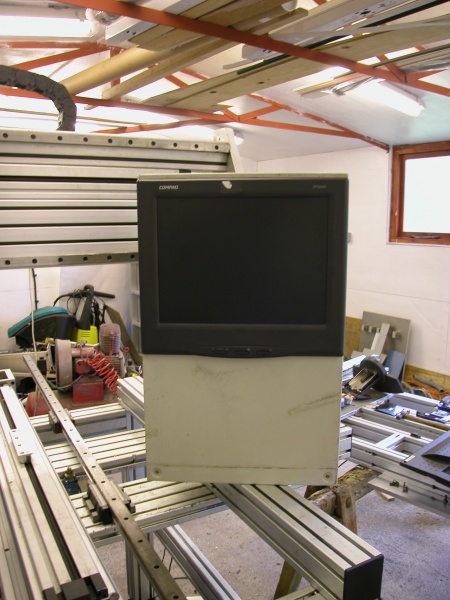

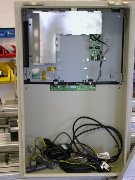

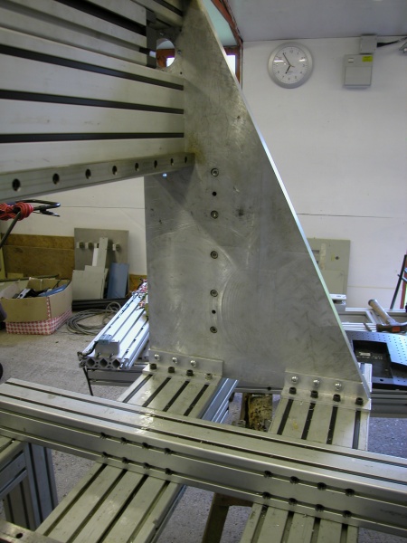

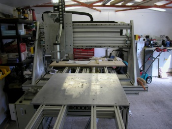

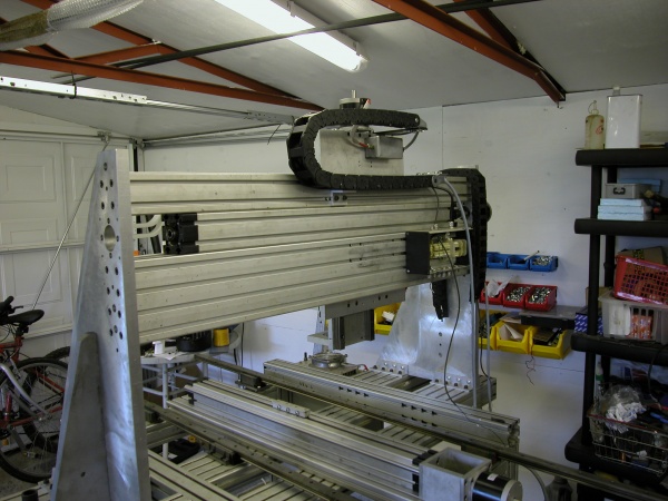

    Hi all just a quick update for anyone that might be interested.
    After running my newly built router I decided that it could do with a few tweeks.
    The first photo shows the front view of the new X axis mount plate I have removed the center bearing rail cut it down and used two pieces to join onto the other two rails to make two longer rails with two carriages on each. This has given me full travel of my ball screw so should get about 750 to 800 mm of travel.
    The second photo is a side view of the above.
    The third photo shows the bolting arrangement of the 160mm x 80mm Item section this was added to lift the gantry so the Y axis rails can be mounted on the underside of the table as opposed on the side.
    The rest of the photo's are just various views of the upgrades, the last two are of a proposed PC control cabinet, I have already mounted the 15 inch screen which was just a nice fit the space underneath the screen will be for various buttons to control Mach via Modbus.
    I will mount this to the side of the machine with some type of articulated arm so it can be positioned out of the way when not in use.
    Andy

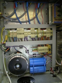

  7. #27

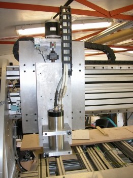

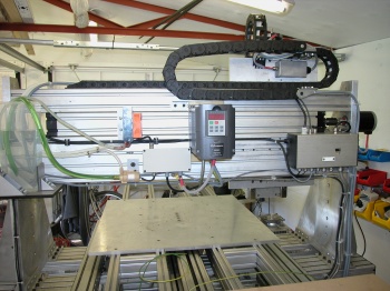

    Hi All
    Well I have had my upgraded (I think) machine running tonight,it's been a long time happening
    Some photo's just to show what I have been up to.

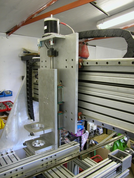

    1: Showing the new water cooled spindle mounted.
    2: A close up of the above
    3:Back view showing VHD and water cooling system(to be finished)

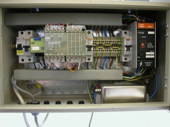

    4:The Pilz relay control enclosure with the 24v control power supply and mains filter feeding the VFD. I fitted two new e-stops both with twin contacts the pilz relay monitors both channels just some extra safety I did'nt want 3HP running a mock in my garage

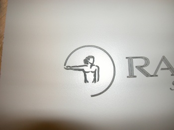

    5:View of inside the finished control panel now with a bleed resistor fitted to drain the caps this is wired through a normaly closed pair of contacts on the Pilz safety relay.
    6: Some engraving I did tonight just to try it out, which I was fairly pleased with.
    I still have things to finish but at least I'm up and running again
    I will try and upload the video I took of the machine running tomorrow.

  9. #28
    That's neat wiring, nice job.
    John S -
